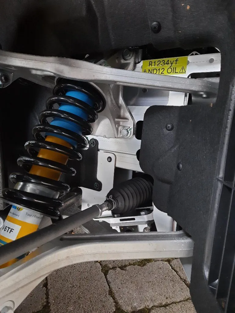

Good Evening,
how can I see the differenz at the Emira, which Suspension i have? Do you have photos?
Kind regards Peter
Good Evening,
Kind regards Peter
The springs and shocks should both say Sport or Tour if you can get down there close enough to check!
Bottom of the shock absorber on the silver label
