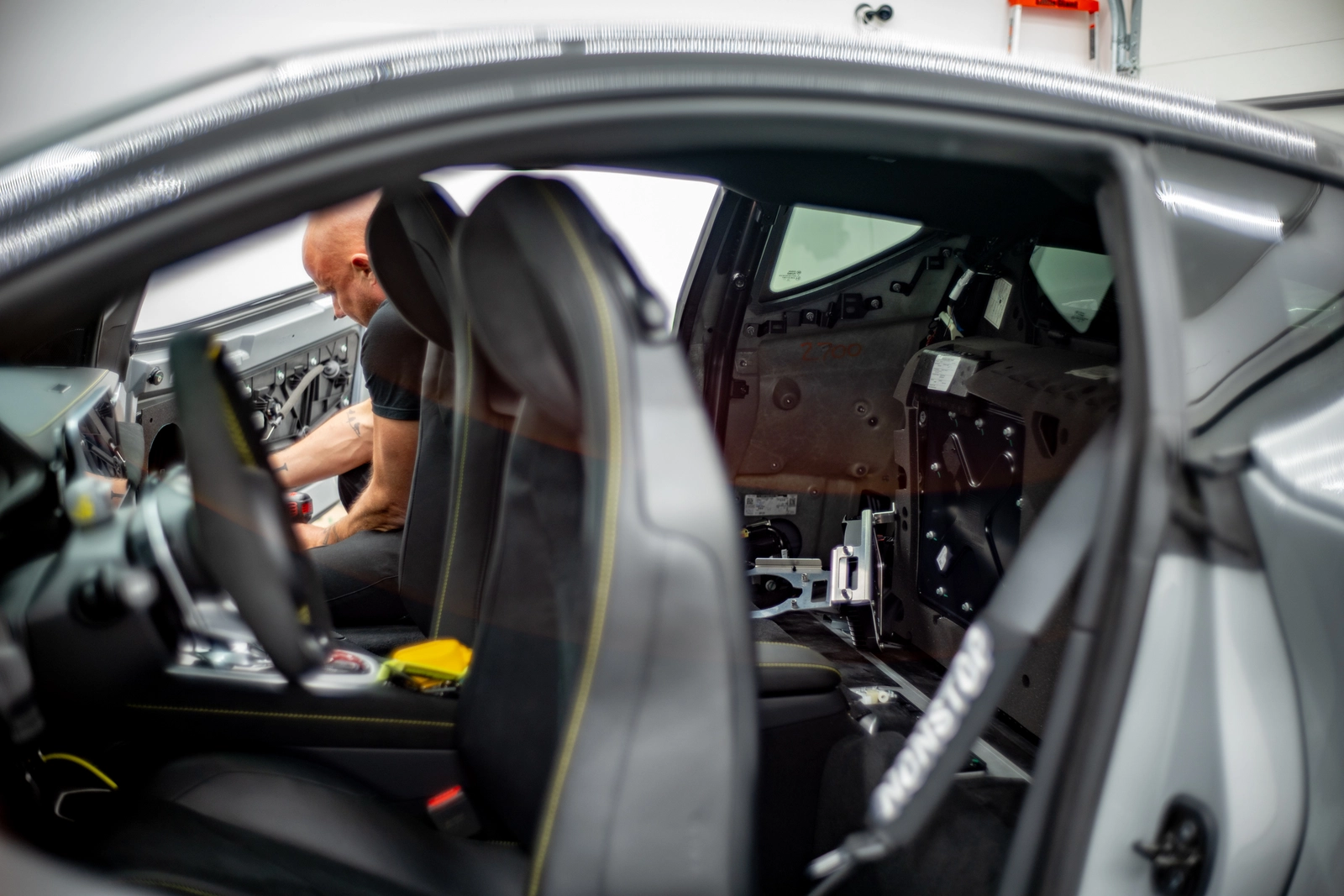

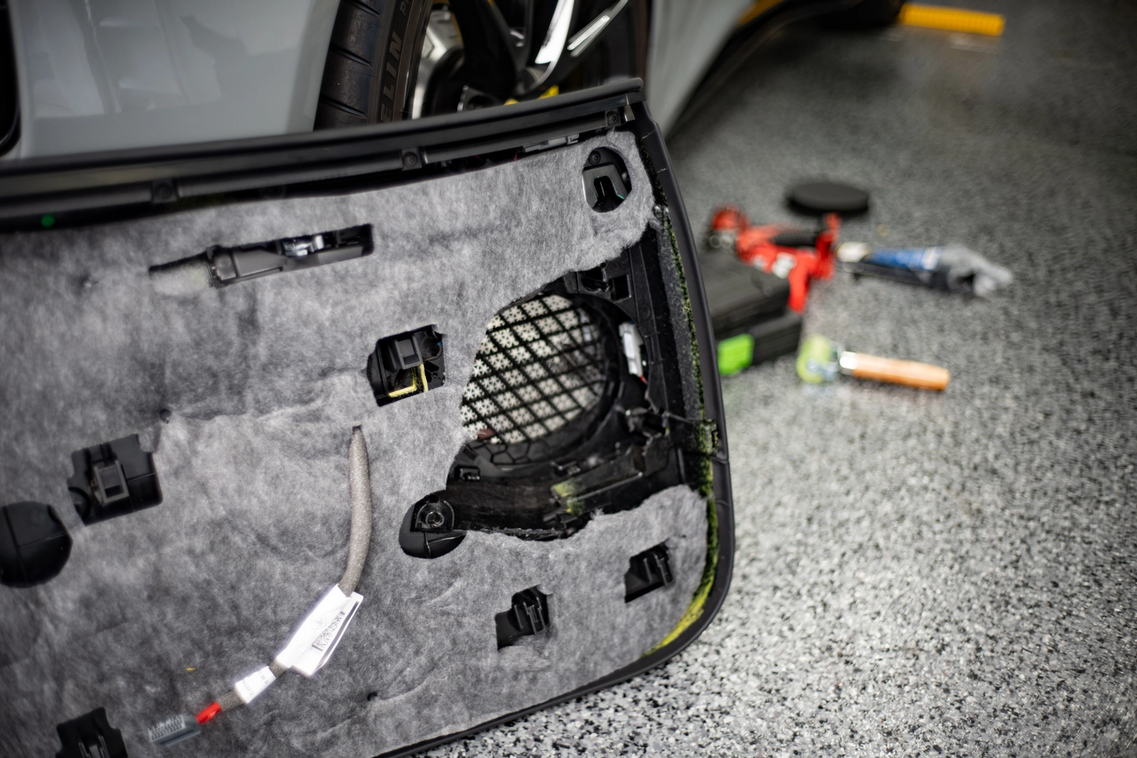

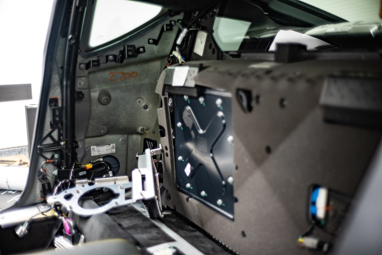

Seeing how the car is put together in these intricate matrix lego kit layers is fascinating. Just posting some initial photos as Johnny from https://www.calibredcustoms.com/ works on the car. He's awesome, just comes out to your home to install whatever you want, has done all my cars since...a long time ago lol. Lotus didn't spend a single ounce in unnecessary sound proofing weight lol...remove a panel and you just see the body panels, and hollow cavities that are no doubt echoing tire/road noise. Audio wise installing Focal components in the front doors and using the stock empty tweeter location, removing the rear sub and rear mid drivers and adding a powered 8" JL Microsub. I'll soon be at around 105lbs taken out of the car so will see where how much the sound proofing and audio gear adds - but already being down 100lbs is great.

fyi the number "2700" is handwritten all over all the panels everywhere...with a QR code and "Federal"

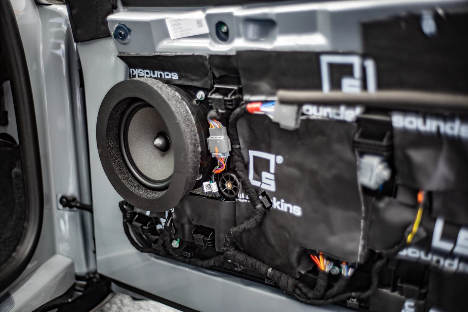

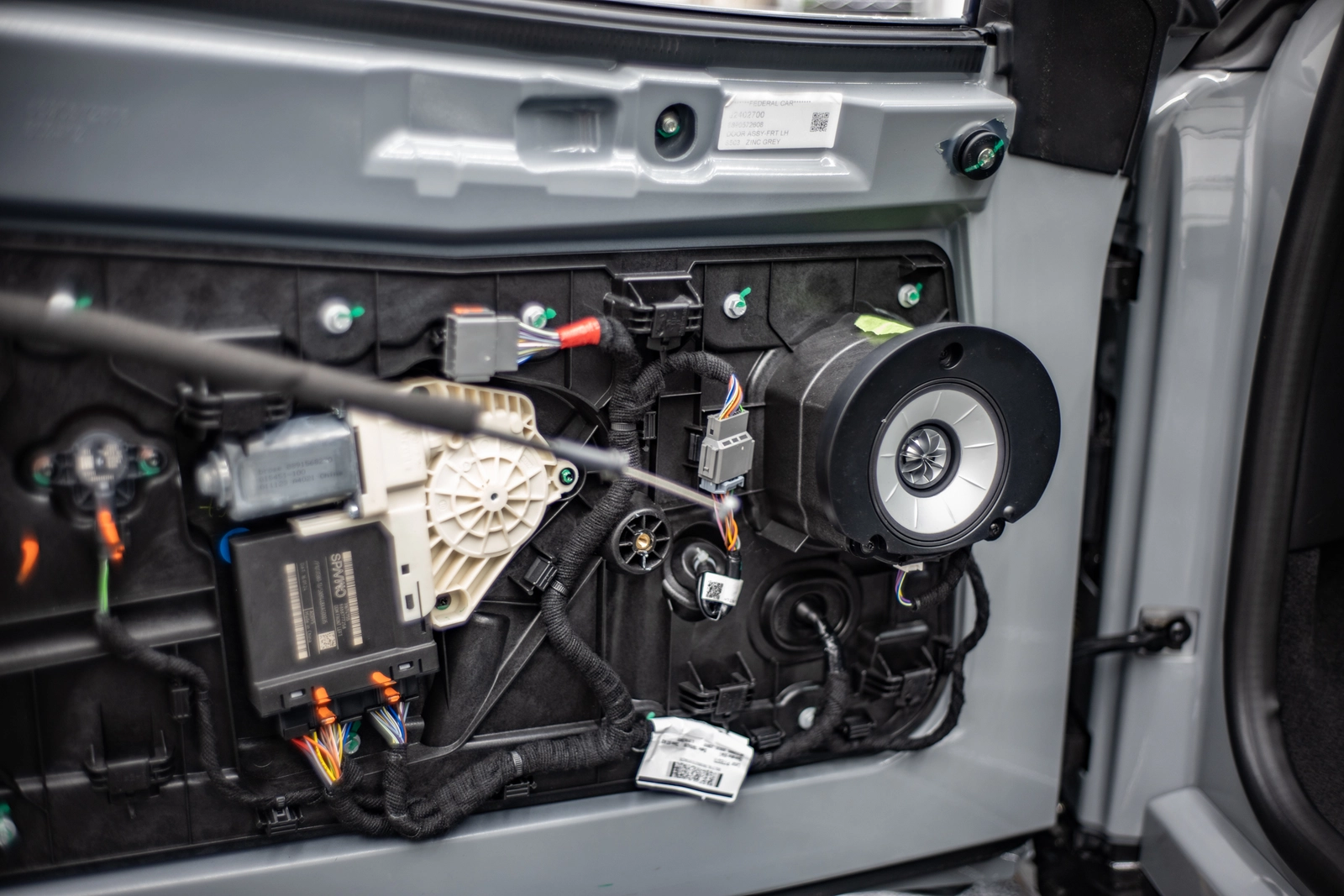

ok so the experiment of using the stock amps lasted like 10 minutes...dont' do it. The signal is split between the tweeter and 4" to the stock drivers but there's no great way to configure any aftermarket speakers to them without having massive gap in frequency, nothing sounds right. Ran out and got an Audison SR4 300 4 channel, will bridge into two channel to drive the door components and no rear speakers except the sub. Basically do whatever KJWEmira already figured out lol. Ok we are at finishing door stage with outer panel and inner panel all covered in Soundskins Pro and all the removal and fabrication of the speaker mount.

oh but yes! the noise floor...that stuff did work really well definitely recommend doing the rear firewall and quarter areas as well as the double layers in the doors. Very noticeable reduction in road noise -
