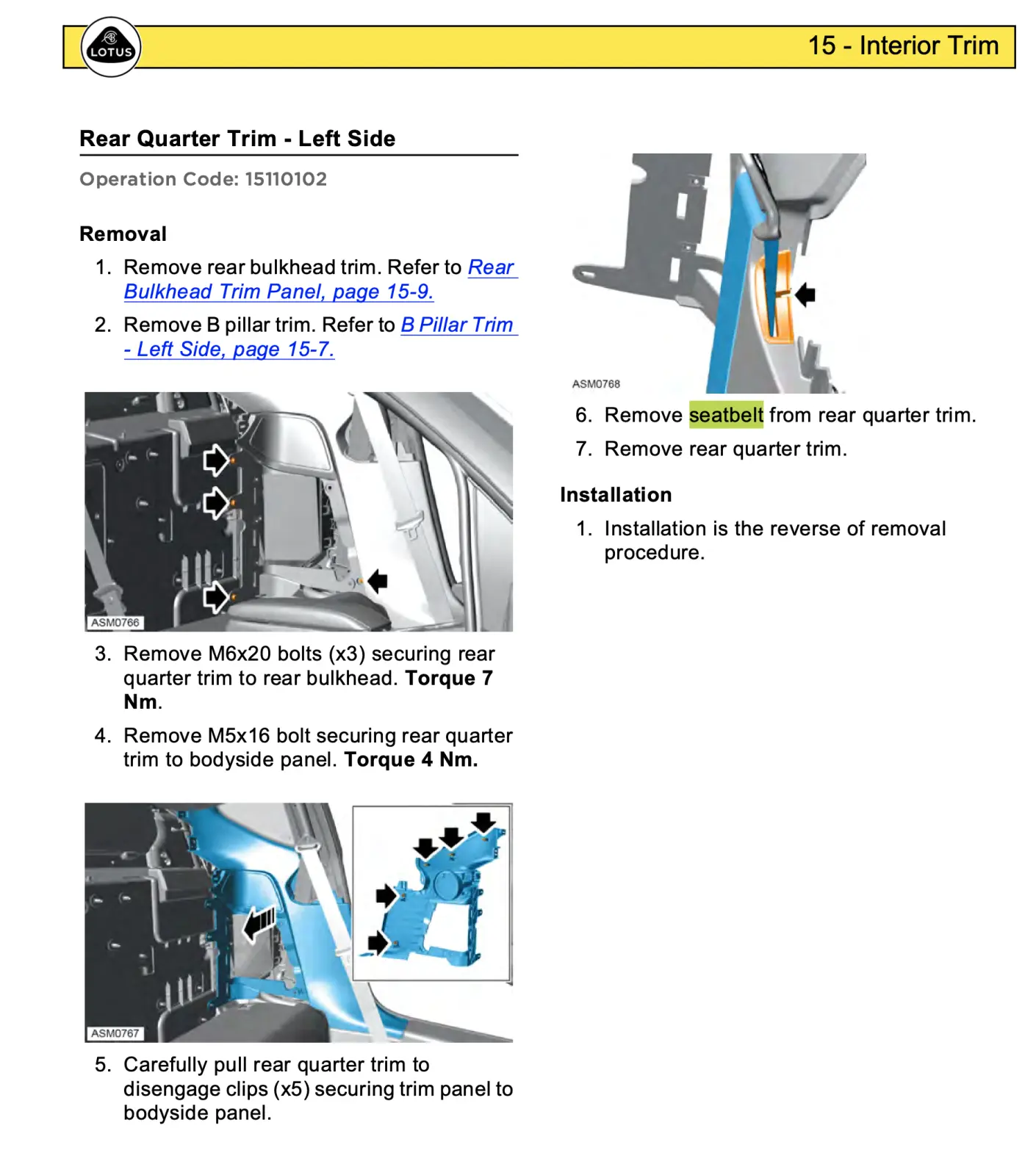

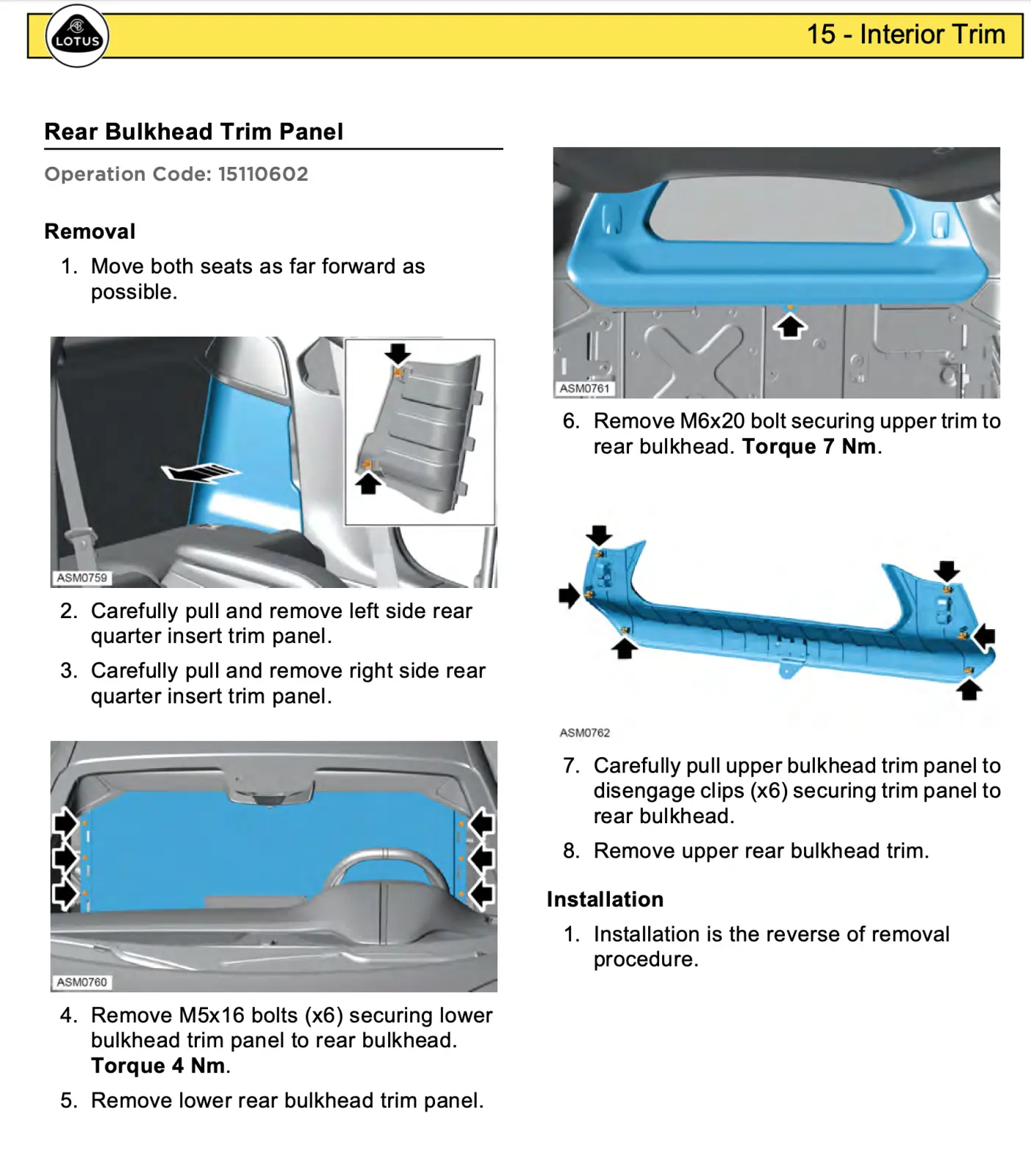

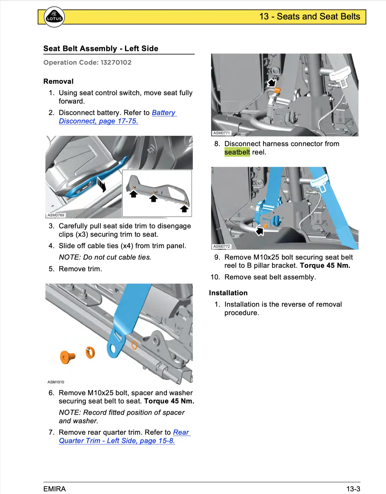

I'm at my office, with my shop manual at home, otherwise I'd copy the pages for you. Perhaps someone else with better access can do so. If not, I'll get them to you before the weekend, to help you out.
That would be great! I appreciate the help.
Hopefully these cover what you need:

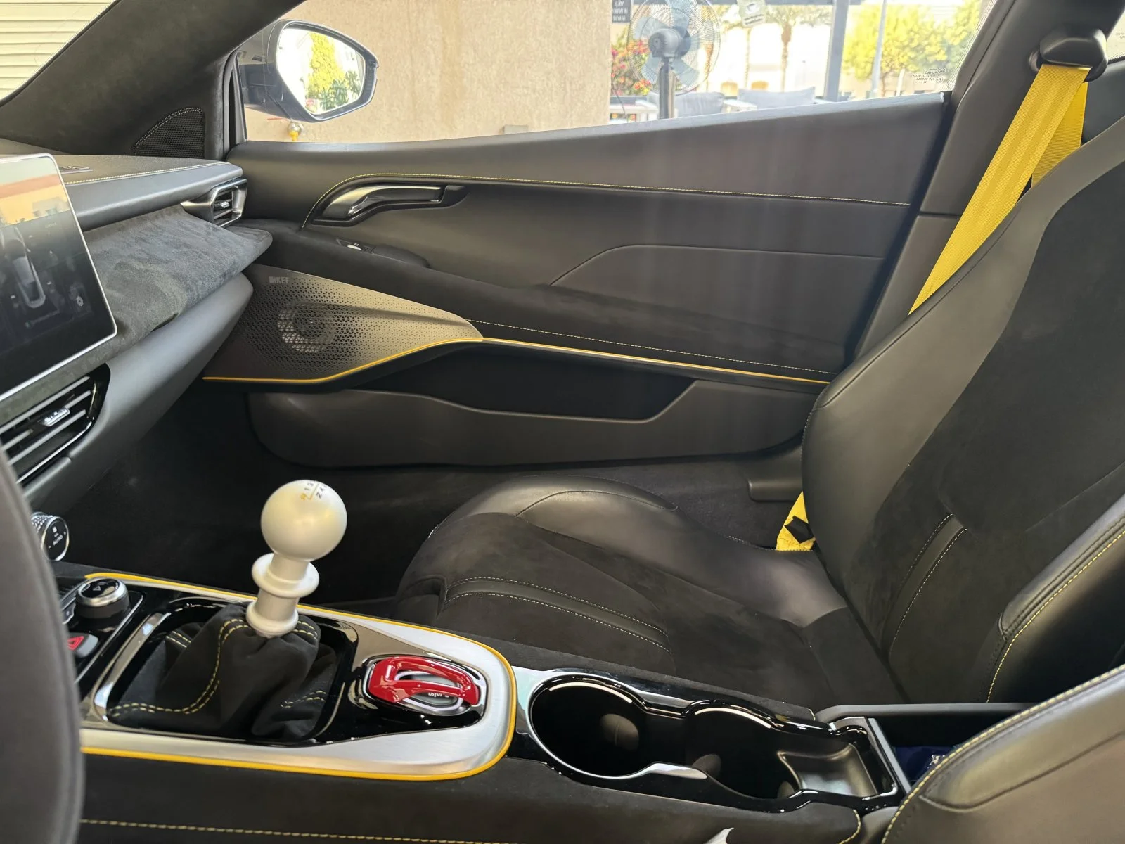

Add some yellow accents to the interior

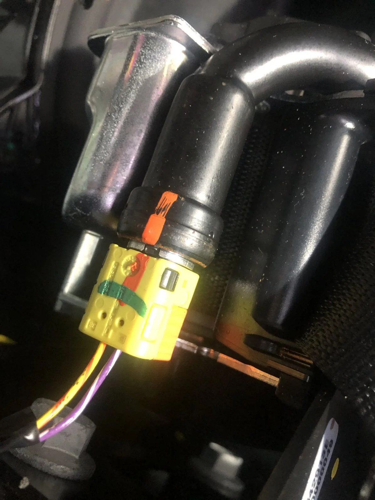

Hi guys,
My names Andy and I’ve been lurking in the background for a little while. I have a first edition Emira and was inspired by this post.
I’m booked in with Hide and Seam for a steering wheel and gaiter retrim plus some yellow belts. I’ve used the guides helpfully provided by Eagle7 to remove all the panels but am having difficulty removing the wiring harness from the seatbelt real. Would anyone be able to offer any advice to me please?
Thanks in advance.
Andy.

I might have just answered my own question but it’s too dark outside now so I’ll try tomorrow.
I’ll post a link to the video as it may help others.

Thank you - belts are out now 🙌🏻
I really like the sound system upgrade by EJWEmira but I might make do with the KEF system for now 😂
Nice! Now you need the GRP steering wheel badge in yellow
