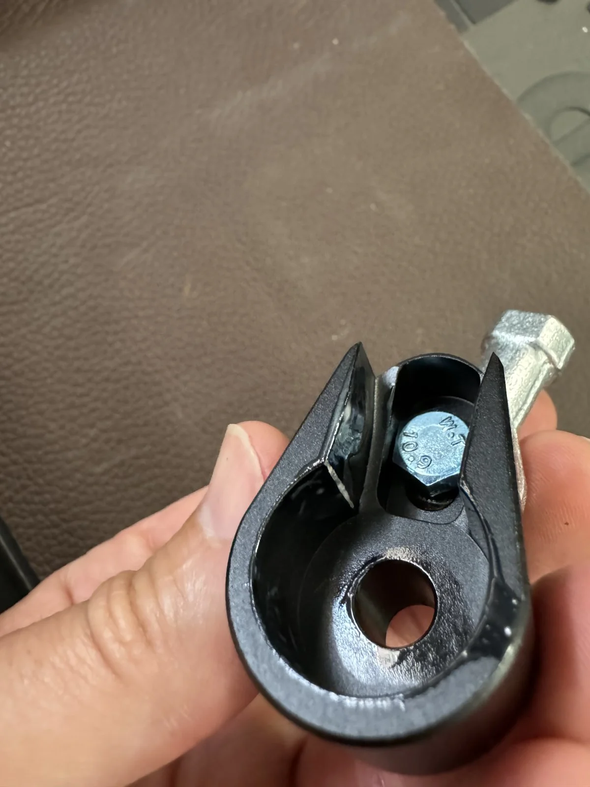

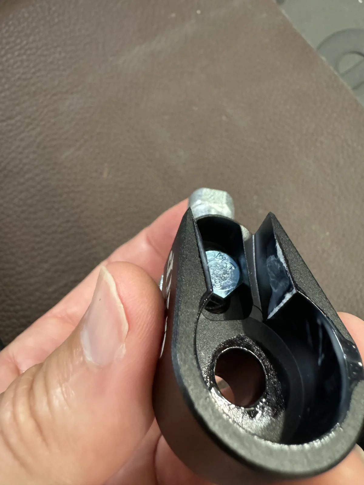

The inside body of my short shifter needed a bit of clearance with a metal file to fit. I've attached photos below.
I also used a little grease on the cotter pin post and inside the body of the short shifter to help it slide into place.
Before the installation, I adjusted my short shifter bolt and moved it into the middle setting for about a 50% decrease in the throw (it comes set at about 45%). I'm VERY happy with the results! The shift throw reduction is substantial. It makes shifting into first and second gear much easier. There used to be a bit of a rubbery squish feeling when shifting down into first gear, which has now been eliminated. Sport shifting from first to second gear seems quicker and less notchy. Overall, shifting seems more mechanical and precise. 👌

It just depends on your car's shift arm. Kitkat's fit just fine, and mine required only the slightest adjustment with a small metal file.
Reactions: GRP
There’s definitely some tolerance variation on Lotus’ side. I don’t think the variation is on Greg’s side — I guess I got lucky. The instructions on Greg’s site do indicate it’s a tight fit.
