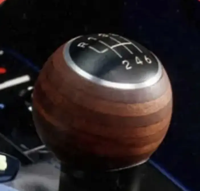

No. Haven't gotten that far. I've looked into it though, including figuring out how to do it. Spending close to $1,000 just to make a shift knob doesn't really appeal to me. If you have the means to do it, what would you charge? Even something like this; just wood with the emblem on top would be okay.

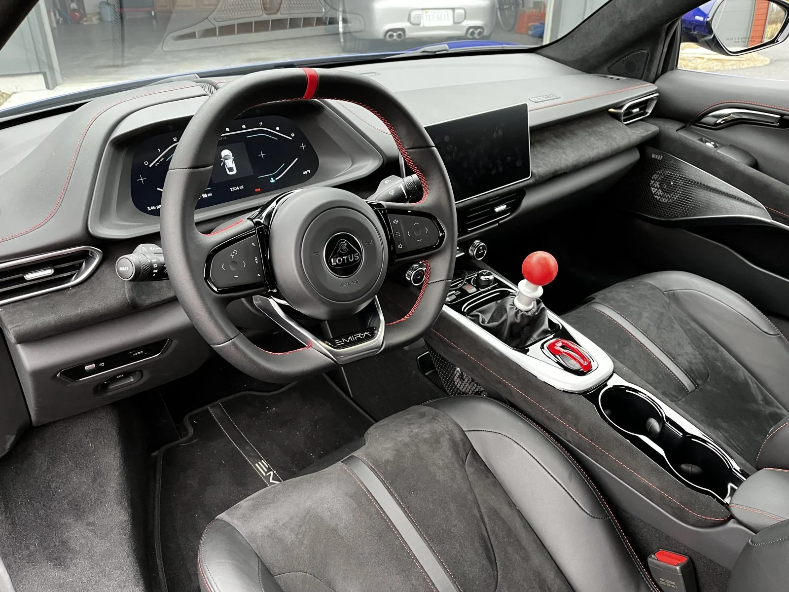

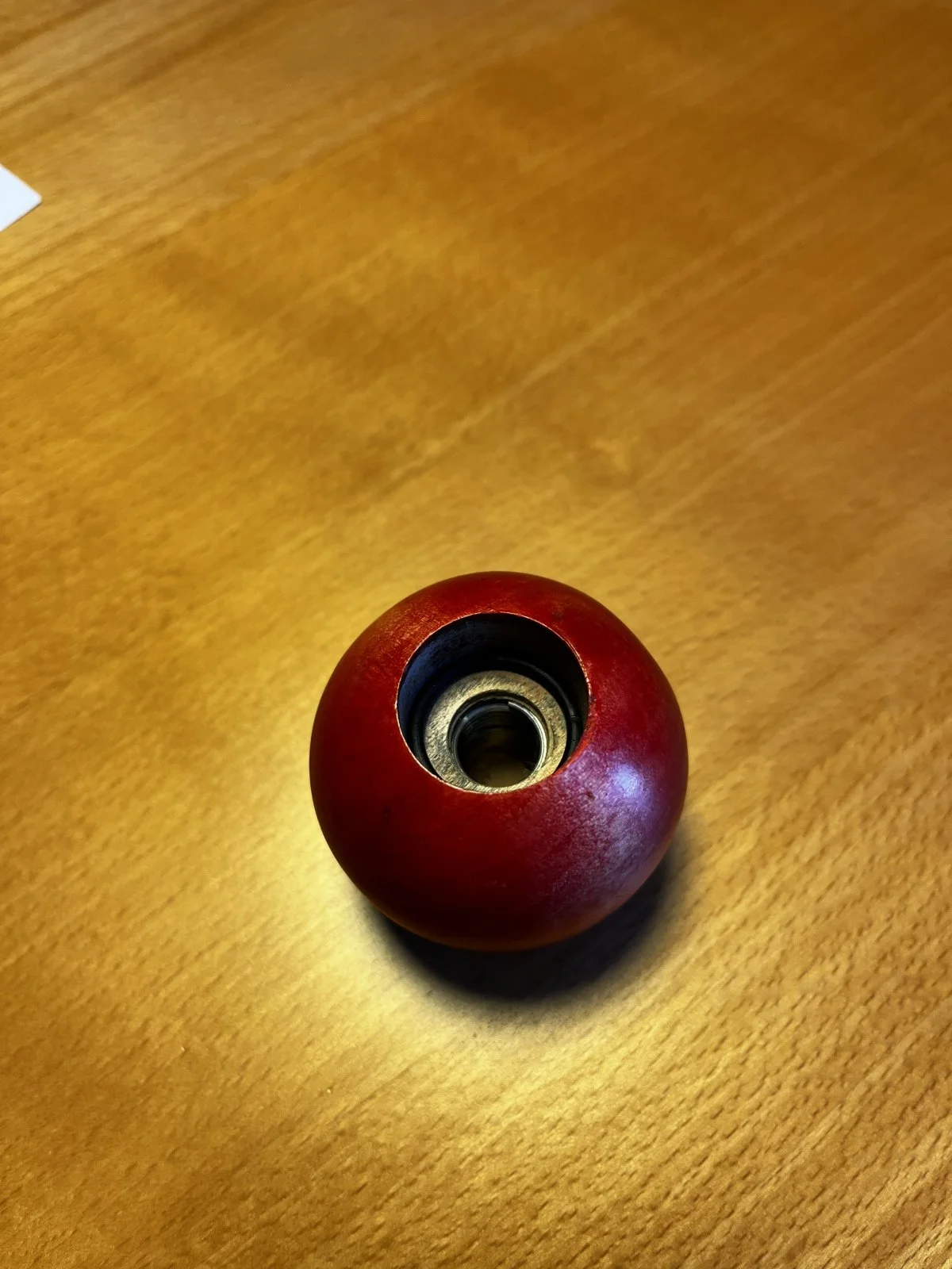

I have some 2" wood balls left from another project. After living with the stock metal knob, its rough edges and hot/cold, I decided to try to make my own. I have a black Alcantara/red stitch interior, so I made a red stain for the shift knob. The threaded insert came from a kit that includes a drill bit, tap, insert tool and 10 threadcerts. A search listed many sources for wood balls if you want to try making one. I used the dimensions that B r i a n posted on this thread. I have enough parts left to make four more if anyone is interested.

Do those helicoils hold the knob well? No spin?
Yes so far. I just screw it on until it’s snug. I’ve only been able to drive it once since I made it. It might need some Loctite in the future.
ok cool, let us know. I guess with no gate design on top, its ok if its spins a little over time.

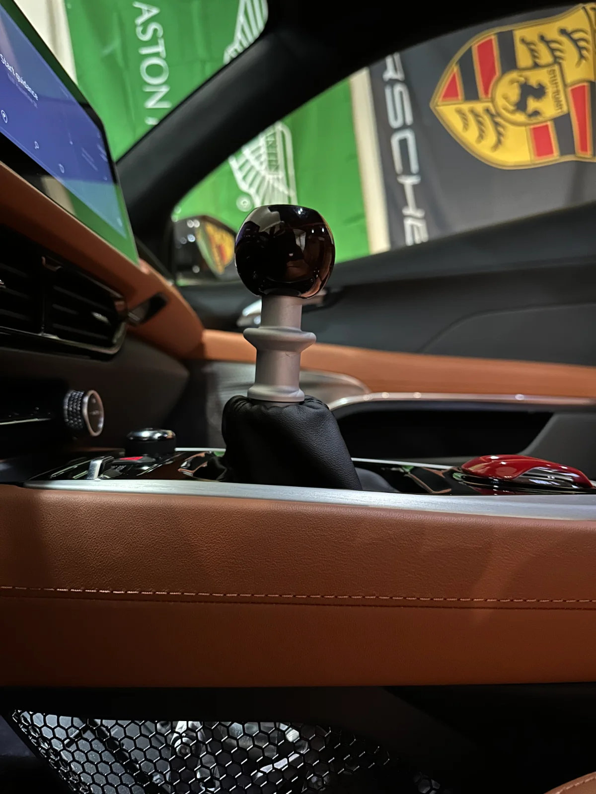

I had a Raceseng knob swapped from day one pretty much when I got the car, but found a woodworking shop in Santa Cruz, CA that made me this one... got an aluminum insert from a 993 generation 911 that the shop worked with to create the final product. Wood is Cocobolo with a gloss expoxy finish. Same size diameter wise as my Raceseng was, very similar 'weighted' knob compared to stock as well. Started this a couple months ago, before the Jim Clark Emira with a wood knob came to be :sneaky:

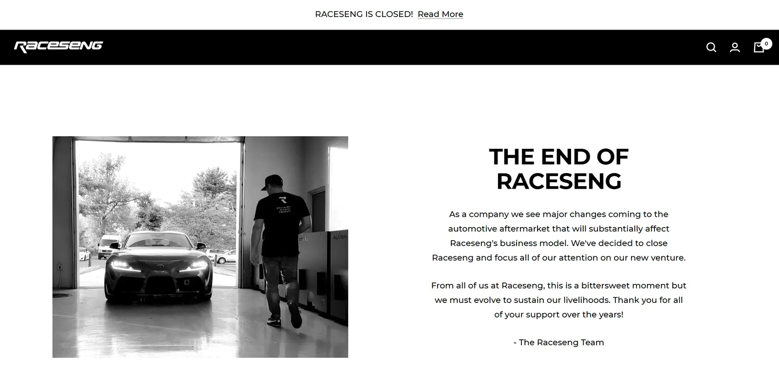

FYI, Raceng closed up. Took a look to see if they still had shift knobs....
