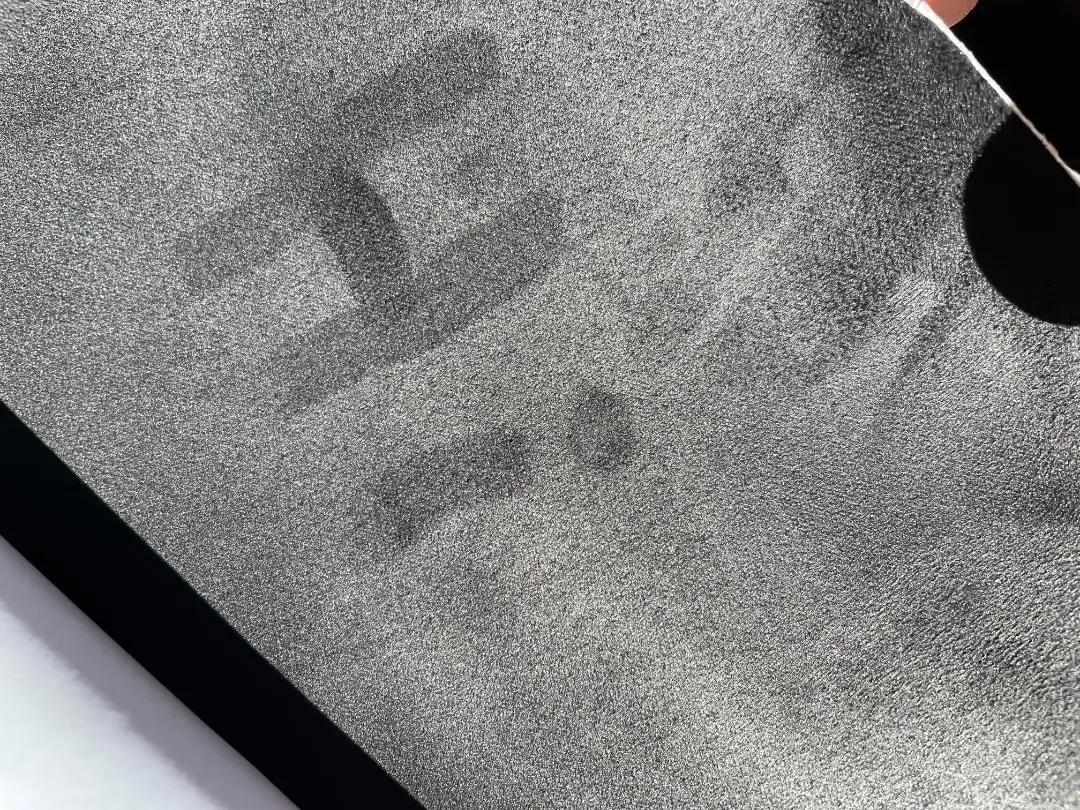

These were much more difficult than most and seem to be made from some other worldly material. I tried the isopropyl route which has worked to melt most stickers I've dealt with. Very little help with these. I soaked them, put them in a plastic bag and soaked them with little success. I move on to denatured alcohol, and this seemed to be a little better but not much. I also found that the stickers were much more stubborn in some areas versus others. I think they are applied with heat. I moved on to my wife's nail polish remover (Acetone) and it worked the best and smelled better. It was slow and tedious, but I finally got the stickers off. I used a small plastic scraper made for cleaning pans (looks like small bondo spreader) and my fingernails. I discovered how durable this material is. The fabric got loose from the liquid and the mechanical agitation but tightened back up when it dried. I was pretty amazed, but you could wear through it if not careful.
When done, you can still see a faint outline, like when removing most stickers but it no longer sets off my OCD-ness, and it's not obvious, only a real car geek would notice. At some point if I decide to do some other Alcantara/Leather/stitching work I may have them redone, but only if I want o add a contrasting stitch.
I watched this video about removal of the stickers from alcantara, but haven’t done it yet. Done similar process in the past using rubbing alcohol with vinyl sun screens.
A word of caution: I bought in on the above video and ordered the Wurth cleaning solvent, to try and remove the visor labels from a 2023 Corvette with an alcantara interior. It didn't work. I then tried the isopropyl alcohol...and then (in total desperation) my spouse's hot hair dryer, combined with both. Nada. I then worried I'd damage the alcantara around the edge of the label as I tried to lift off the label, so gave up. Perhaps it was just my particular vehicle, with its "super-glued" visor labels (??). Don't know.

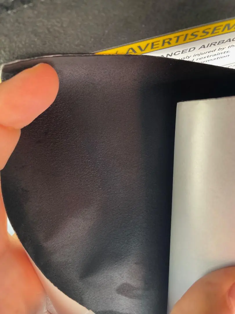

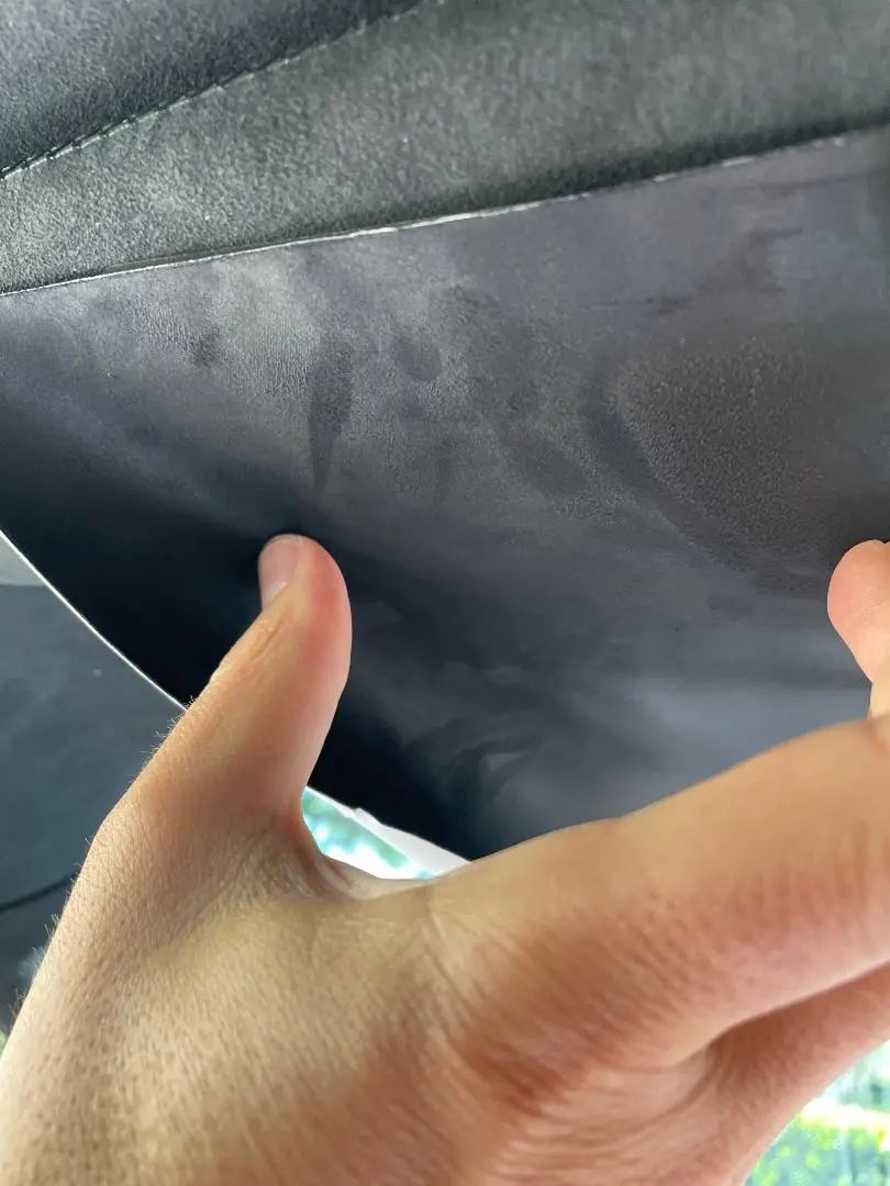

@crestima, so doesn't match well but feels good.
1st pic is in the garage that is sort of dark, the 2nd is the car outside and sun out (but not directly light coming in), and 3rd is held up to the ugly visor sticker. Seems a little darker shade.
My front windows are not tinted
If someone finds a good match, please post here and tag us. Probably not worth my time to figure out the exact match so I will return this, but if someone finds a close match, please let me know.
