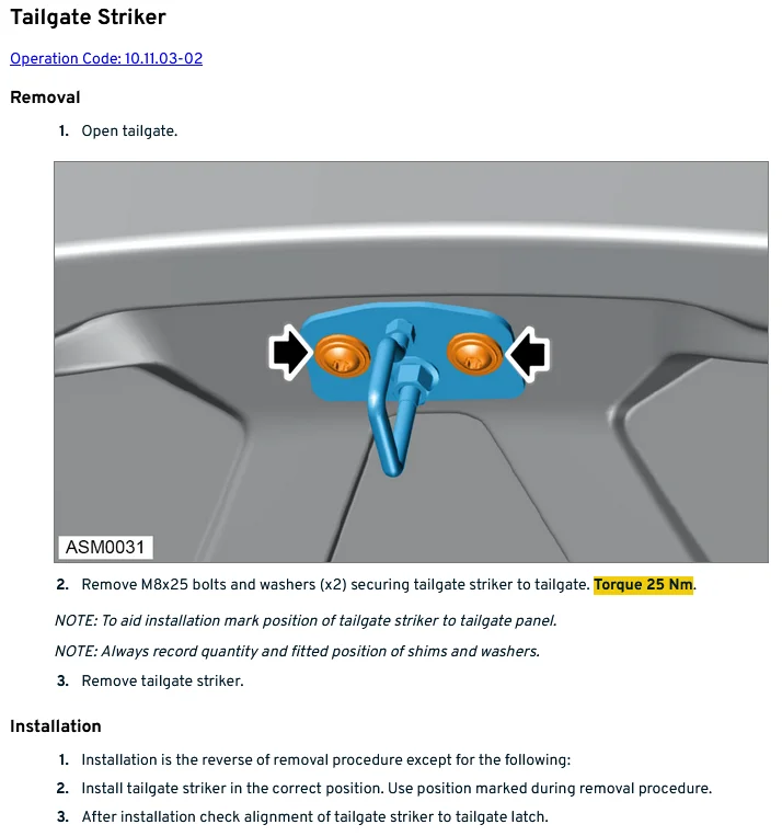

It might be worth taking the tailgate striker off first to see if water drains from the fixing holes. Also maybe the corner bump stops.

This is a very good idea and I appreciate the detail with image too! We think alike. This was the first thing I tried when it rained hard back in November. Unfortunately, the water did not drain from the mounting holes. They must not go all the way through into the void. I removed the entire striker, but no drainage. I may proceed with drilling drain holes, but am a little concerned of modifying the car when I'll take it to the dealer later this month.

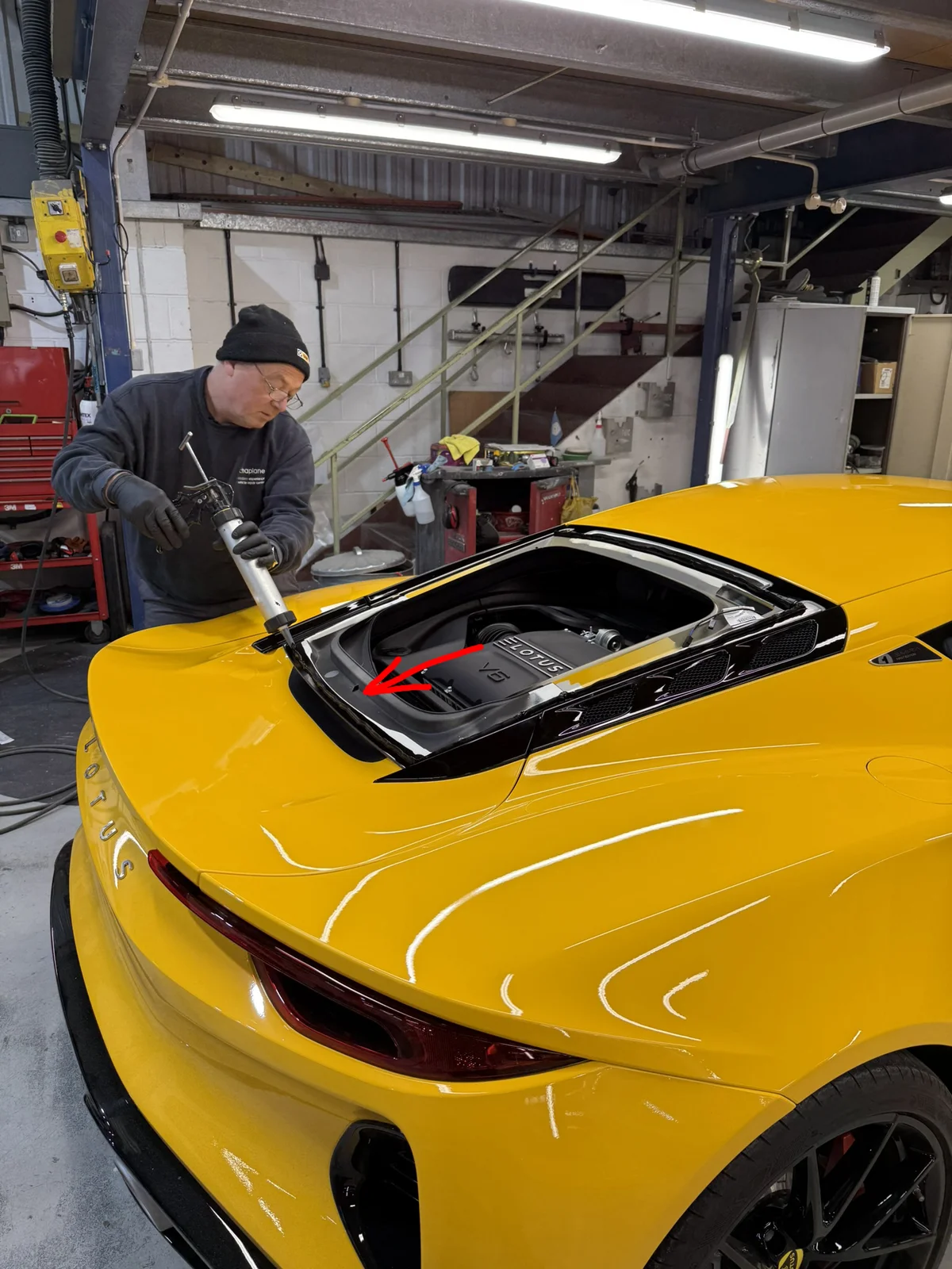

This is my car about to have the rear screen stuck on a new tailgate.
I wonder if the water is in this void that's normally not visible behind the screen?
