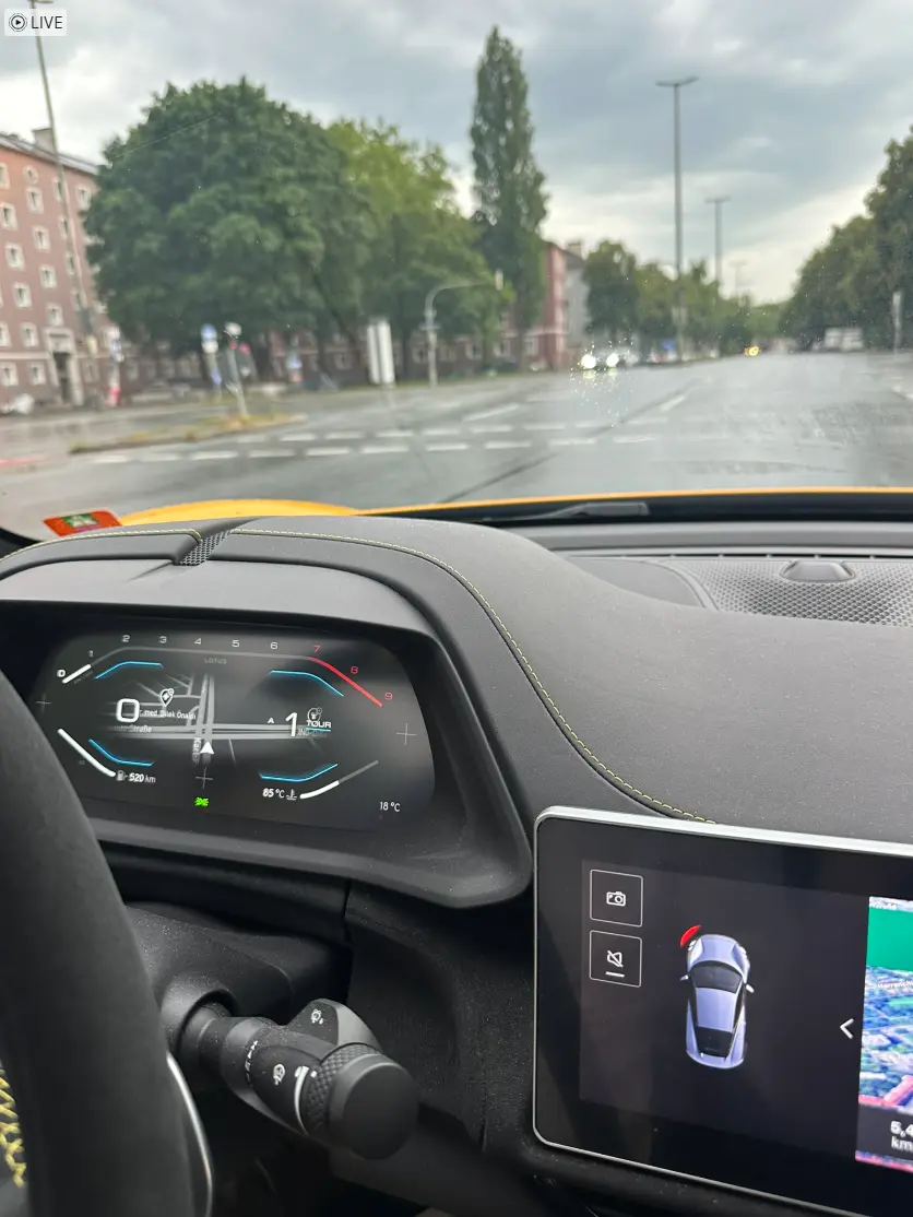

would you mind to share pictures "before / after" ... to get a feeling of how much the front licence plate was interfering
Was it as well the front left / side position that was overreacting with the licence plate or was the "object" shown in center position?
that's my current pain point:
I was able to see, that the full PPF is also slightly above the parking sensor, so I might need to re-cut or have the team do that for me.
