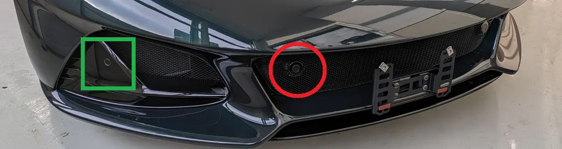

Which ones are we talking about? The "corner" sensors (boxed in green) or the "front" sensors (circled in red) ?

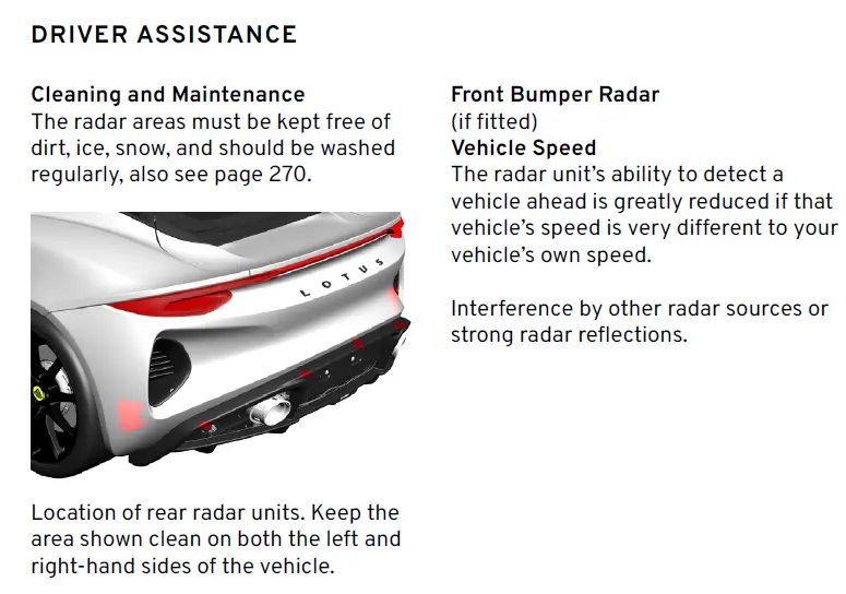

Well, the plot thickens. While reading the manual, I noticed there is another area highlighted as having radar aside from the visible circular sensors, and it does note that PPF can affect it (on a previous page). Note the red area on the left and right of the bumper here. I thought this was just a control unit or module, but then I noticed it says to keep it clean. Any ideas if this combined with PPF could be an issue?
On all US cars so far (first edition) there is nothing there. I know the area you’re talking about and the bumper has a recess for it but there’s no module present. Many of us put the Miltek valve controller module in that spot.
For me, it's always seems to be the far right sensor giving false positives. Maybe it's not a problem with the software, as I suspected, b/c this probably would be happening on the left side, as well. 🤔
My memory may be suspect, but I don't ever remember seeing this on the far left side sensor. Will keep monitoring.
False positives have always been on the front left for me, so if we are running the same software, the probability of a hardware issue would be higher. No way for the end user to confirm the software level, so we're all just guessing...

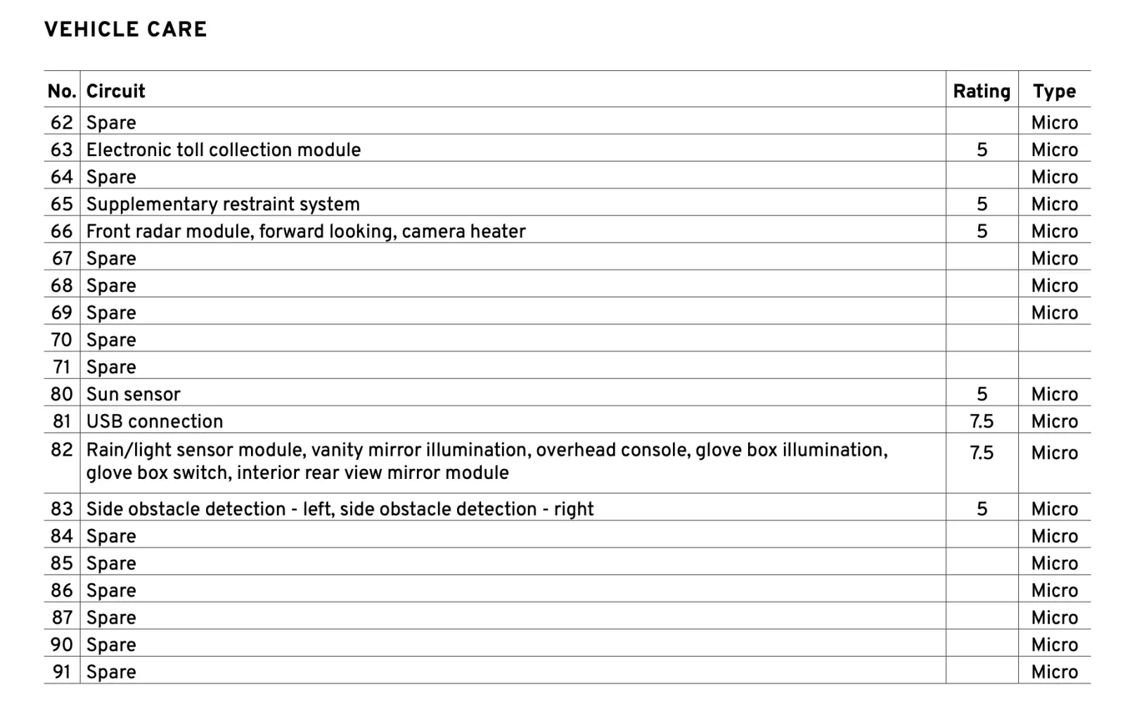

According to the manual (this is for the U.S. cars) the Footwell Fusebox has the fuses for the front sensors. It looks like fuses 66 and 83 are the ones for the front. Considering how some have reported water making its way down into the footwell, it may be worth doing a quick check to see if there's any evidence of that on the fusebox. Check the fuses to see if there's any evidence of corrosion or oxidation, and then make sure they're completely seated.
The intermittent nature of this seems like it may also possibly be caused by vibration. Check all connections to make sure they're secure.
