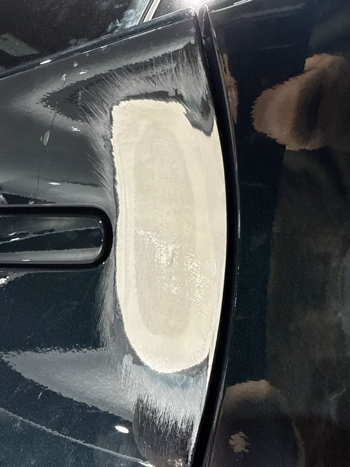

Not sure if this helps or hinders the recent comments but my rear quarter was repaired due to blistering (not replaced) and 3 weeks later I have new blistering in exactly the same place or within 5cm of the original spot (It may not be on the identical spot).

I got the car 2 years old and it had already had the doors replaced before I took ownership. Then washing it one day I noticed the blistering on the offside rear quarter so took it in to get inspected (along with the car not starting intermittently, the boot not latching properly and forget the other issues). I asked for a replacement panel but they said standard practice is ti sand down and respray. Looked good at first but my next wash and they were back again. This time will aim to push for a replacement.
Repair in place has indeed become the standard practice for the quarter panel recently from Lotus as it is very labour intense to replace this particular panel. But as you have found - just sanding down the affected area, repairing and respray often does not work - the whole panel is affected and so the issue is likely just to re-appear later in untreated parts of the panel. I have heard that repairers are speaking to Lotus about this - recommending they go back to replacing it.
does anyone have photos of the location of the blisters on the rear quarters?
I don't have photos but I have seen another car that had the rear quarter affected in for work at a dealership. Here the blistering was over the near vertical part all underneath the FE badges on both sides.
