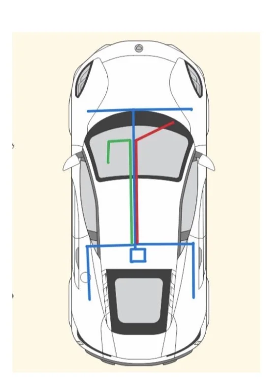

Awesome to hear! How was the wiring routed for the electrons? Where is the damper controller stored?
Here is a diagram. The square shape is the controller. It’s basically the base of the armrest on rear shelf below carpeting.
The cable routing wasn’t super fun for my mechanic, but we were initially attempting it totally blind with no instructions at all.
I hope (and reasonably expect) that others will have an easier time with the install. Nitron’s instructions should only get better with time.
Now we just need their cool led screen interface to launch!
(If anyone wants to talk to my mechanic for install tips, he will almost surely do so for a carton of menthols)
That looks like a headache to route, I think I’ll just stick with regular and have front axle lift 😂
