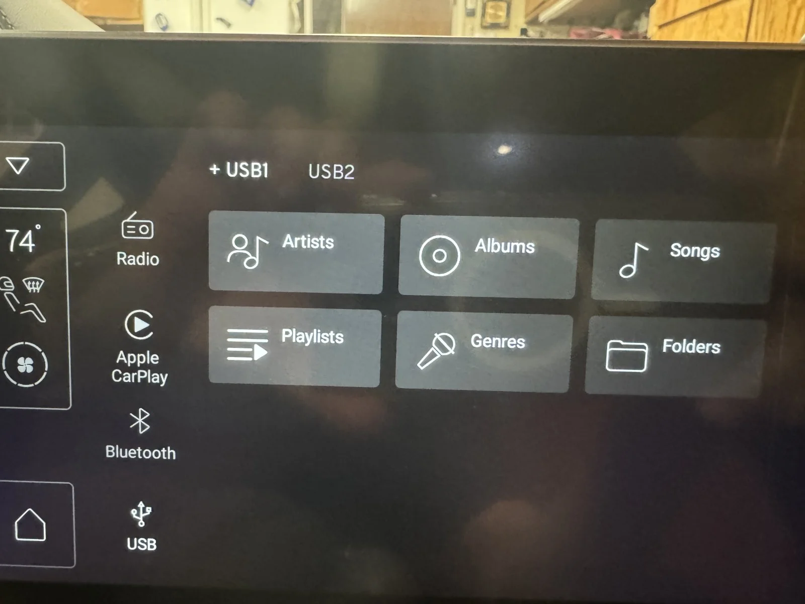

My USB C works but not the older USB port next to it, tech at dealers tried my USB in another Emira and it wouldn't work, even though it works fine in 4 other cars.
So to be clear your USB-A stick works in NON-Emira vehicles only? Is your USB-A stick formatted as FAT vs NTFS?
Did you switch to USB -1?
Fat32. I formatted a usb c stick the exact same and put the same music on and it works fine in the USB c port.
How do you do that, it only comes up Media>USB and doesn't recognise anything in the USB A port, but does when I plug USB C into the USB C port.
Actually select USB2 as the USB-C is 1 and USB-A is 2
Duh, what an idiot! I didn't see that. 🤦🏻‍♂️ How embarrassing. I'll see later.
My excuse is I picked the car up yesterday after the dealer got the screen working for the 1st time, a pinched/broken wire in the dash. Though the reversing camera isn't working either.
Thanks for that.
