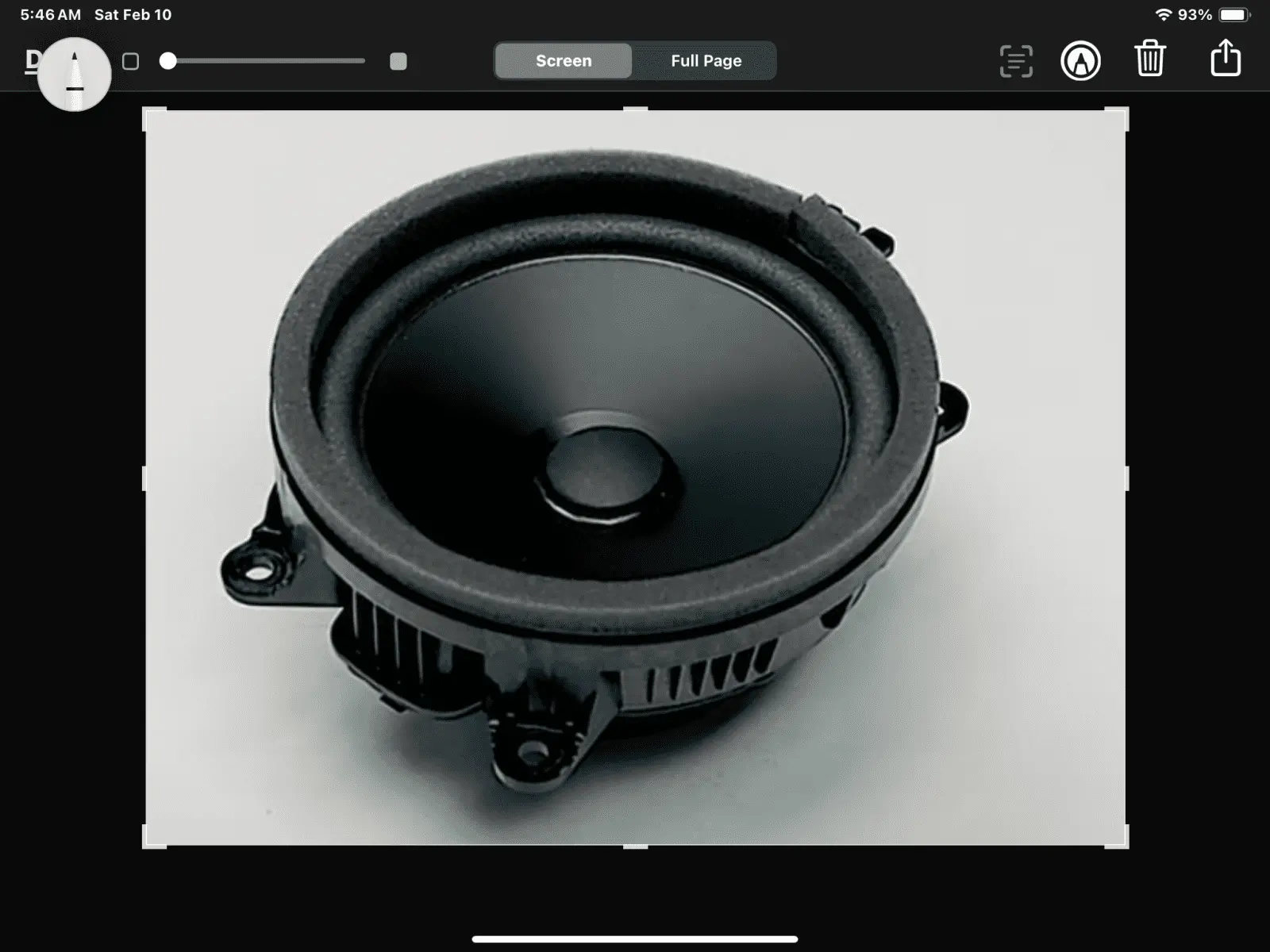

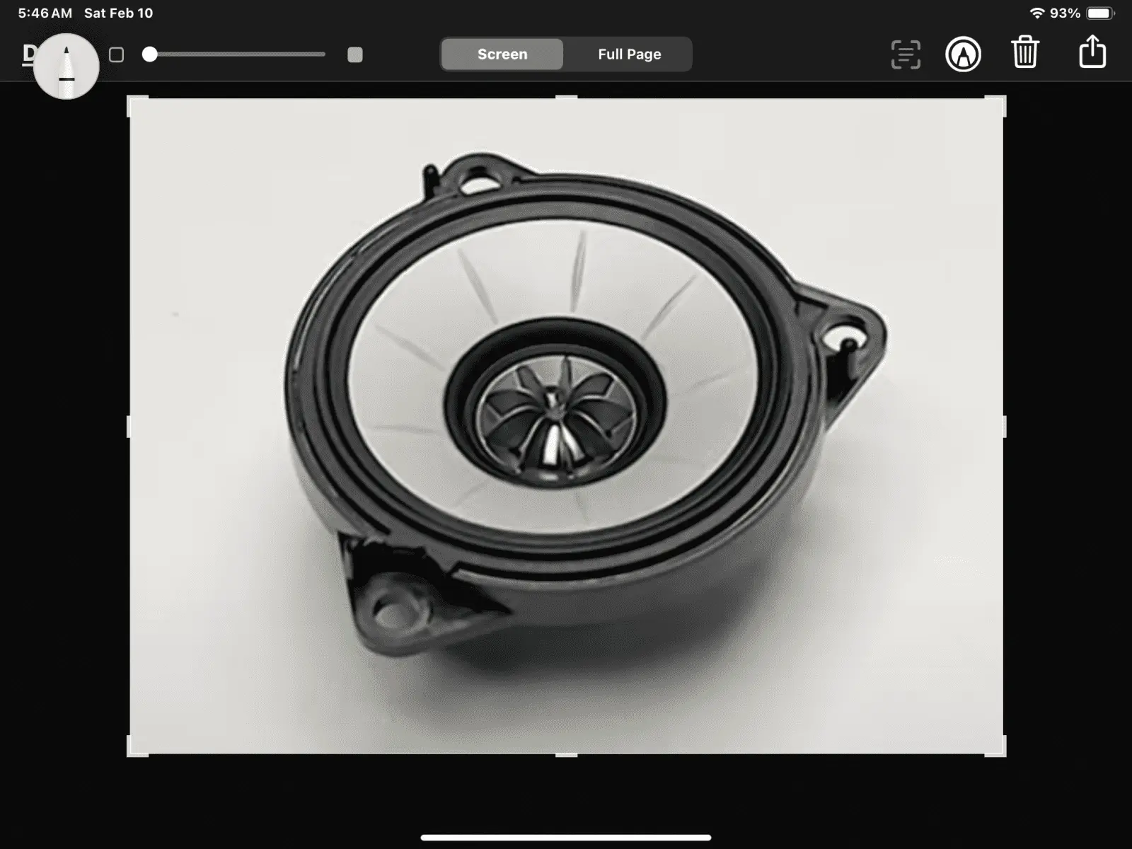

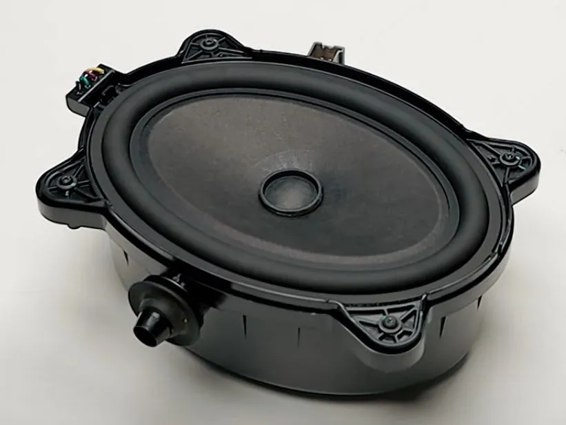

View attachment 37006View attachment 37007View attachment 37008View attachment 37009
Frankly, except for the subwoofer, all the other drivers look fine. Event that subwoofer looks okay construction wise on the cone and surround, it's just not enough cone area and excursion (judging by the small voice coil) to generate a satisfying amount of low distortion bass. There is nothing about the materials and construction of the other speaker's that are questionable based on visual examination.
I wouldn't make assumptions about the quality of the driver based on the appearance alone. A driver that meets specified performance characteristics, well, it meets those performance characteristics. It's the integration of the driver with crossover, amplification and signal that produces a result. You can get ultra high-end results in a room with extremely inexpensive drivers if it's integrated correctly. The same is true in a car.

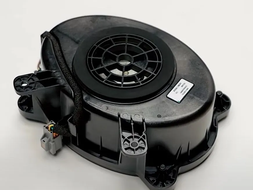

I have an old JL Audio 8W0 in a tiny sealed wedge box that I might put on the rear shelf or behind the passenger seat, and bypass the "fresh air" unit entirely. I'm not even sure it would need a booster amp, it depends on how much real wattage the factory amp puts out.
The OEM sub is a DVC sub design, based on 4 wires going into the sub enclosure. Ideally, you would want a DVC sub to take advantage of this.
However, there is likely a high pass filter on the sub to reduce low bass output to prevent over excursion given the free air design. This would make a sealed sub sound too lean.
So… not only would you need a booster amp, you would need to offset that high pass filter somewhat with a bit of EQing.
Edit: it might be easier for someone to build a new tub that fits a shallow DVC free air 10 inch sub at the factory location. Looks like there is plenty of space.
If that's the case, it's probably using two channels of amplification for the sub, possibly with one phase reversed. If we can get into the Harman amp config, those can probably be matched and bridged.
Hell, if it's DVC but with common phase, it may be possible to simply bridge the channel as it is. Many DVC setups like this are 8 ohm per coil, which would make a single voice coil sub at 4 ohm a good substitute. Has anyone taken photos of the back of the existing subdriver? It may be printed on the basket or on a sticker.
I can probably use some software to figure out the electrical outputs and see if they are in phase or out of phase. If it's fully reversed then you could just swap the phase of one channel and direct bridge it to match peaks. If it's quarter phase DSP sort of situation that gets way more complicated. Would require a little electrical analysis.
I am basing it off listening to about 4 plus hours in 5 different Emira's. The last one was a sellable unit owned by the dealer. I went back last week. In that car, it's about 1 1/2 hours listening.
Did you put the fader all the way forward to eliminate them? Curious if that improved your experience.
The reason these discussions are getting detailed so frequently is people are conflating objective discussions of the technical aspects of the OEM system with their own subjective listening experience.
No one is challenging what you heard.
What I and others are saying is that specific technical details of the OEM drivers do not preclude a good sounding system. For example, the OEM rear midbass having a poly cone: the Audisson top-range Thesis midbass drivers also use a poly cone. The mid-priced Voce midbass used in this aftermarket install has a pressed paper cone.
Both paper and poly cones are tried and true cone materials. Some of the more exotic materials like aluminum and woven fiber *can* give great results but needs a lot of engineering to avoid some of the pitfalls related to come breakup modes due to these materials being inherently not well damped mechanically. The KEF uni-q driver has an aluminum midrange cone, if I remember correctly.
Again, we can't just look at the appearance of these speakers and say they suck. Except for the sub.

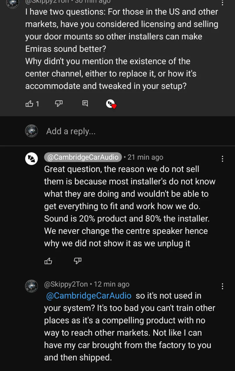

The fact that they missed the centre speaker completely makes me 'walk away' no matter what - its just an advert....
Center speaker is irrelevant for their set up. To remove it watch their video on the Ferrari system they installed, they removed the entire dash. Even if they don’t have to remove the windshield or dash to get to the driver it’s not important for their set up. In the KEF system i think the center speaker is used for voice fill in, i could be wrong but that is my theory based on the door mid driver tweeter placement. .
Most center channels in car audio systems are used to pull the soundstage to the center, to offset the effect of listeners being closer to one side than the other. It does this by masquerading as reflected sound: it's a summed mono signal at a lower level and slightly delayed in time, usually usually aligned with the first reflection from the windshield (2ms-ish). It's generally very difficult to get well centered soundstage for both front occupants in a car without a center channel, but this depends on the car and the speaker mounting location used - further away is better.
In the Emira it would also help stabilize the soundstage height when the listener's head moves around. Speakers within a +/- 30 degree height difference from the ear don't normally cause significant soundstage height perception changes, but the listener could pickup cues of the soundstage height shifting if they tilt their to look up.
Respectfully disagree - it doesn't matter what its used for - they didn't even mention it - they rubbished the KEF system - and the 'small tweeters' in the door - the centre speaker is there for a reason as others have said to provide sound stage - if they weren't just filming an advert, they would have at least mentioned it
And that is my point with the center channel. They didn't even mention it's existence. Not too remove it, to explain how it works in their system, nada.
They unplug it and leave it there?
It is a lot more work to get into the dash. Maybe they would do it on a more expensive system. I would be surprised if Audison doesn't provide a solution for center channel processing. It's just so common these days.
