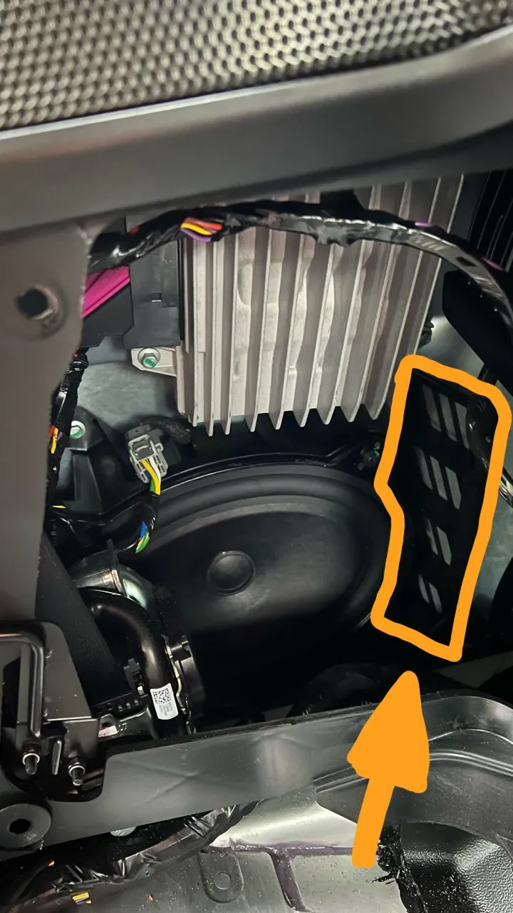

Today I fixed my slight rattle problem with the sub. You can hear it very well when the engine is shut off, but not so much while driving. Nevertheless, I didn't like it. To show you where the problem came from, I stole the following pic out of the forum and drew an arrow on it:
What you see there is a pressure relief valve. You will find one or two of those in every car to release the pressure that's bilding up while you are slamming your doors ;) In a bigger car they are usually located somewhere in the very rear. As you might see, Lotus placed it exactly next to the subwoofer and therefore the sound pressure - even at VERY low volumes - makes those membranes flatter and create a rattle noise. Easy fix was to click it out of place, put some 6mm self adhering Armaflex on each of the membranes from the other side and put it back in place. Now there is more weight to them and they won't move anymore due to the woofer. Of course they still work just fine when closing a door.
The removal of the trim panel is straight forward. Start where the luggage net is hooked and just pull from there. There are two clips in the front top and buttom and that's it. After you unclipped them, you can pull the panel out with some force. Only tricky part is the top, because it goes under that speaker grille lookalike.
Thank you for this, I'll definitely try that!

I am still in disbelief that they put the cabin pressure relief flaps right next to the subwoofer.
