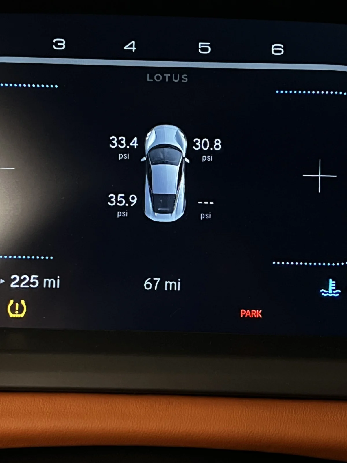

Hi, my tire pressure readings are correct.... 31,35 ... but it's shows as low on the dash... but car computer says it's fine...
What gives? It did that n went off the first time.... this time, it's not going away.... how is this fixed ?

Ok....I have a tpms programmer..will try.... it's annoying cause the car says that "all pressure normal " yet the orange dash light is ON.... if the tpms units are bad, it wouldn't send pressure reading so. ..it's something to do with the lotus ecu itself.... my car supposedly had the latest software from Jan '24 installed but..... ?!??

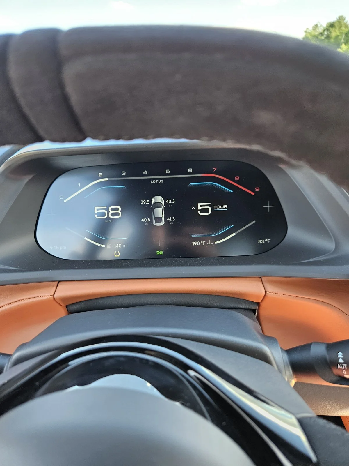

Here's an example of readings showing but the numbers don't match a manual tire pressure reading in the low 30s...
Whatever the cause, the readings displayed on the dash are inaccurate.

I see.... I ll remeasure mine manually too..... I thought they correlated before but....
