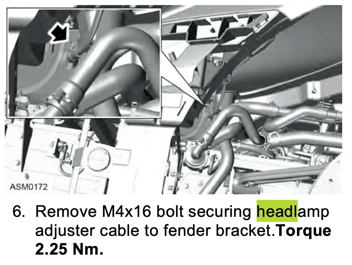

The service manual refers to a "headlamp adjuster cable" but it doesn't have anything about actually adjusting it. Your dealer would probably be able to do it.

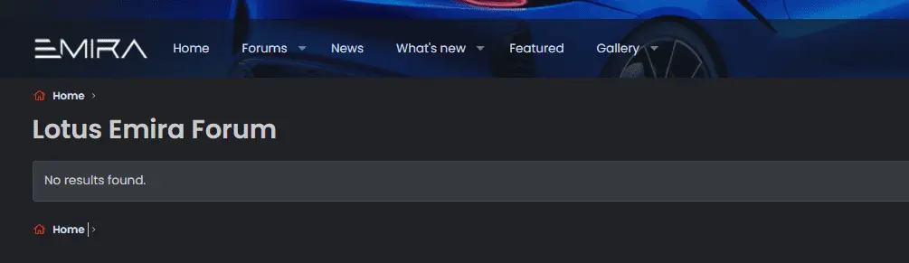

Thanks for sharing the post. Respectfully, I DID search for this on search engines, in the handbook, and on this forum. Unfortunately, forum application search algorithms are often fairly useless. For example, my previous search of "headlight adjustment" returned this despite the existence of "headlight adjuster" in your post:
It seems that nobody was able to actually find it and since you were the OP of that post, it makes sense that you pulled it from memory :)
Regardless, I genuinely appreciate the tip/information. I'll test it out tonight to see if I can properly adjust the low beams to see more than 50 feet in front of me.
EDIT: If you do a search for "headlight adjust" it does come up. The search algorithm apparently requires an exact match of the entire string. Good to note for future searches in this forum. Use the most basic form of what you want to find.
