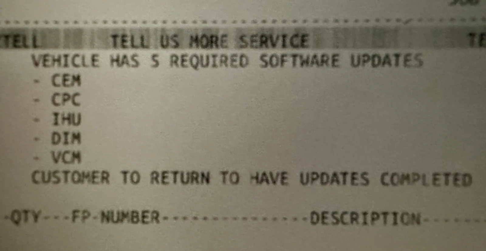

Just got back from the service, and found that there are 5 updates that need to be run - two of which are 3+ hours, so it will be a drop off at a later date. Service rep did run the VIN before I arrived, no updates listed. I was only when they plugged the car in that they got the list he provided. I did ask the service rep put the updates required on the service receipt (picture). I have no idea what each of them are, but another issue that popped up "Right rear turn indicator" fault, but they investigated with Lotus Engineering and they responded with "known issue, actively working on a fix, no resolution at this time".

When you do get these can you get a list. It’s strange I had 3 applied and yours lists 5. I picked mine up in march last year so a year old.

Will do - I'll ask for specific details about what they address..
OK, I received a little bit of information on what some of these updates are, from a Lotus tech - not what they address, but what components they update. He said the IHU is something he has not heard of, and didn't have CPC off the top of his head. He heard of the DIM, and from memory thought is was brakes.
CEM - Central Electronics Module
CPC - Central Powertrain Controller ( @Neil D. @gdotp )
IHU - Integrated Head Unit
DIM - Brakes (maybe)
VCM - Vehicle Control Module
Still investigating what each update addresses, but Lotus tech told me there is no PDF to explain each update - they scan the car to find updates available, send to Lotus to determine if they are required, if yes they apply them. Additionally, I was told that the Lotus update tools will not run off the available high speed WiFi, that they have been using mobile hot spots - hence the updates taking hours due to transmission speeds... :eek: (did not see in practice, so can not confirm)
