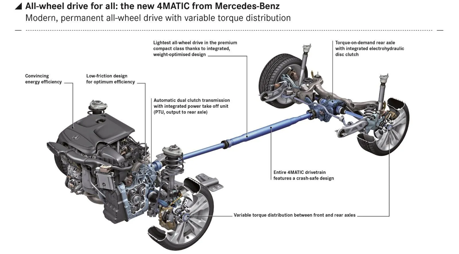

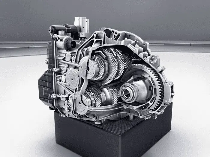

So the A45S has the 4th generation system called 4MATIC+
- The DCT gearbox up front mated to the engine's output shaft has three outputs: front left axle, front right axle, rear driveshaft.
- The front left and right axle do not have a mechanical differential electronic or otherwise, it is a purely open differential.
- The gearbox has the ability to send up to 100% of the power to the rear driveshaft.
- The rear differential has an electronically controlled hydroelectric clutch that allows torque distribution to either left or right rear wheel.
What you're reading and interpreting is correct about the A45S, it has a real differential moving power to the front and rear of the car and a real differential moving power left and right in the rear of the car.
What you're not understanding about the Emira is that Emira only has half of this system. The half that powers the front wheels in the A45S. The half with the open diff. The emira doesn't have the output shaft to the rear differential, it doesn't have the rear differential, it doesn't have the hydroelectrically actuated clutch controlling left and right power.
All the Emira has is brake based vectoring using the open differential.
