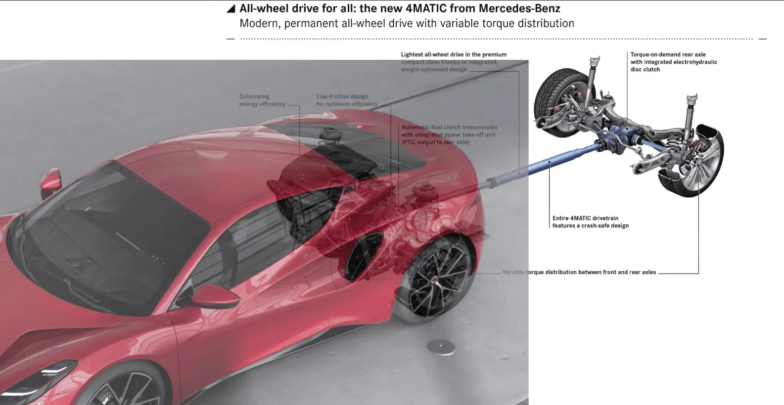

I appreciate your thorough explanation of the Mercedes 4MATIC+ system, and which part of it remains in the Emira I4 application (not much apparently).
I had indeed written that I understand very well that the Emira only has a part of this system since it is a mid engine rear wheel drive car. What was not obvious to me is that the rear wheel drive Emira I4 actually utilizes the front wheel drive portion (with the open diff) of the A45 S, and that the rear wheel drive Emira I4 does not have the output shaft to the rear differential, and indeed does not have the rear differential from the A45 S at all.
