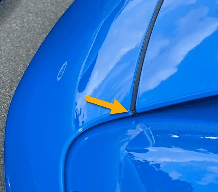

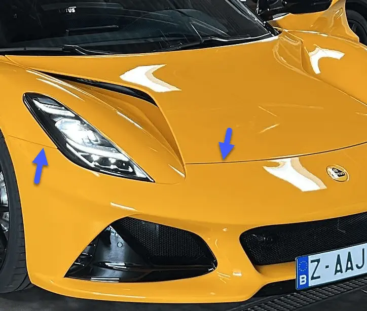

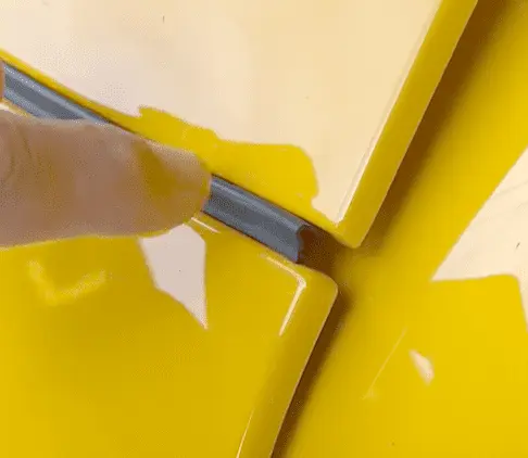

Based on the pics shown here of recent builds, it appears that they changed the type of seal entirely after Goodwood.
This new production (or near production) spec looks pretty good to me... the seal is present but minimized visually, and the side junction where the bumper meets the fender panel is straight and tight.
This looks fine! It's far more reasonable. And there's absolutely no way, in my opinion, that this is the same design as what they showed at Goodwood. The new style one on the blue car below is a capped U-shaped design, with an L shaped section at the top that bridges the body gap and a U shaped section below it that crushes with pressure between the two panels but remains squeezed between them to locate and support the L-shaped cap strip from below.

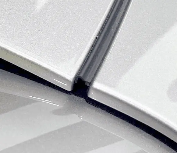

Compare that to the seal shown at Goodwood on the yellow car below (from Pav's video) which is a simpler L profile, but oriented in a completely different way, with the front-facing arm of the L creating a curve upward to a ridge, and the back side of the L sitting against the hood panel to locate it. This is filling the (very wide) gap without any "crush" of the seal in any way. This type of seal would make far more sense if the panel gap was tighter, and the front-facing arm of the seal was folded down so the seal was "captured" between the two panels like: |/\| - rather than |ā—ā‹|
Another view of the Goodwood seal, brightened up to show the weird non-utilized foldable profile.
Altogether, I think the new design is a big improvement.

That's some dedication to rubber strippage 🤣
I likey though. Good analysis and read šŸ‘

There's someone more obsessive about tracking the details than me! Great work on this, seal-jÅ«dan šŸ™
