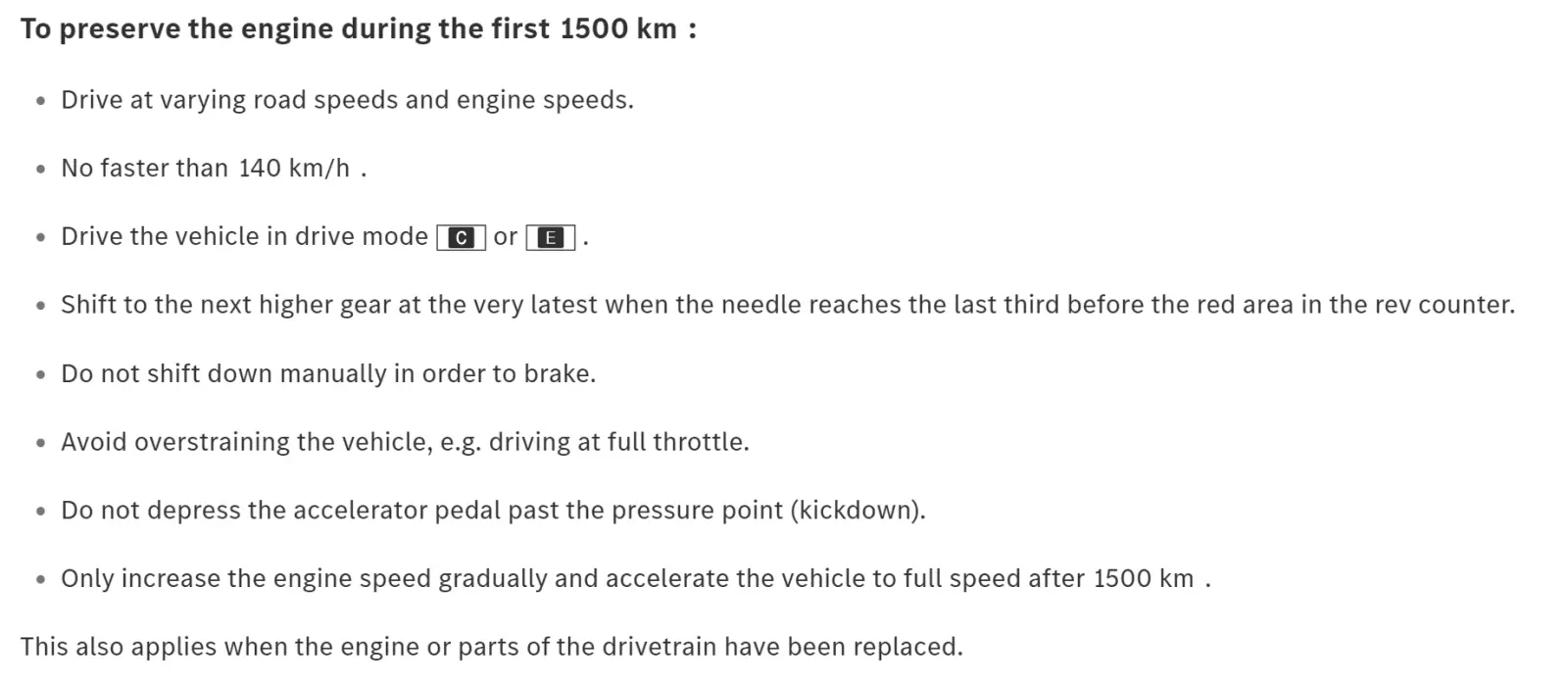

Out of interest I looked up the running in procedure for the A Class (and by extension the A45S). Mercedes say that only the Comfort or Eco drive modes should be used during the running in period. Definitely worth bearing in mind for those of us who have got / will be getting the Mercedes engine.
