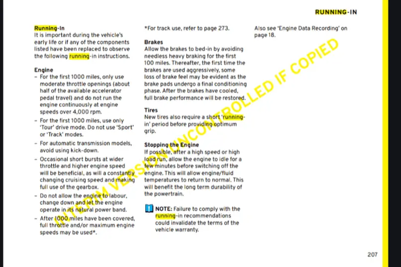

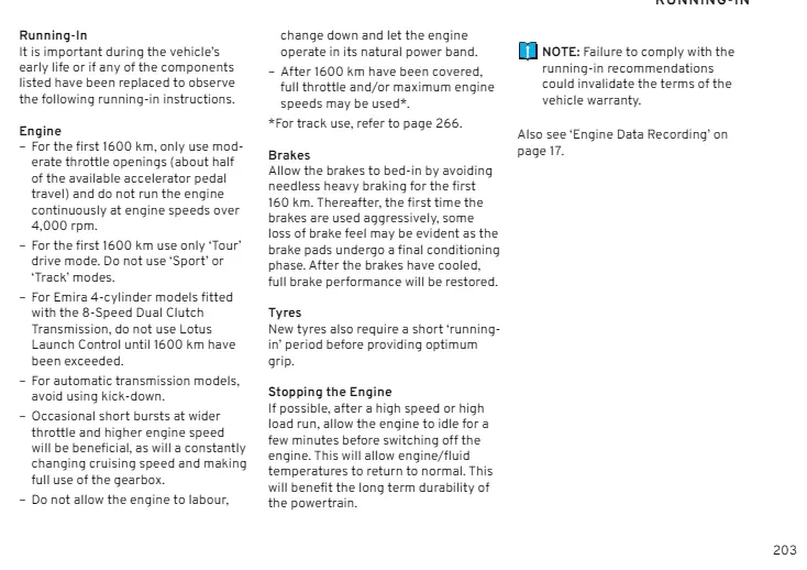

EDIT: Found it on page 203 of the owner handbook (which only seems to be found online and not actually in the car itself):
This is page 207 and 18 of the US manual.

This is the interim uncontrolled US version. But the wording is the same as the current May 23 GB version.

The way I read the first 1000 mile runnin in period is to not constantly be above 4k rpm’s and do not use full throttle . It doesn’t say never go above 4k.
It says occasional bursts at wider throttle will be beneficial. I plan on going over 4k occasionally during the first 1000 miles just not mashing the gas pedal to redline.

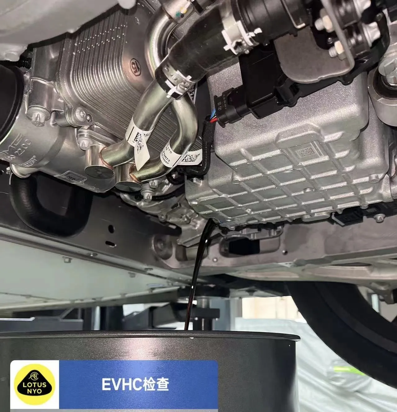

On my I4, I just did an oil/filter change after run in and after I’d done about 200km using the fulls revs/throttle (1800km, ~1150 miles). The oil was pretty black, very happy I swapped it.
