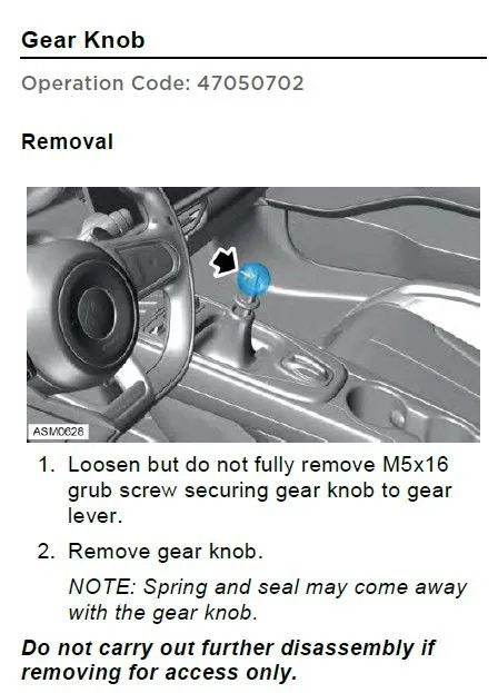

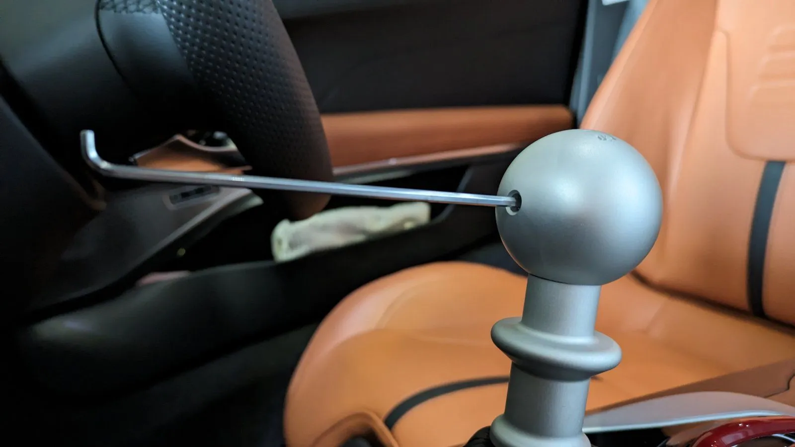

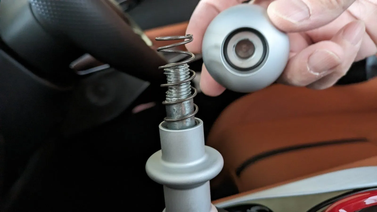

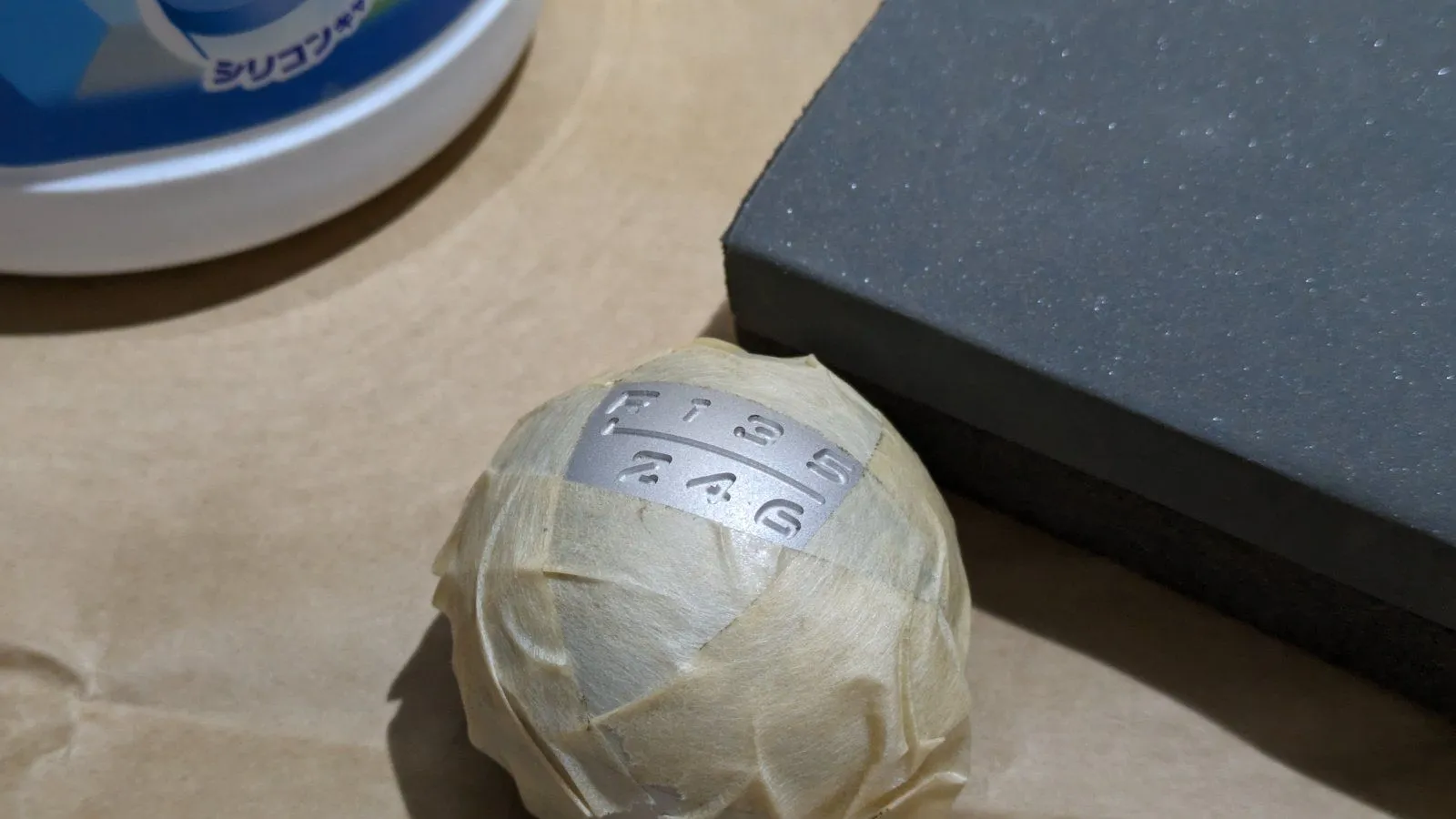

I was able to fix it this morning. The gear knob is screwed on to the lever, and a grub screw prevents it from loosening. The following is an excerpt from the Service Notes and an actual picture of the knob.
ギヤノブの取り外しは簡単です。ノブはギヤレバーにねじ込んであり、回り止めにイモネジが1本入っているだけです。サービスマニュアルの該当部分と実際の写真を添付します。
Removal of the knob is a simple 10 second job with the right size allen wrench. Make sure you don't lose the spring and seal (in my case, the black O-ring stayed inside the knob).
イモネジは緩めるだけで完全に抜く必要ありません。中のバネとOリングを無くさないように注意。
Wipe off the blood, and mask the rest of the knob to prevent any unintentional damage. Mask both holes to prevent water from getting in. I had some #600 sandpaper handy, so used that under the bathroom faucet.
血液はキレイに拭き取ってから周りをマスキングします。水研ぎする際に水が入らないようにレバーの穴とイモネジ部分もマスキングしておきましょう。参考までに、手元にあった600番の耐水ペーパーを使いました。バリの大きさにもよりますが、1000番でもいけたと思います。

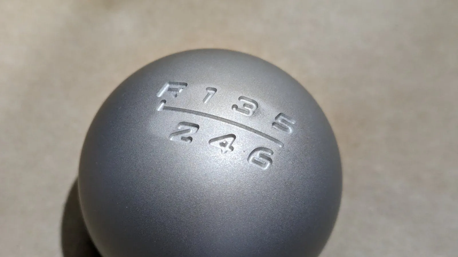

In my case, the triangle inside the "4" and the finger-like shape pointing into the "6" were the most damaging sections. A few seconds of wet sanding and it's now at an acceptable level. Note the discoloration of the sanded section. I don't think the knob has been painted or anodized - sanding will remove the thin layer of oxydation, but it should grow back in a few days.
私の場合は「4」の中の三角形と「6」に入り込んでいる鋭角な部分を削ることで手の平への攻撃性はだいぶ弱まりました。むき出しのアルミなようで、研磨することで部分的に酸化被膜がとれてビミョーに色が変わっているように見えますがしばらくすれが分からなくなるでしょう。
At least the bottom areas of the numbers are finished. I've seen some put black paint in the long line, and red in the R which looks pretty good. I'm thinking I'll do something like that with mine, or maybe even get a custom wooden or leather shift knob made. Glad it's easy to remove and replace.
View attachment 33872 View attachment 33873
Wipe off the blood, and mask the rest of the knob to prevent any unintentional damage. Mask both holes to prevent water from getting in. I had some #600 sandpaper handy, so used that under the bathroom fawcet.

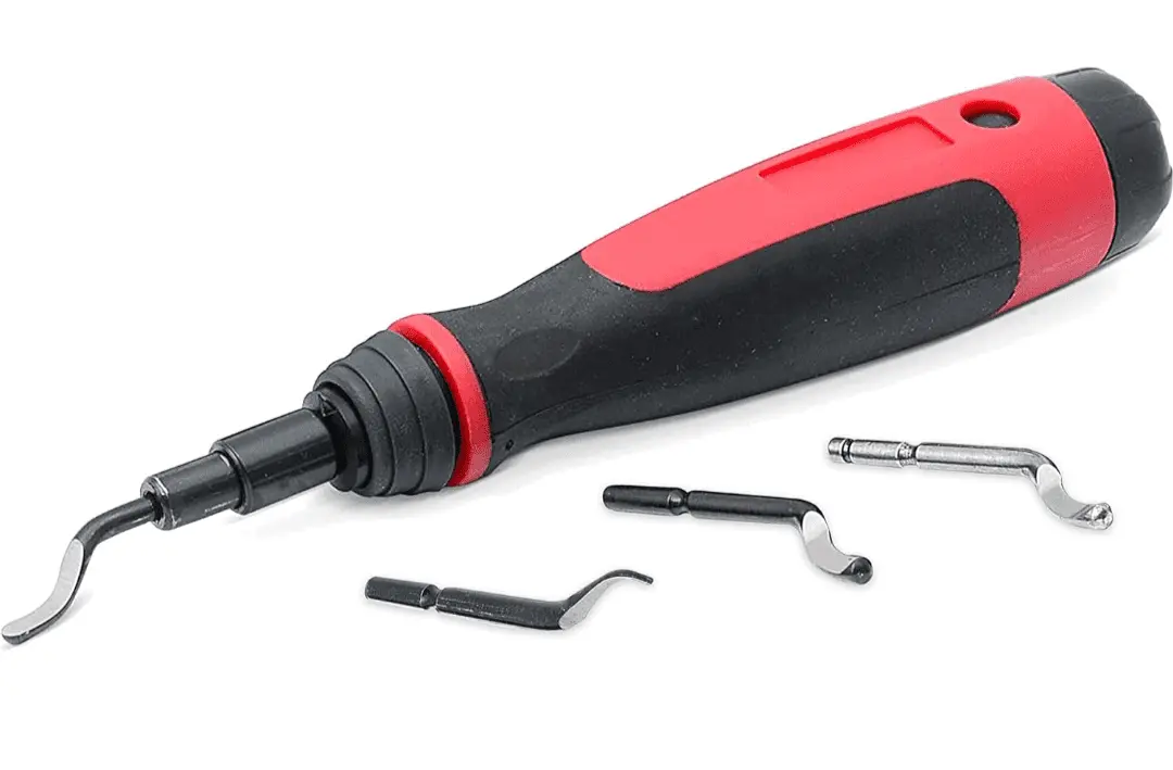

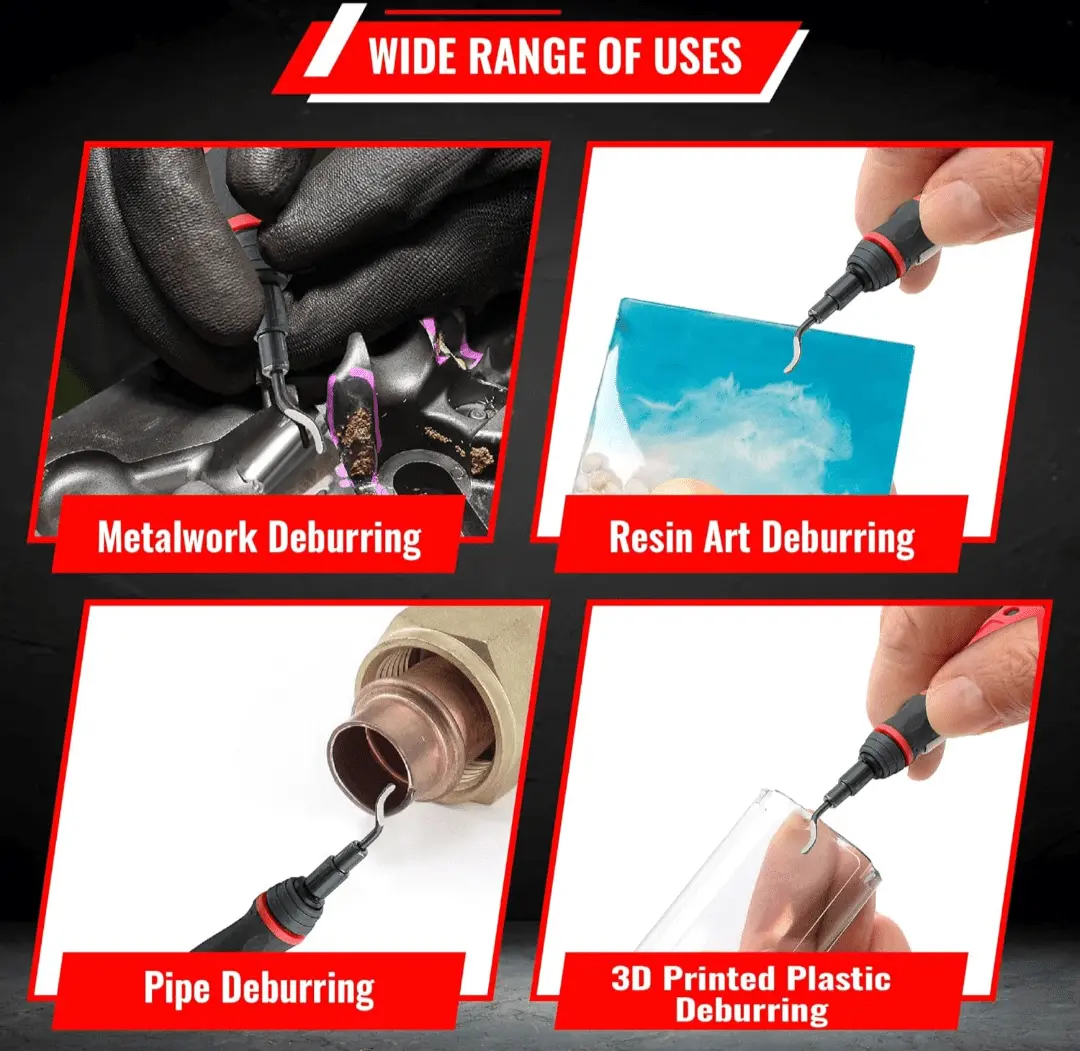

Seems like it would be easier to just lightly chamfer the cut edges with a deburring reamer pen. The smallest blade in this set should do the trick, just work it circularly in each number void until the sharp edges shave off enough to no longer cut your hand.
Deburring Reamer Pen set (Amazon)
Yes, definitely a better choice for the mission if you had the tools already. I just used what I had handy.
(BTW, the link points to a DC-DC converter on Amazon)
Should be fixed now. The forum did something very weird with the link.
It was this item:
AFA Tooling extendable neck deburring tool $11.99
You would need a kit like this one that includes a very small blade, most are 2.5mm+ but the Emira knob engraving relief would need about a 1.5mm tip. This specific one does.
I'm sure something very similar exists on Amazon Japan if this particular item is not available. Japan has some excellent specialty tool manufacturers.

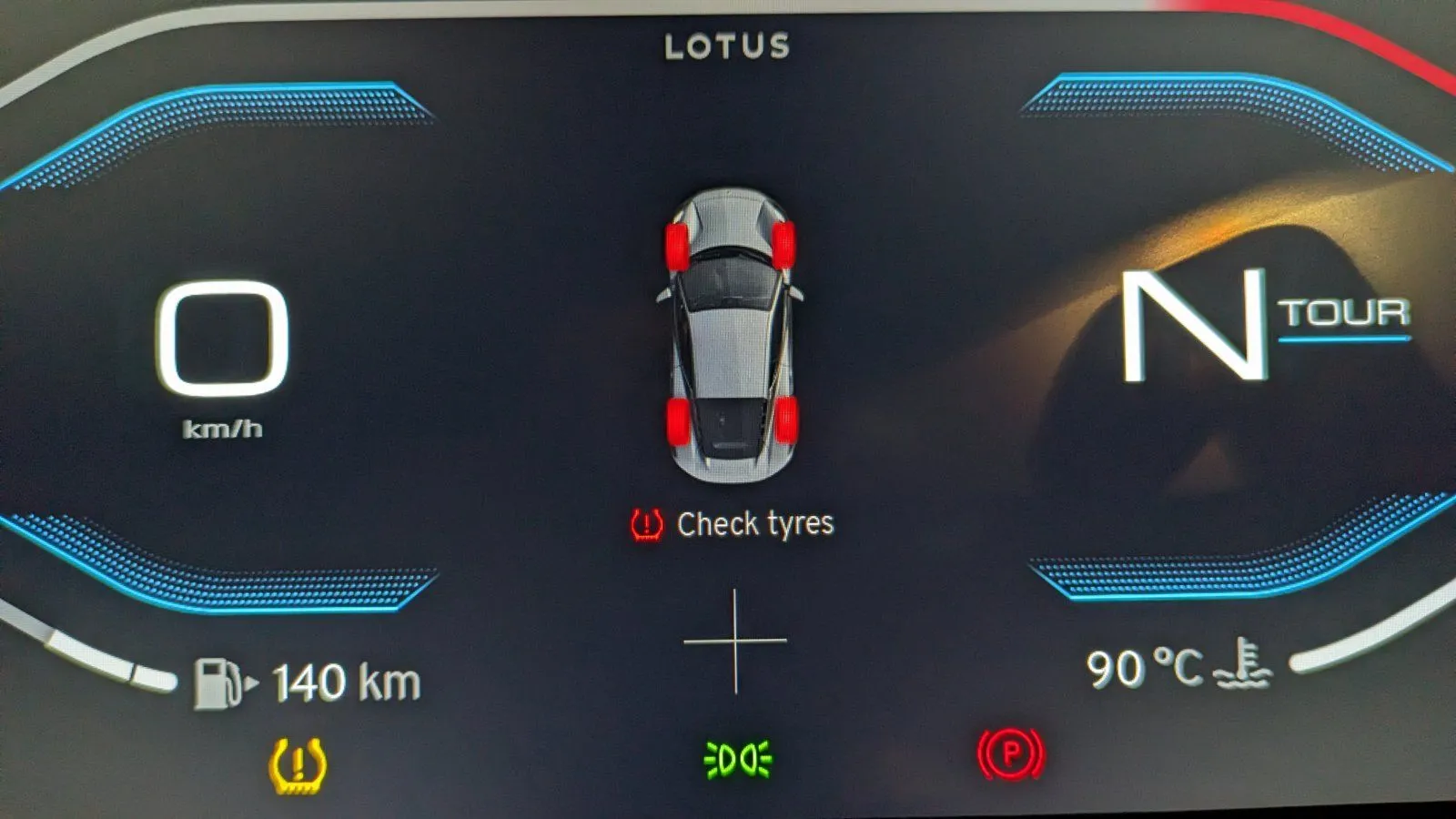

Just got a Low Tire Pressure warning on a system without TPM !
こりゃびっくり!w
