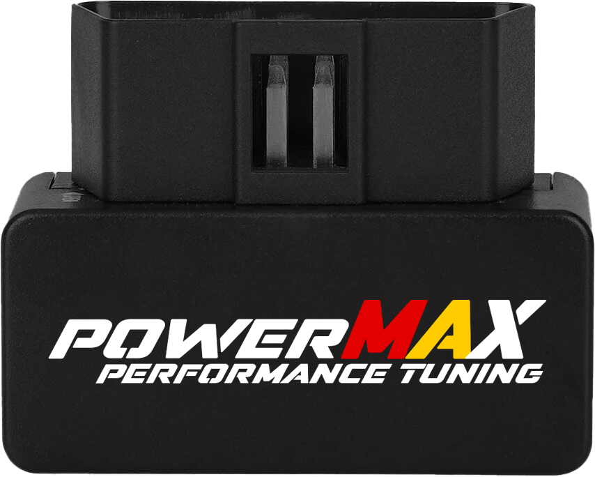

Aside, Think this is real?
ECU's MUST BE SENT TO AMT TUNING TO BE FLASHED
All sorts of odd items out there-
