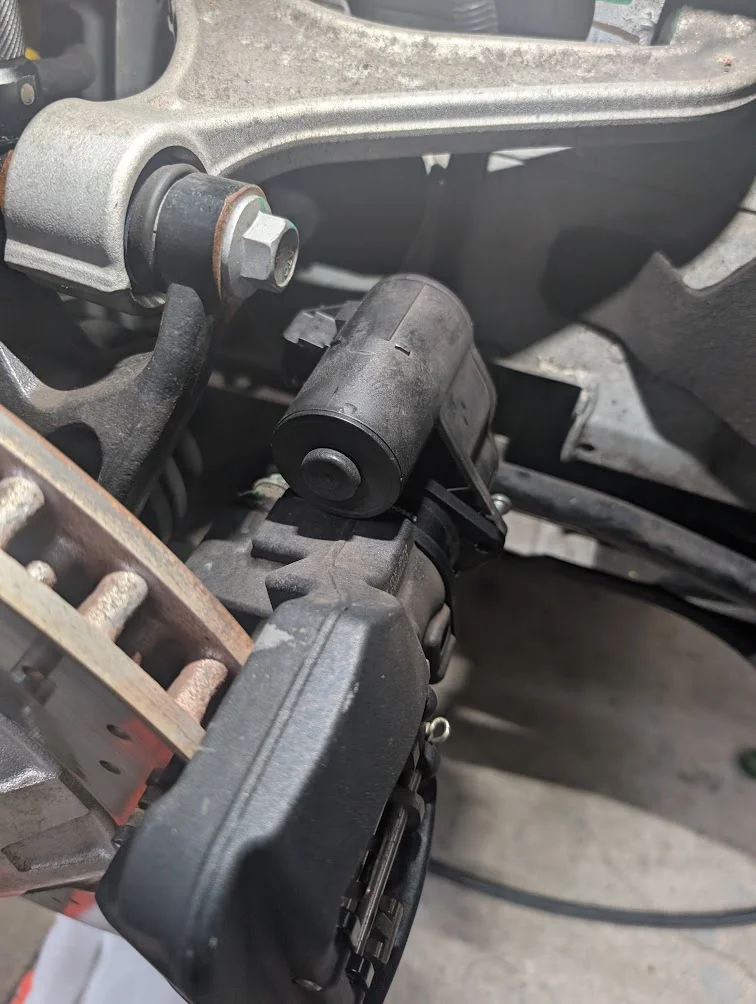

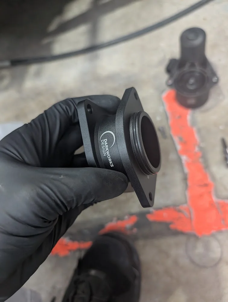

This inexpensive fix is what’s needed for the parking brake to accommodate 18” wheels
Yes, they work brilliantly. I currently have these installed and it works great!

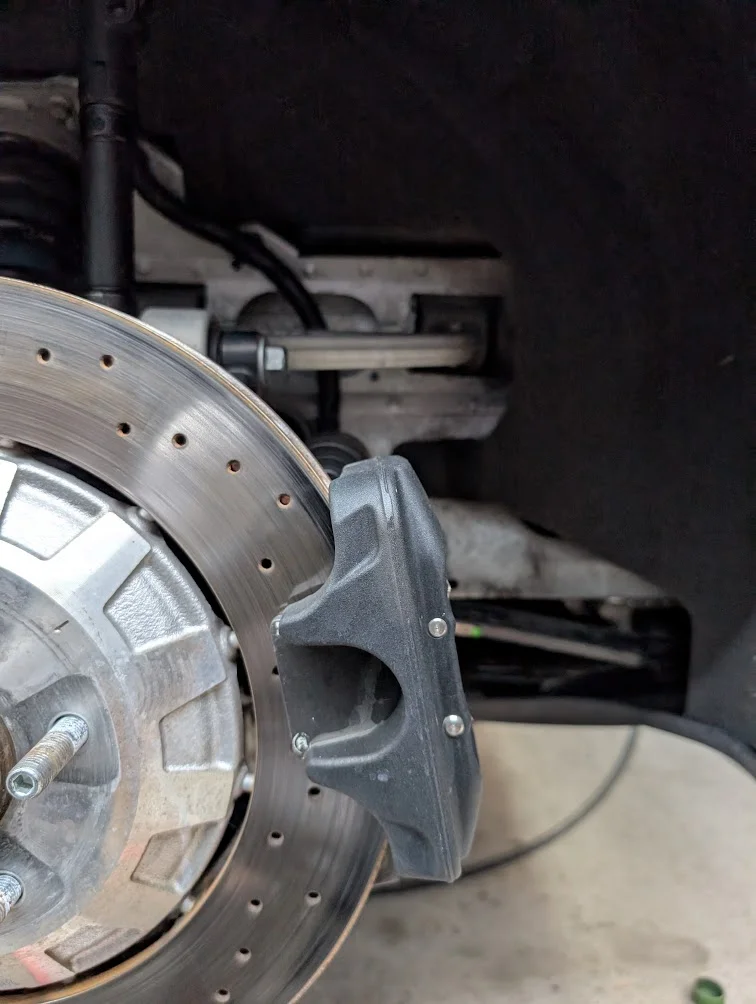

Keep in mind that some 18" wheels that are cast and not optimized for big brake clearance may still not fit with 18" wheels. Pretty much all the forged ones will -- and anything cast and optimized for track use like apex.
Do you have 18 or 19? Which wheels have you gone for
I have some 18's coming. Working with BSPK for something custom to ensure clearance and fitment. The front caliper setup is going to be real tight, so I suggest working with your wheel mfg to spec out the barrel.

There are some nice tires available in those sizes! I've ordered the parking actuator adapters and I'll likely be buying 18"'s soon!

I simulated the clearances and based on the width & offset I chose, I believe I will lose ~5.6-6mm of steering lock (inner barrel will rub the UCA 6mm before full lock is reached). Noting human measurement variances as I don't have a jig to measure precisely.
Front Brake line holder that's bolted on the UCA will also need to be relocated as that's showing to interfere with the inner barrel.
Valve ridge area is going to be tight with the brake caliper, but John @BSPK was able to make it happen.
As these will strictly be my track wheels, I was willing to accept these conditions to acheive the objective.
I would advise that anyone looking to go down this path, make sure to spec out your wheel barrel dimensions for confirmation. Assuming any 18" wheel will fit likely will cause potential headaches, YMMV!

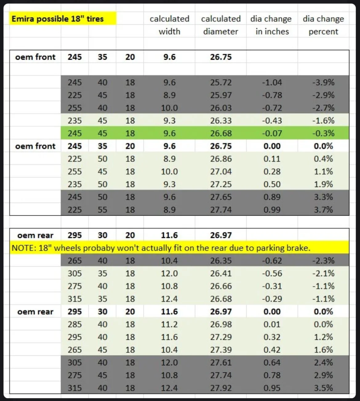

The plan is to have a significantly smaller rolling diameter than factory? To reduce ride height and gearing?
My main objective is being able to run track focused tires that were not available in 20" and/or significantly reducing consumable costs for tires.
Have slightly more sidewall, reduced ride height, and smaller OD are additional tools available for tuning.
I get that is the main reason for running 18s. I will probably do the same at some stage as I’m currently changing my Emira into a more track focused car. I’m just stating that if you run 18s with the 35 or 30 profile tyres you mentioned above, that the ride height and rolling radius will be much reduced.

Or did you mean to state profiles more in the 40 or 45 range?

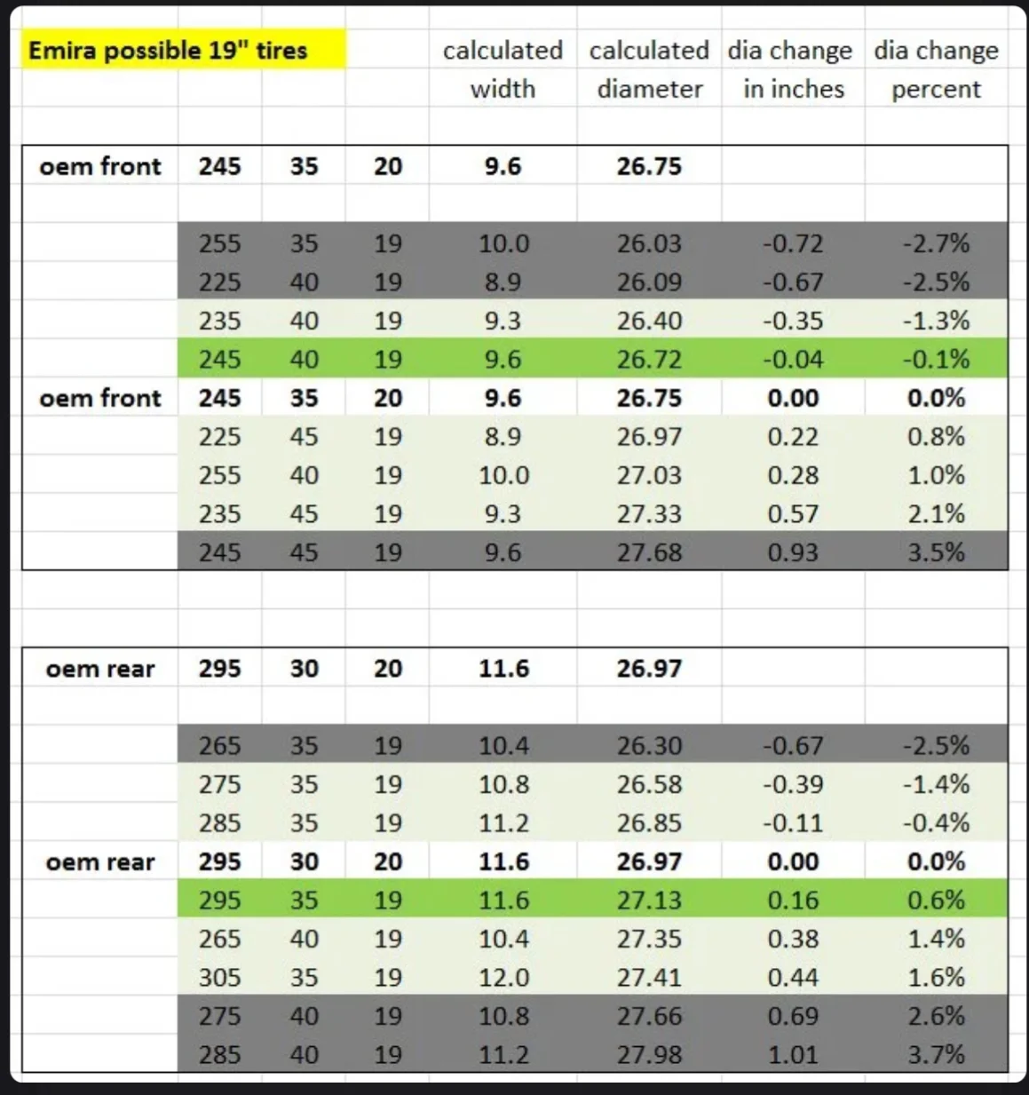

Copied these calcs from another thread
Yes, the ride height and rolling radius will be reduced. The widths that I will be running will be in the 35/30 ranges
