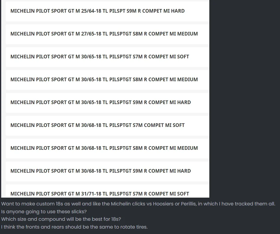

Are you using slicks? If so, which brand, diameter and width? What are your wheel offsets, widths, etc?
depends on what is available when i buy...
CRS v2/RE-rz are the tires im planning on running. Still waiting on stock to come back on CRS since its been on my try list for some time.
