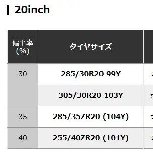

Wait, you guys get A052 in Emira sizes in the US?
245/35R20 and 295/30R20 not available in Japan...
