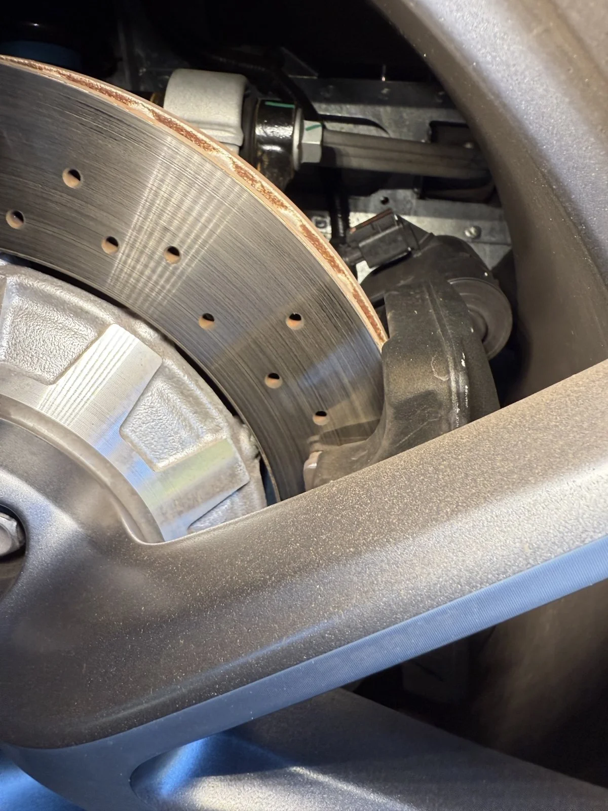

I don't have my car yet, and haven't been able to find a pic of the offending item- anyone have a pic?
What type of parking brake did the Evora use?
Here's a pic of the offending item. Notice how close the motor housing is to the inside of the OEM 20" wheel.

Here's a WIlwood electric parking brake caliper with the motor that looks like it protrudes less. Maybe this or something like it could inspire modifications to the Emira unit, or maybe even replace it. Obviously, design work would be required to adapt a different caliper.
That's almost exactly what the Emira uses, just the black cylinder hanging off the bottom of the wilwood unit is more like clocked to be 'outside'.
