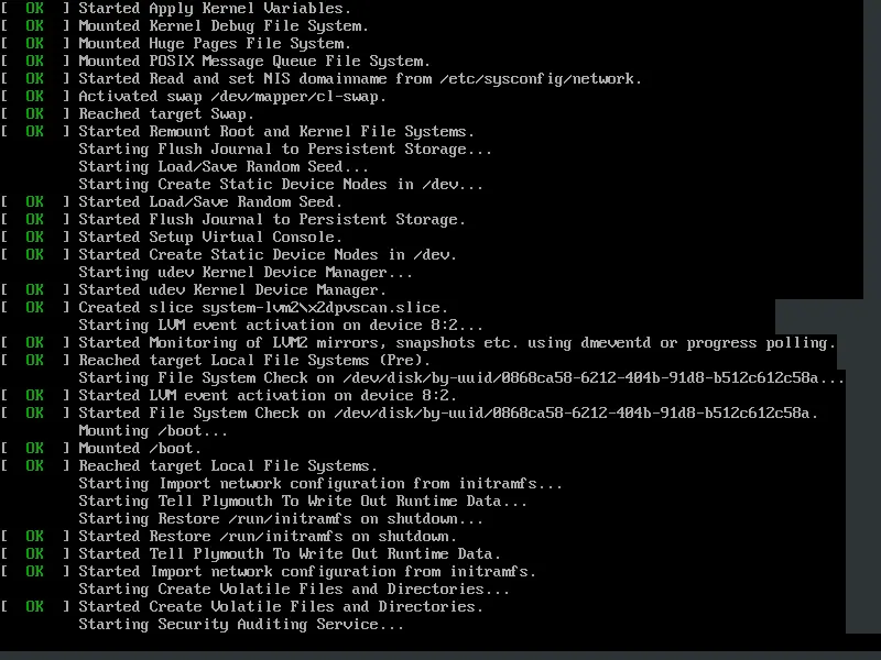

Are we seeing something like this on the dash for a split second when starting the car?
So the issue might be because everything is fscked...?
Exactly. I'm pretty sure someone told it to "sudo make them a sandwich" right in the middle of getting fsck'd, and it responded by echoing a mem right into /sys/power/state and then rolled over and went to bed angry.
