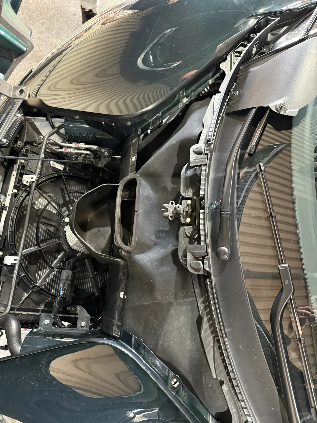

I checked mine yesterday, boy it was cracked everywhere, I put tons of duct tape to hold it together for now. Cant wait!

Hi folks!
I found a manufacturer that can cut EPDM (basically fancy, durable rubber) sheets to my specifications.
These sheets are used to replace the low-quality "Water Membrane" that Lotus installs, which are keen to disintegrate. They are installed to prevent water ingress on the expensive HVAC
electronics under the front hood. My design spans side to side instead of just covering one half, so you're fully protected.

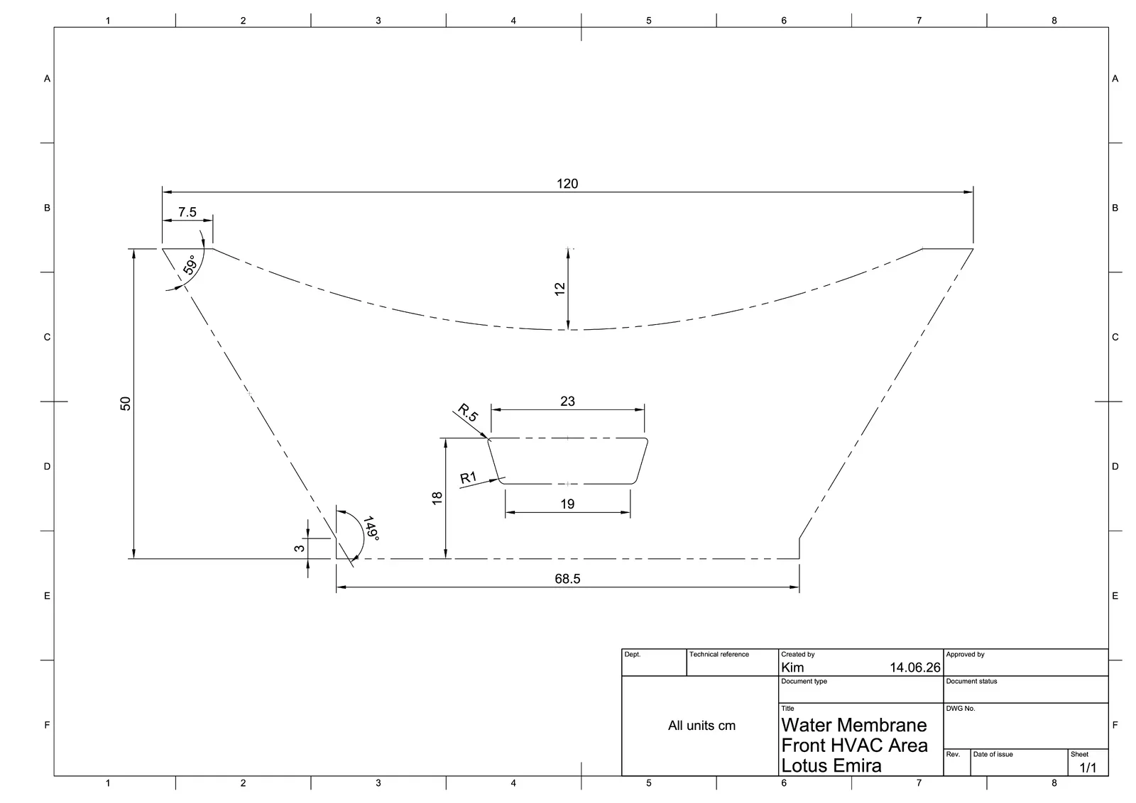

Thanks so much for the diagram. I’m guessing all measurements are centre meters. Do you have a final pattern yet?

Here's the technical drawing so you can get an idea. It'll be slightly adjusted and redrawn to scale for the final design, however:
And my test sheet installed:
