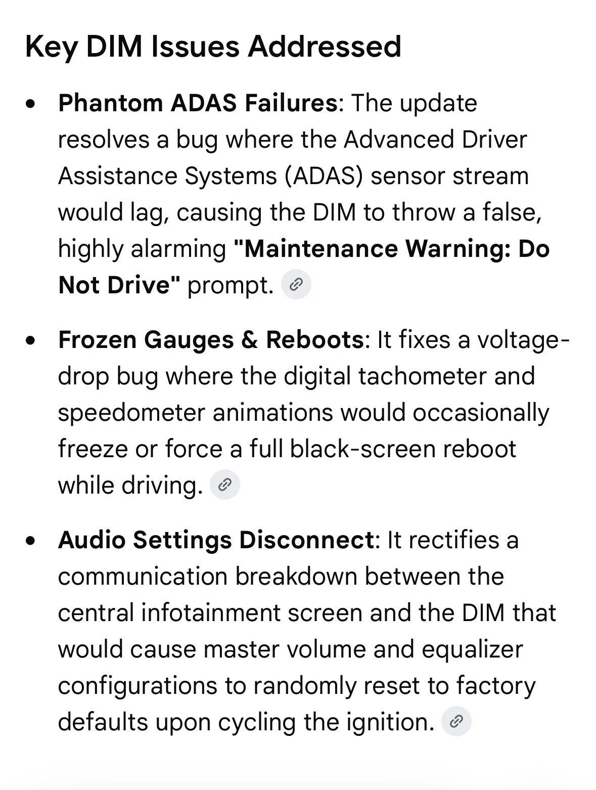

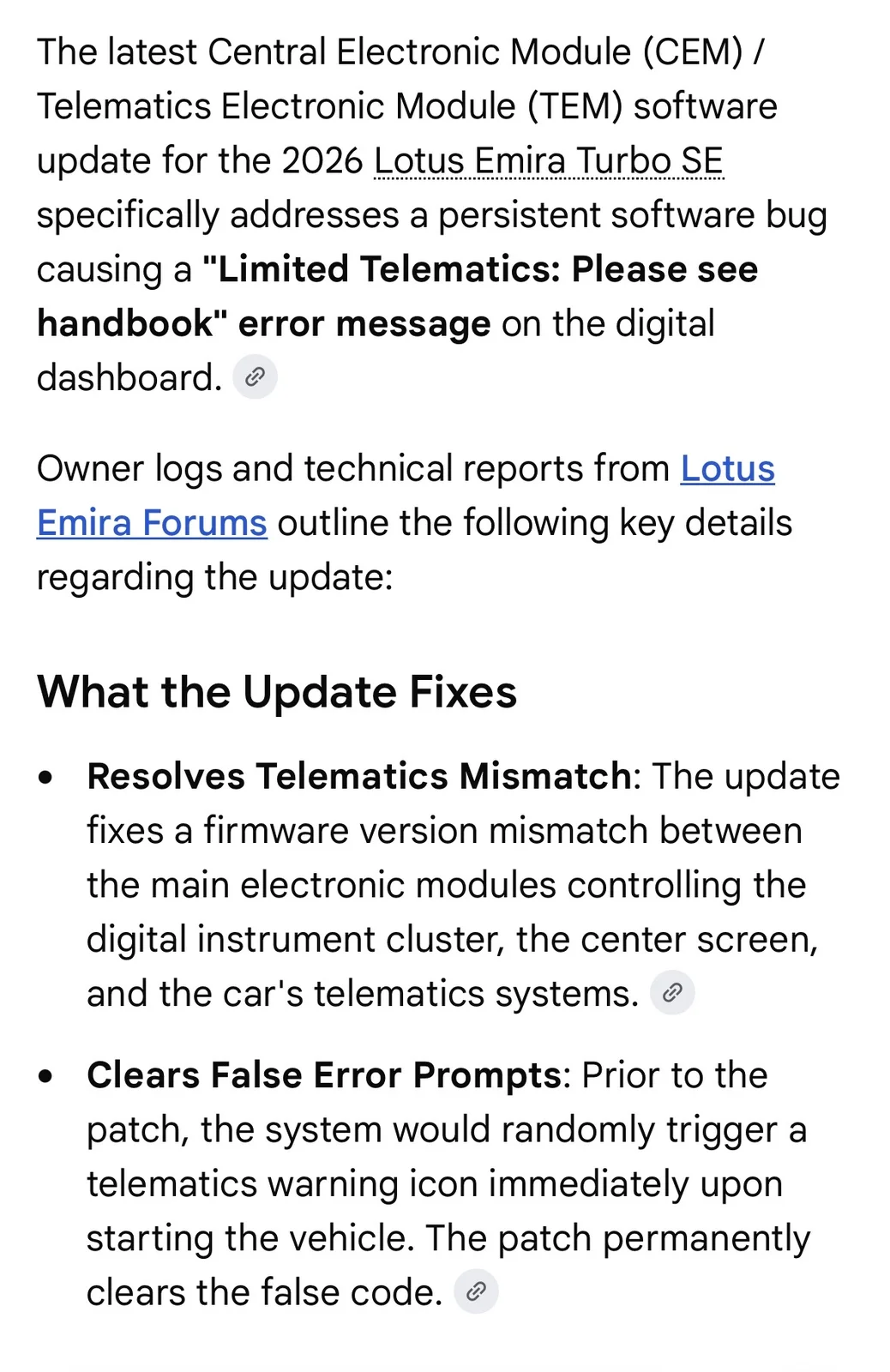

To help address some of the questions about when updates may have been released, I bought my car in Feb of this year...it is a 2026 i4, and I just picked it up from the dealer. They installed the aforementioned CEM (Central Electronic Module) and DIM (Driver Information Module) updates. So it is safe to say these were released in the past 6 months.
I came straight home via the highway, so I haven't had time to dive into the changes… maybe someone else has with these two updates.
That last one, is the one we have all been waiting for.
