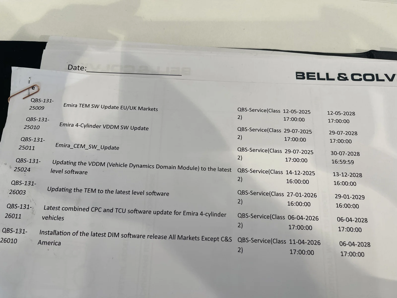

Do you have a service code on your invoice for the DCT update that was applied?
I had my 2024 i4 FE serviced yesterday at Bell and Colvile in Guildford, UK. I grabbed a quick snapshot of the software updates that were applied. In all honesty there were no obvious differences on the drive home. However, I found the manual shifts were already fairly snappy before the updates so I don't think there's much room for improvement now.
Just had the recent updates done to my i4 in Australia. Didn't get to push it too hard on the way home, but the biggest difference was I'm now getting way more pops and crackles in Track. Not sure why. Sounds angry.
I had those last 2 installed on my I4 last week, as a possible help to resolving limited telemetrics error. The issue turned out to be a low voltage on the TM battery(allegedly resolved by a previous update). However since the 2 updates, I have noticed moving from neutral to Reverse, or Drive, or from Reverse/Drive to Drive/Reverse is a lot quicker than it was previously.
Hoping this is not just my imagination.
