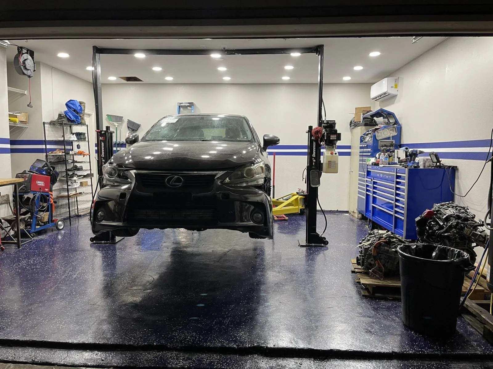

I typically do my own maintenance but not sure if I would do the clutch on new Emira.
Here is my garage. I think I got the tools to do it ;)
