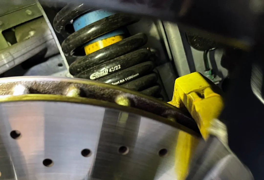

You can get under the car or turn the wheels and check out the springs. They'll actually say sport or tour on them.. Or maybe it's a sticker on the shock body... I forget to be honest, but it's clearly marked on the suspension. 🙃 Maybe someone else can confirm.

In the rear, I think you can check the description of the spring through the wheel gap.
