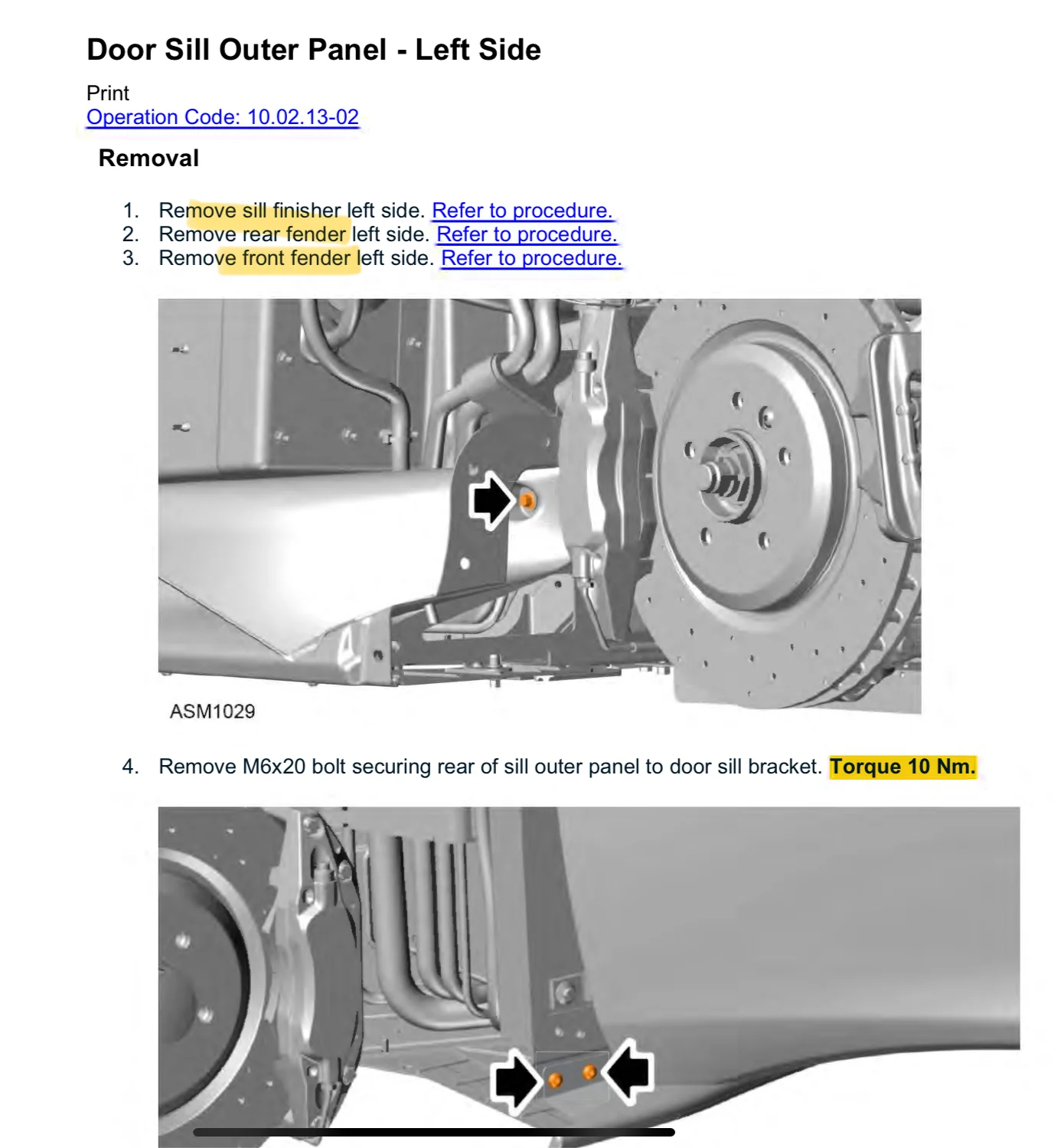

Am going to swap out lower side sills on my car, I believe the lower door sill has to come off to gain access to some of the fasteners underneath. From my understanding the Emira aluminum scuff plate that covers the fasteners is held on with double sided tape- what’s the best way of removing it without damage other than dental floss or .020 safety wire. Thanks
