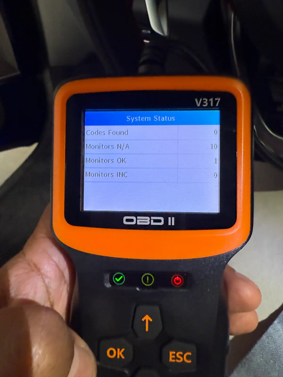

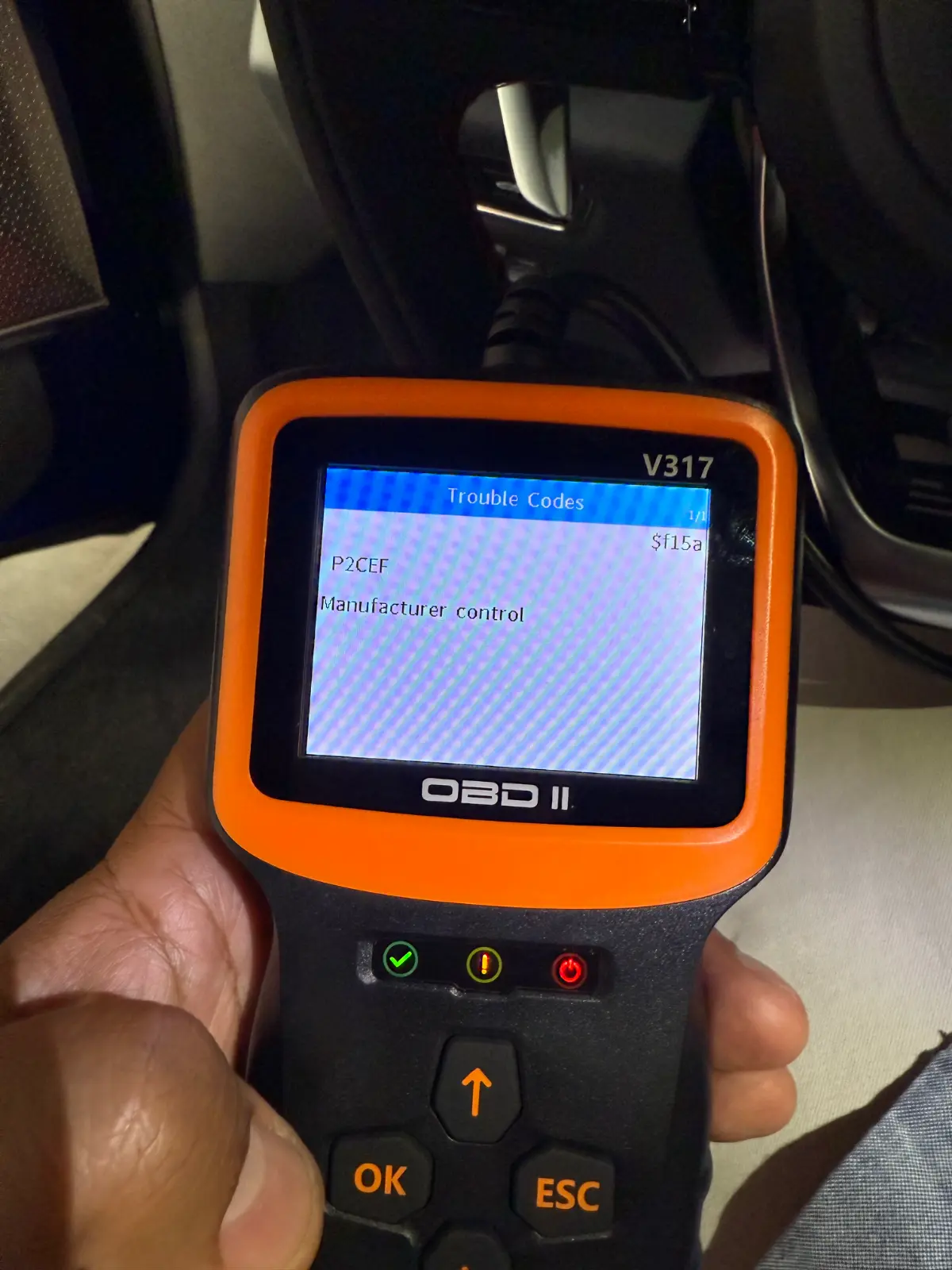

Got the car back today. They replaced both thermostats. Not sure if they did a flush. Within a mile the CEL came back on. Service tech was off today. Lotus of DC only has one tech I believe. Ran the OBD scanner and it says 0 codes but the old P2CEF code still showing. Is this a false code that was never cleared since the scanner read 0 codes?
My 2c, if the CEL came back on, take it back to the dealer and don't try to second guess if their is a problem or not.
