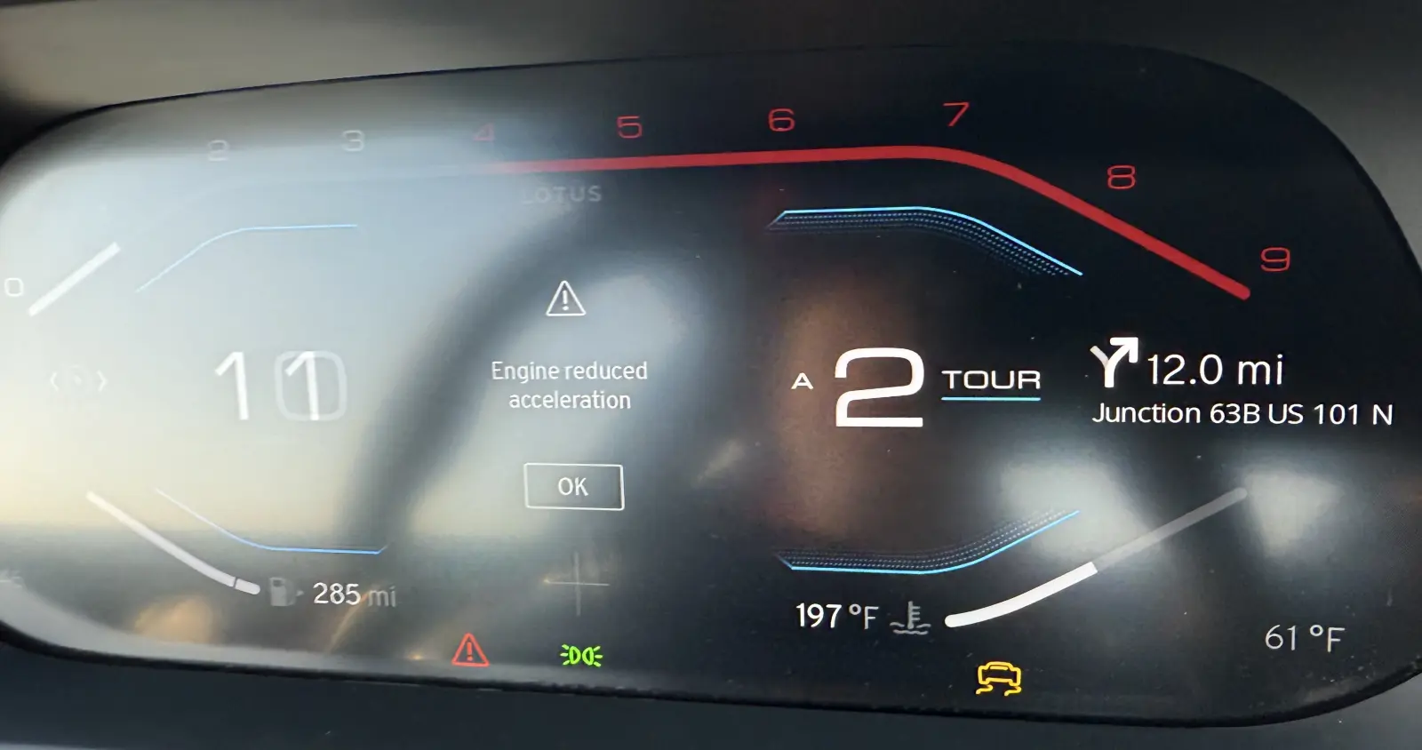

Picked up the Emira in San Diego on Wednesday, 29 January. On ~ 5-hour drive home to Santa Barbara, the car went into limp mode with the EBS (?) warning. Stopped for dinner and restarted with error message gone.
