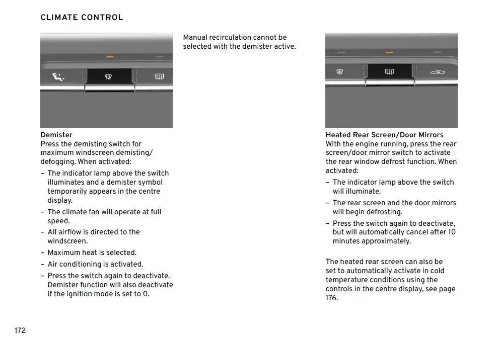

And from the manual, page 172 :

Manual says the mirrors are heated as you'd expect based on any other modern car, and they did appear to start that misting you get with heated mirrors, it just seems they were pathetic in doing so
