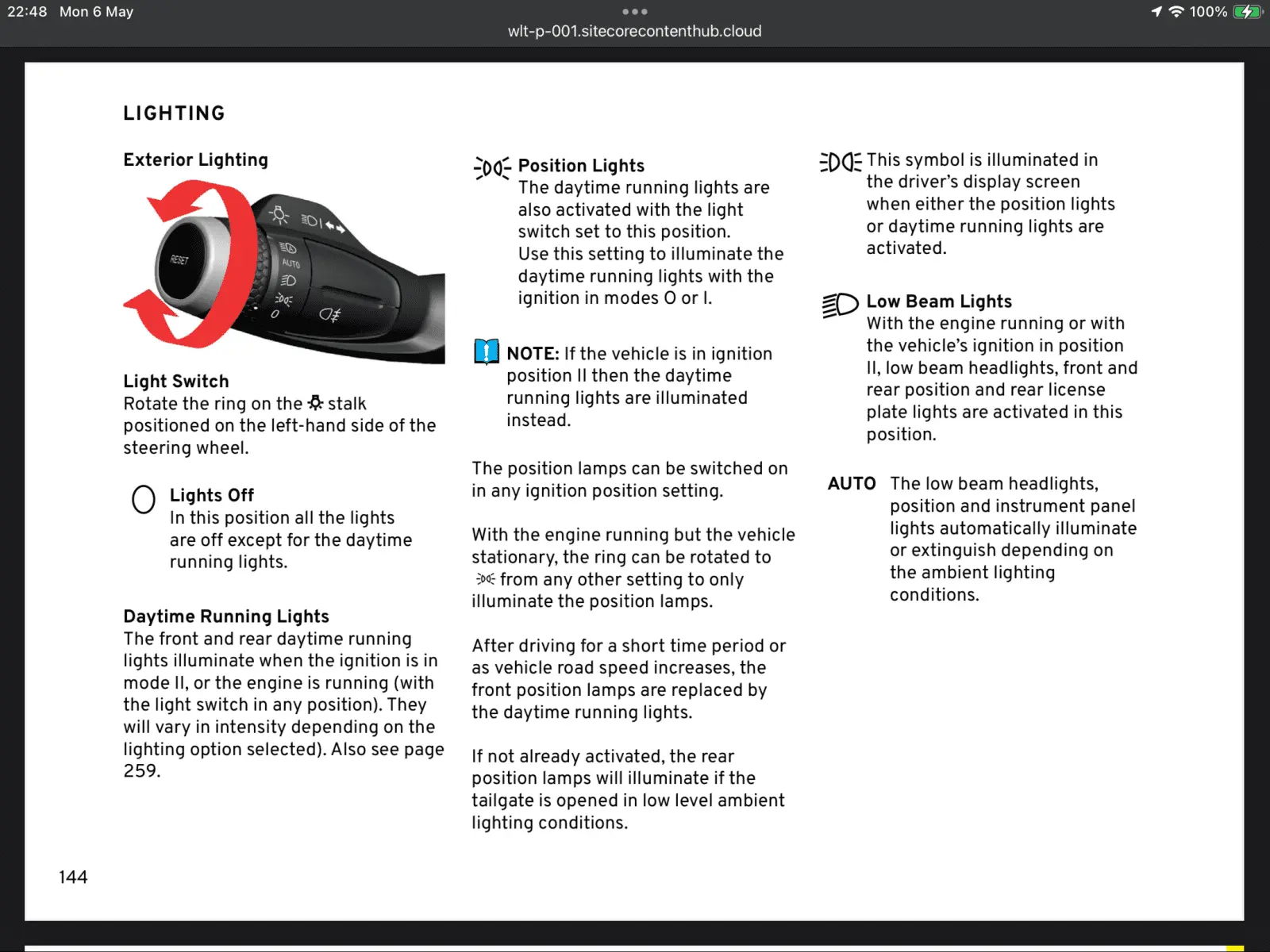

The way I read the manual the DRL cannot be turned off unfortunately . I wish they could.

That’s not the headlight symbol. It’s always on indicating your DRLs are on. Doesn’t appear to be a way to deactivate the DRLs. At least the DRLs aren’t horrible looking.
My car does the same, only ever shows DRL rather than low beams or auto despite the position of the stalk. Pretty sure all of the Emiras I have driven are the same, so some form of software issue.
