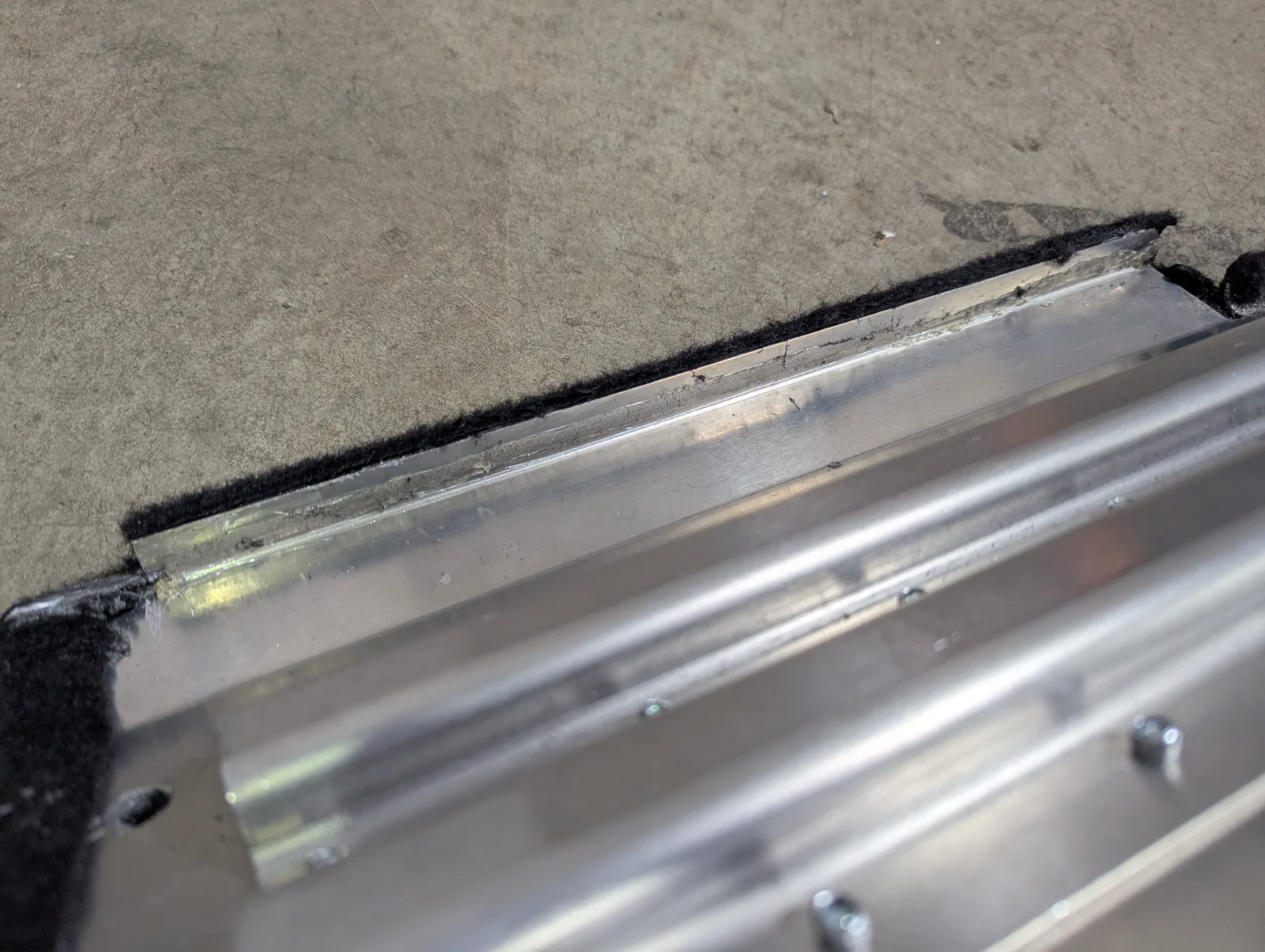

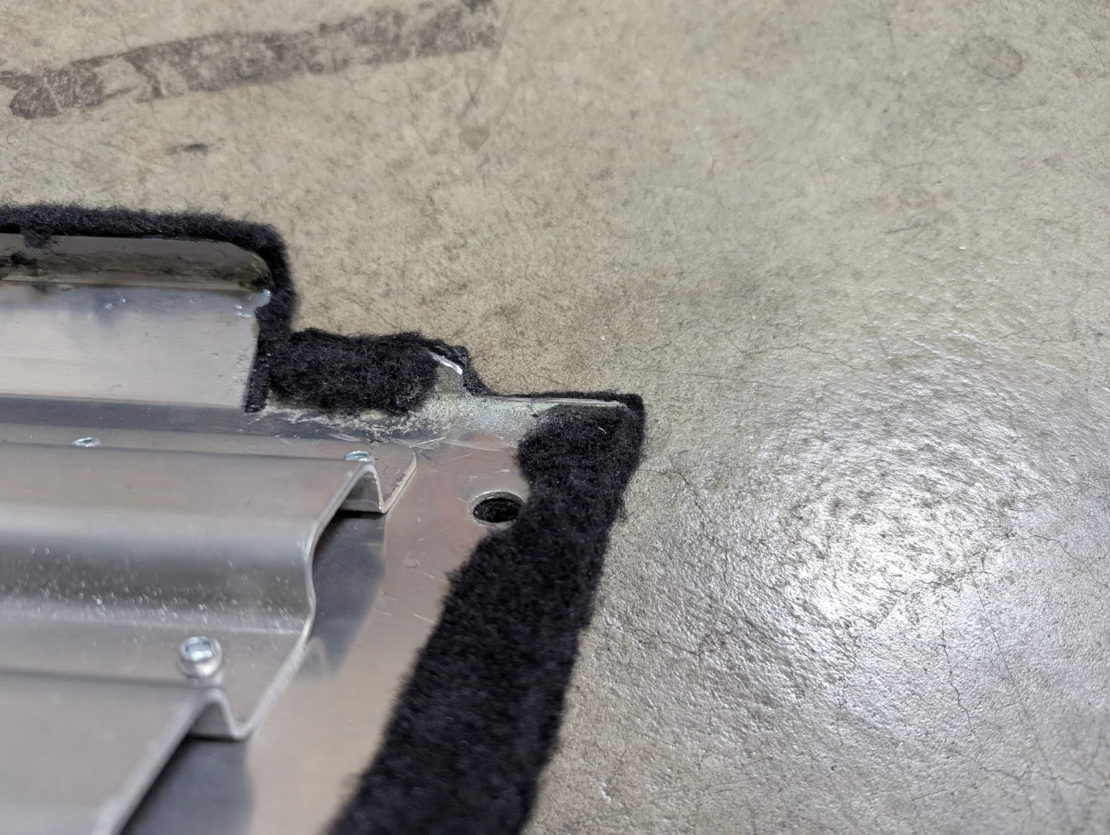

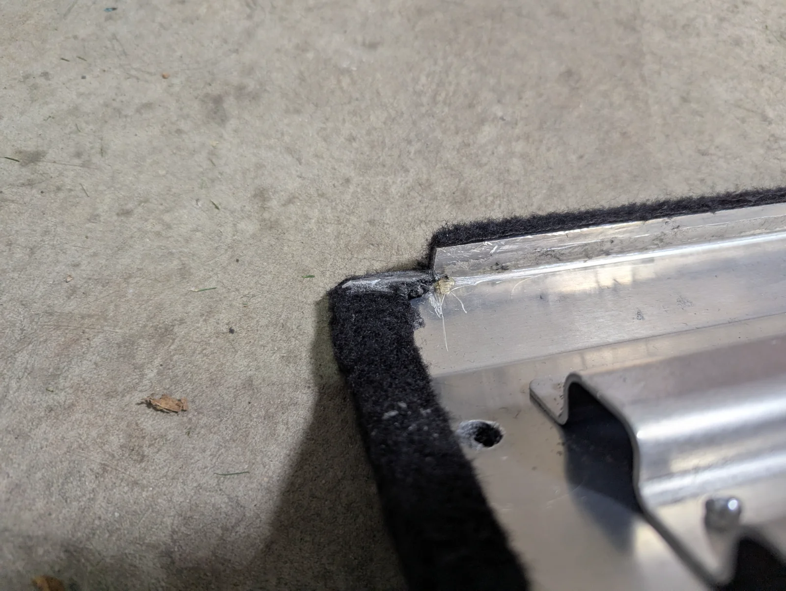

I also use this opportunity to modify the fuse cover to make it easier to remove. Next time. You can see an attached photos that I cut the corner off of the folded aluminum, and also remove the carpet from the underside lip, which makes it far far easier to install and remove.
