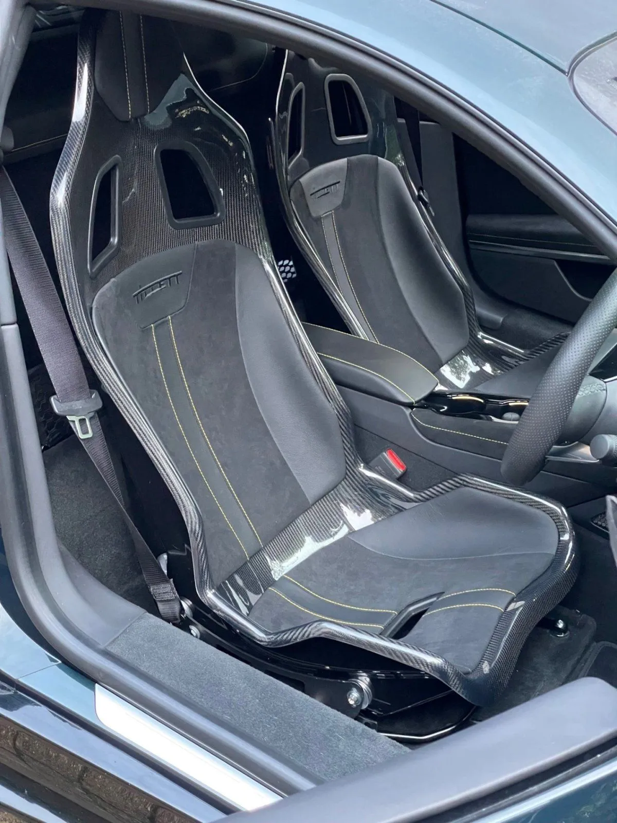

It would be very difficult. The current OEM seat controls and motors are built into the frame so there is no way of using them. Honesty, I just did four hours in my seats and I don't know why you would want to cart around the weight of the motors.
Comparing comfort, the fixed B10 XL's were miles better and I do not get the back pain after one hour, as I usually do with the original electric seats. My daughter, who is 55 kg fell asleep in the seat, so they even worked for her as a passenger.

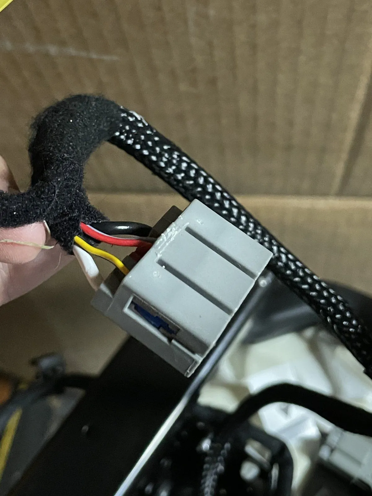

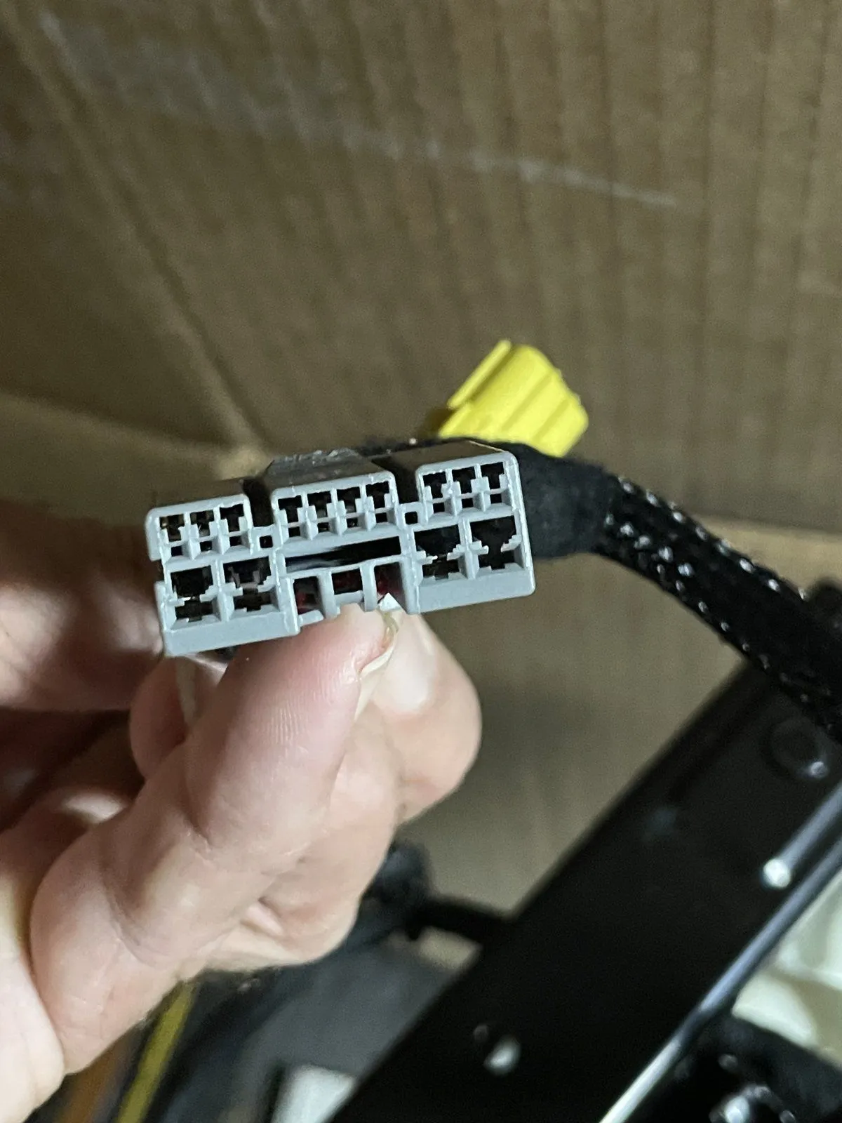

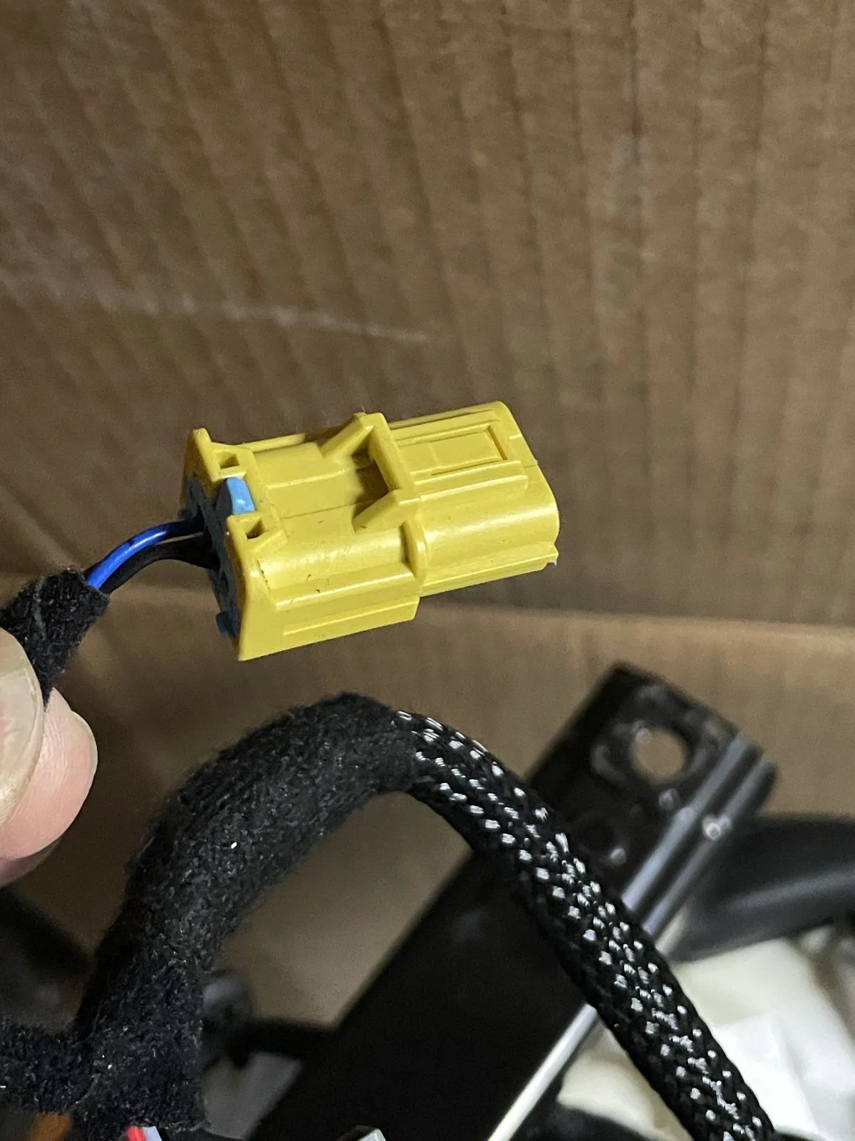

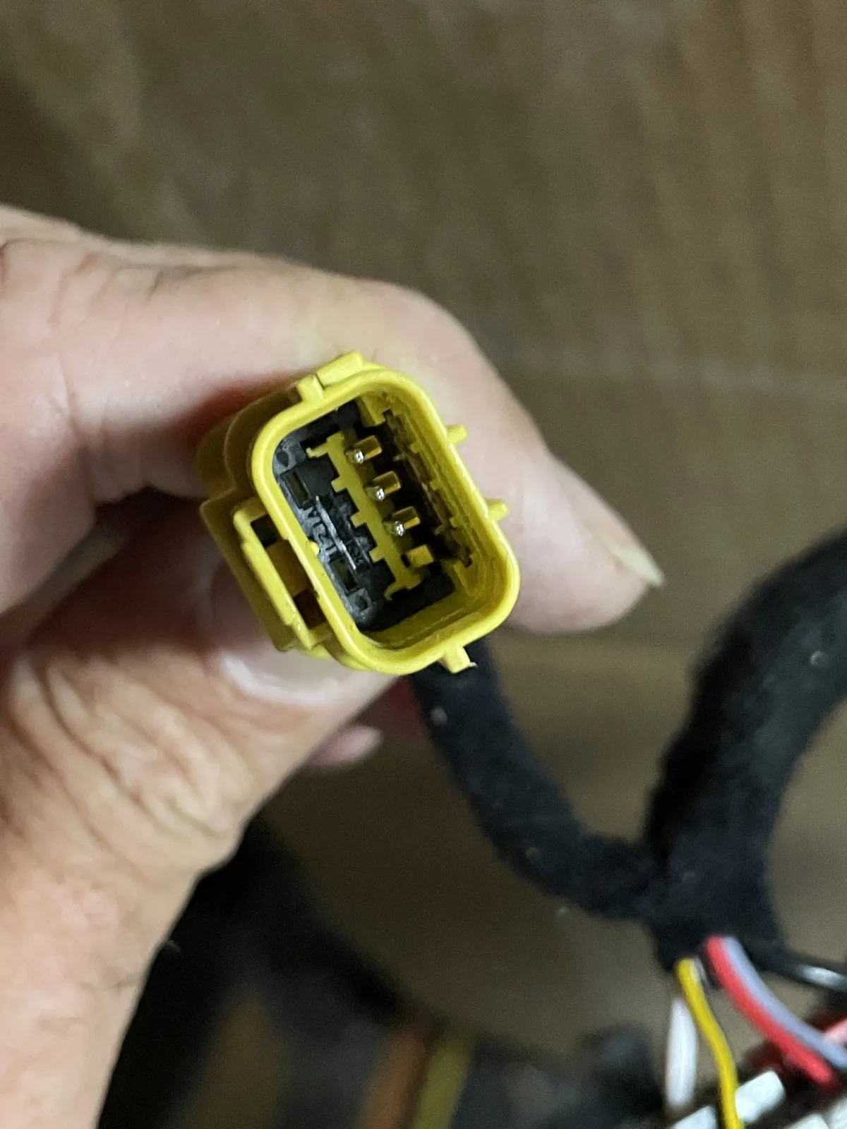

Do you have a picture of whatever electrical plug you disconnected from the stock seats? My thinking is the answer might be to get the mating plug for it and connect a few pins with jumpers, but I may be oversimplifying.
Edit: ideally a photo with a ruler held behind the plug for size reference.

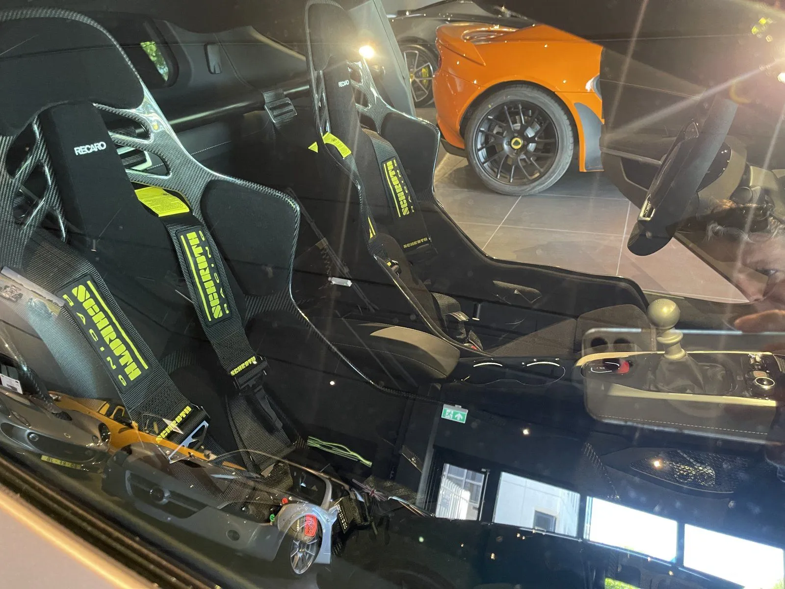

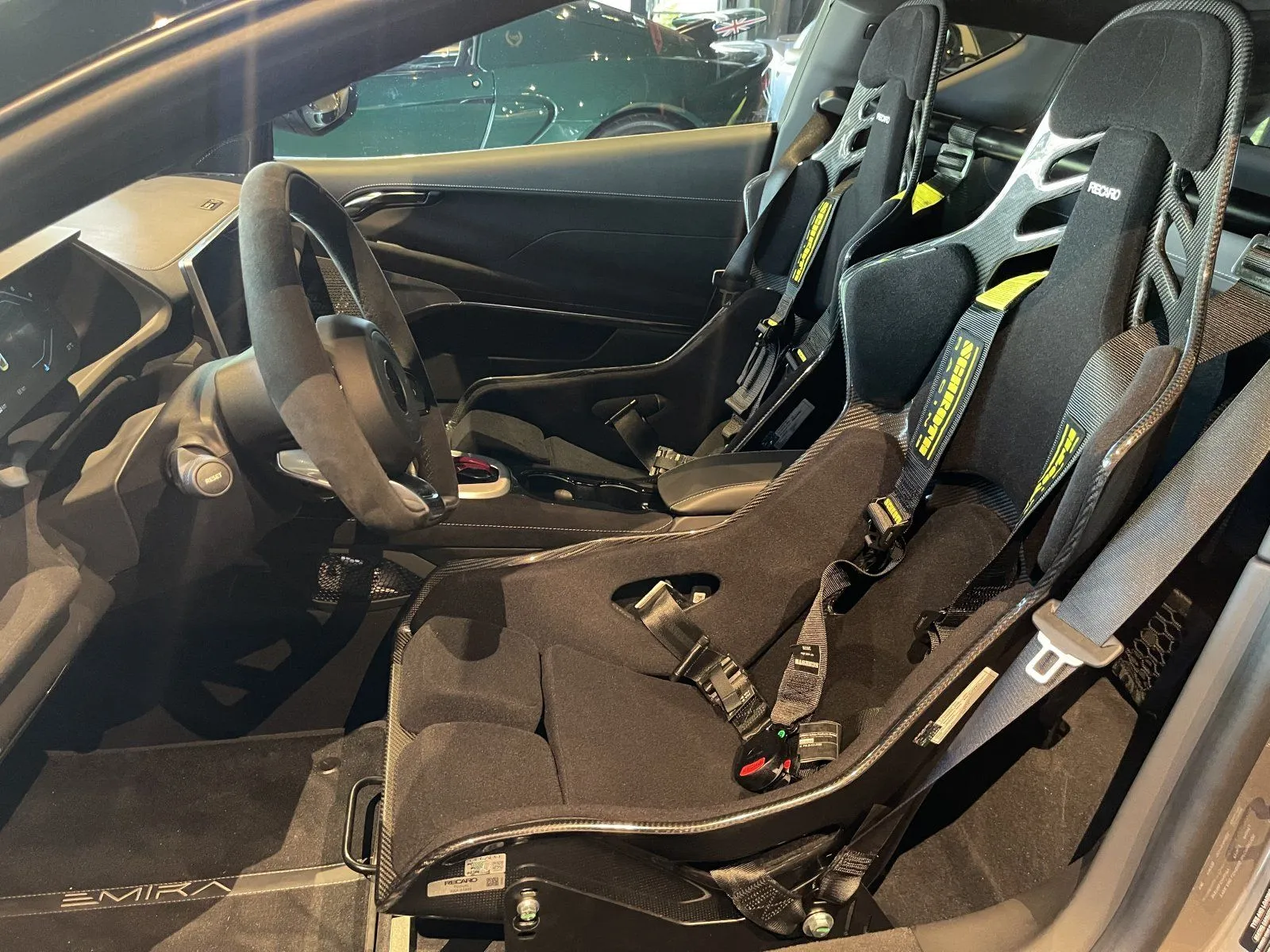

I have removed OEM seats, weighted them: 25kg each.
Accordingly mounted Carbon Recaro Podium + 4 Schroth harnesses.

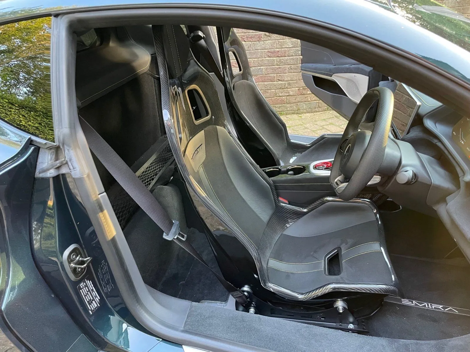

Looking at how this fits in the car... amazing the amount of room left around it. Looks to be a fantastic solution.
@Steve Tillett do you have any plans to make an XL version of the B8 seat as well? Seems like the lower/smoother thigh bolster area of the B8 would be more compatible with ingress/egress in a wide car like the Emira, particularly for passengers that aren't ultra-limber. Or are there other pros/cons at work that make the B10 more appropriate?

I just put a pair of my B10’s in with our runners and modified Elise brackets and all up with brackets, runners, custom panel set and the stock belt receptor they are 11 kg.
30 kg saved and way better support with no bad back after an hour.

The B10 XL leg support really is not a problem. My 87 year old father can get in and out without help. If he can anyone can. I use the seat every day and it is bloody fantastic in that car. I may be deemed totally and utterly bias but I am confident of this fact.
I'm still fiddling with the brackets but even these are looking good now.

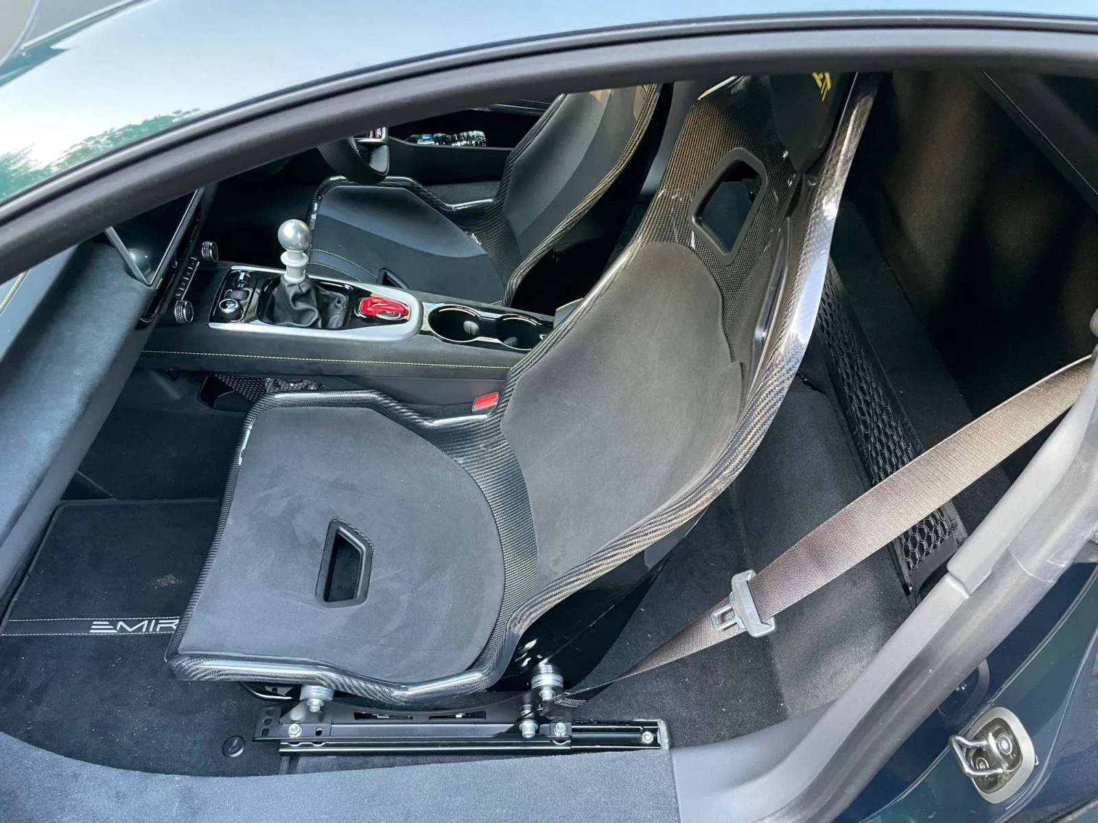

This is with the runners right forward.
These are the two plugs connected under the seat.
Sorry I forgot the ruler. I can do them again if important.
These are the plugs on the seat itself.

Interesting! Great info. So many pins on that grey plug, so few wires actually connected. I'm guessing the big black/white pair are power and ground. The yellow plug only has 4 pins total, I'm wondering if it's a serial bus or something.

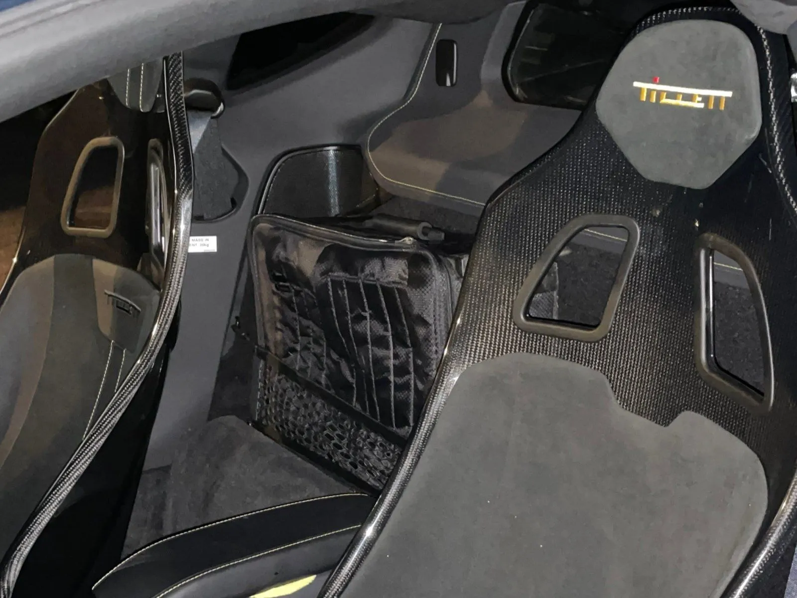

One more question @Steve Tillett : if you have one seat full forward and one full back, what's the width of the gap between them? i.e. could you fit a carry-on suitcase through the gap to stow in the back?
Easily, a regular suitcase will even fit. The seats are much more compact than the originals so there is far more space.
