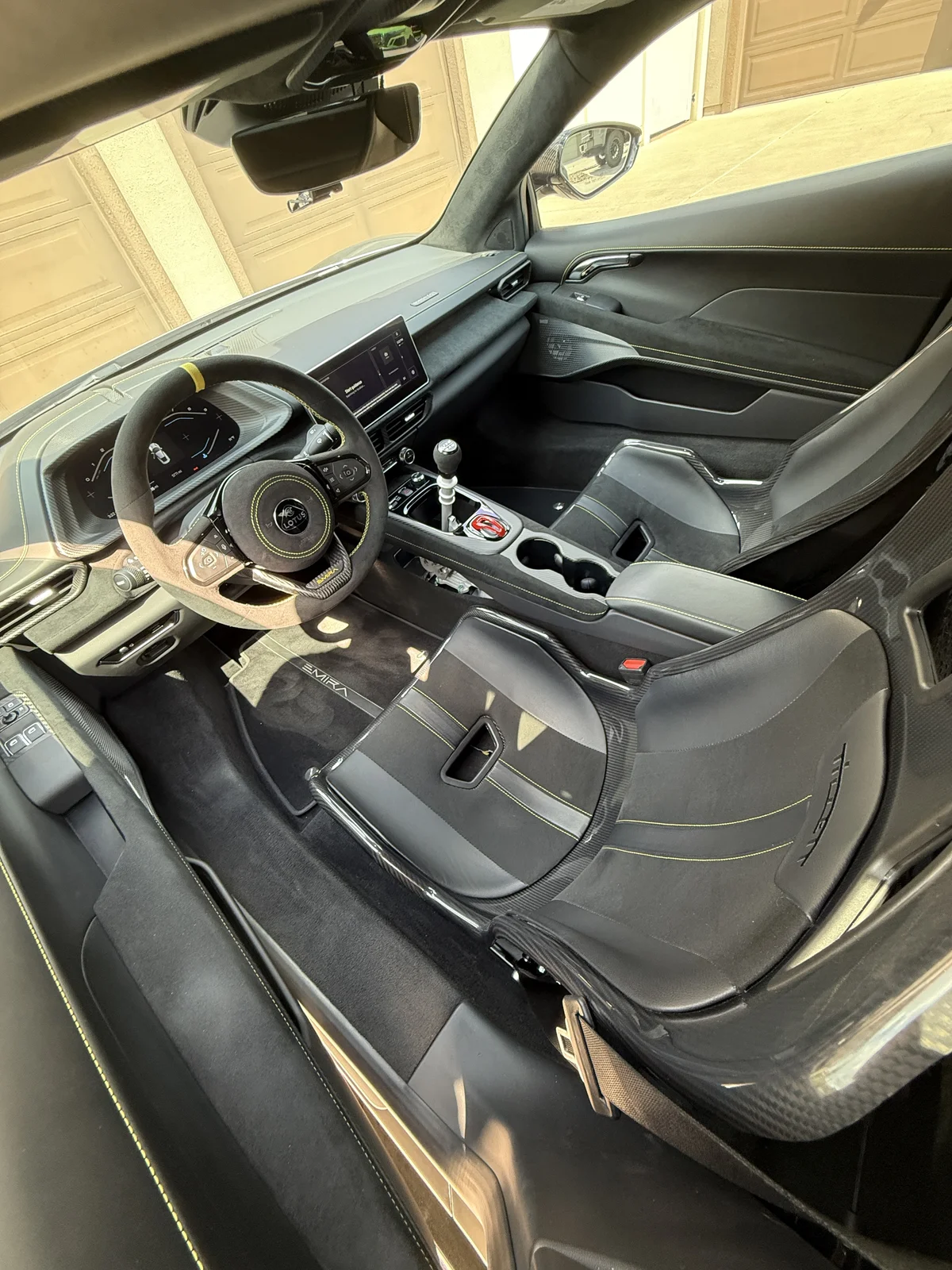

I installed some in a previous car I owned and they came stock in the earlier Evora's. They are pretty comfy and you could possibly get the heat integrated.
Mounting could pose a challenge as they are setup to bottom mount and the boltpattern wont match the floor on the Emira, so you would need to create an adapter plate most likely.

You don't need a heavy base bracket with our Emira TEMIRA1 brackets.

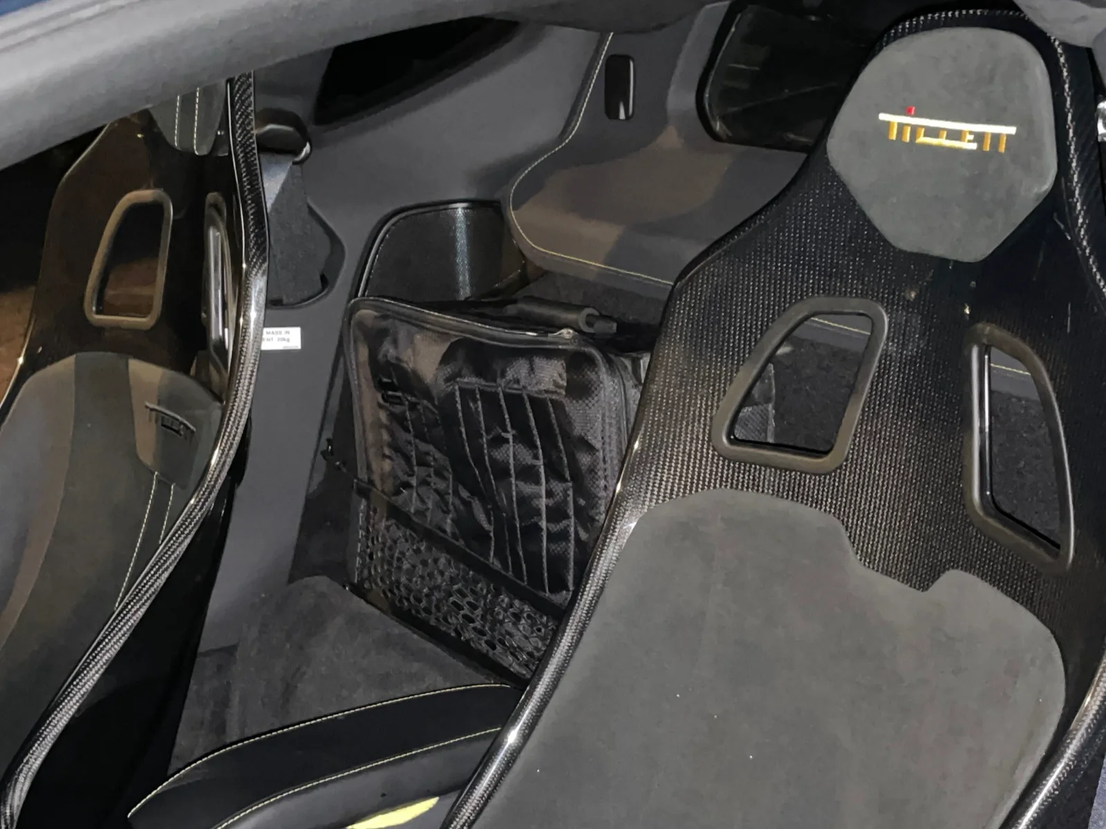

I love the look of the Tillets, but for me, the restricted access to the back shelf, the lost airbags and the seatbelt issue (if this hasn’t been fixed) stops me from ordering.
I have not had that anyone suggest there is a seat belt issue. The unplugging of the wires does not cause a seat belt audible warning. When you have the resistor plugs they make them work as normal, warning you when you do not have the belt connected. The brackets we sell have had the relevant pull test to prove the mount points are compliant.
The internal seat airbags are to stop you flying sideways. That's because the OEM seat is a flat seat. You are supported significantly better in our more race orientated seats, so you would remain located in a side impact. Restricted access is a compromise with a large hard suitcase. Small suitcases or kit bags can be passed through the centre.

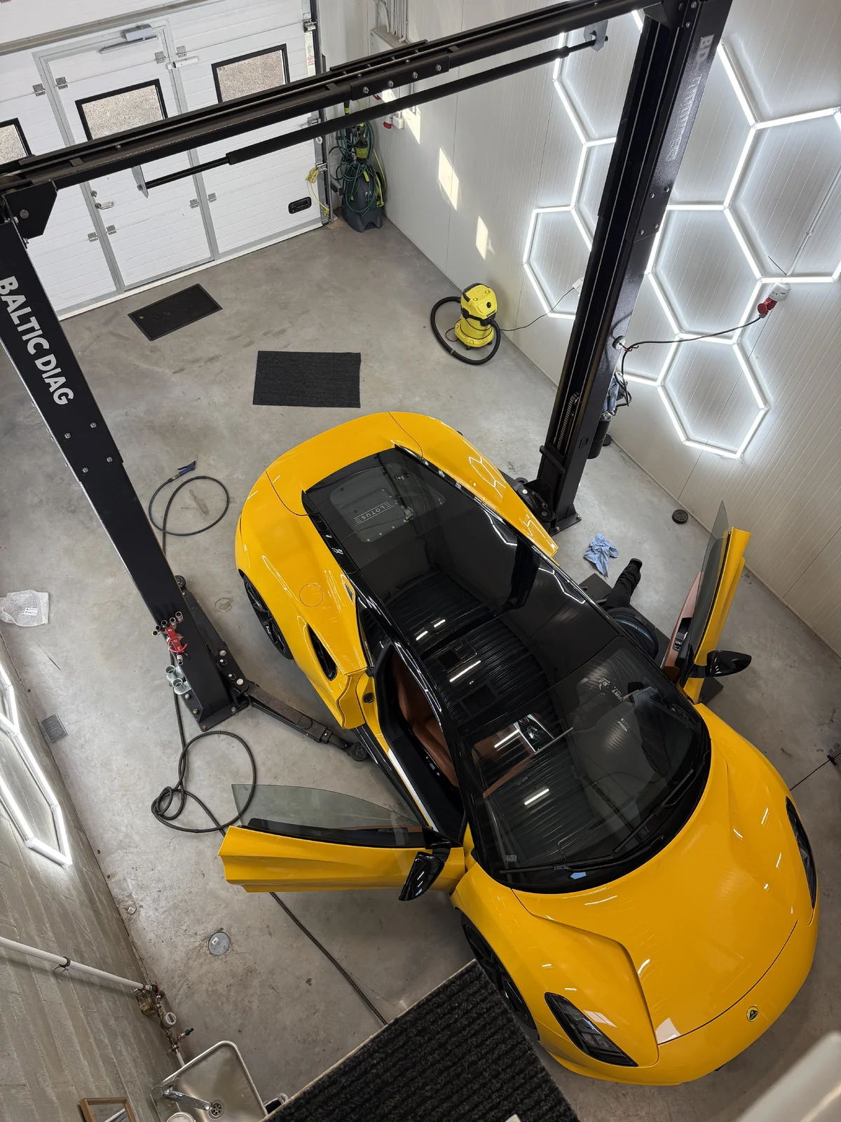

Removed today the seats again. There are some electronics under which cannot be removed because of the angle that the small motors sit there. There are three options to improve position and ergonomics without changing the seats I believe:
a) fabricate a thinner version of the rails under the seats. It’s not an easy task. That would place the seats a few centimetres lower.
b) re-fabricate the cushioning. I’m going this route. We fixed so far the “lower back pain” and next we will work on the seat height, and legs positions as much as it’s possible.
c) remove all electronics and create new rails. Potentially an option to lower the height but it won’t fix the ergonomics otherwise.
So option b it is for myself at the moment. Will repost if the results in a couple of weeks. The cost is about 400€ here where I live.
PS. I’m 1.86 cm shorter guys might have less issues with the seats in general.
