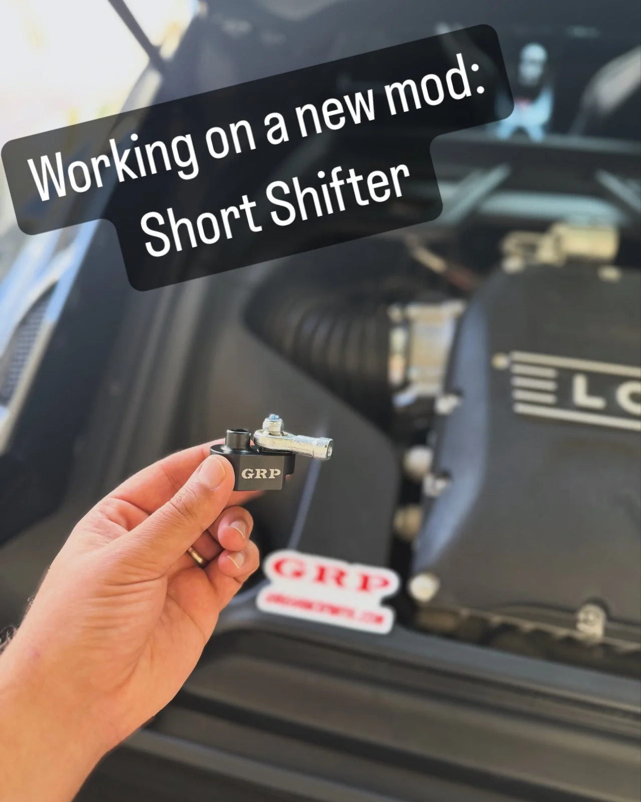

Ever since I got the Emira, one of my peeves has been with the shifter feel. I had previously test-driven the press vehicles that Lotus brought over and toured through the country, and I do recall the press cars also feeling as if they just slightly missed the mark. Though I brushed it off at the time, thinking that it was probably due to the fact that so many people test drive those cars, and were probably woefully used by folks that weren’t all that great at driving manuals. Coming from a highly modified supercharged Exige with one of the best shifter kits and adjustable cables that money can buy for the platform, my Emira simply felt lacking; especially for such an expensive new car.

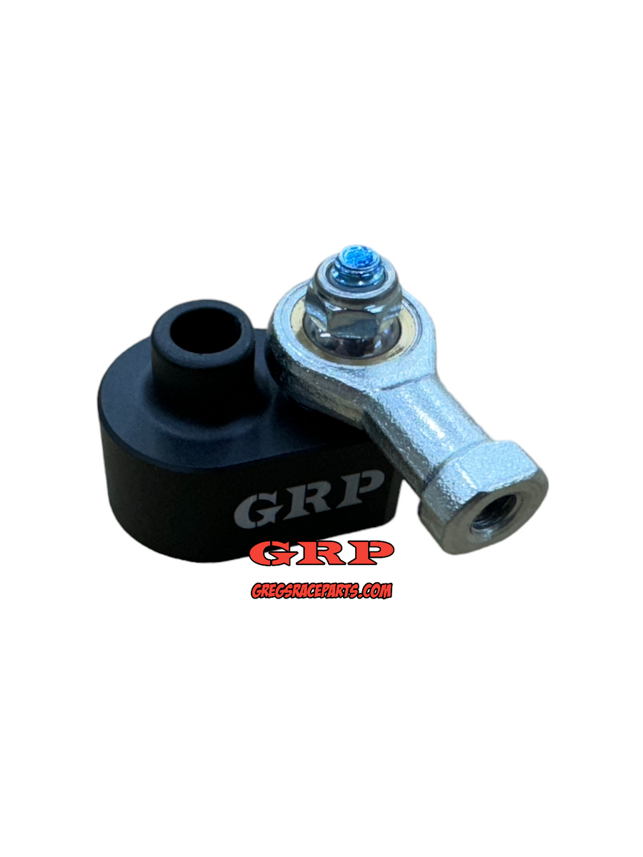

So I decided to give the GRP short throw shifter kit a try. I just finished installing it myself in my own garage with minimal tools. Took me about 45 minutes or so, and I immediately went out for a test drive thereafter. For about $100, this little reinforcement device not only reduced the shifter throw, but also helped improve the directness of shifts into each gate. It now feels closer to that of a Honda S2K for those that have driven those before. Their shifter feel is like a benchmark among enthusiast sports cars, and there are often attempts to mimick the feel of the S2K shifter.
According to GRP website description for the product, this kit can shorten the shifter throw by between 45% and 60%. I left it at the 45% adjustment mark and feel like it's perfect for me. For those that are on the fence, I highly recommend getting a kit through GRP!

Just installed mine.... have some pearls to share....
1. Definitely remove the air hose... idk how some one can work with that in the way....
2. Put a little shop towel under neath the area.... that way. If you drop any thing....it's caught ...

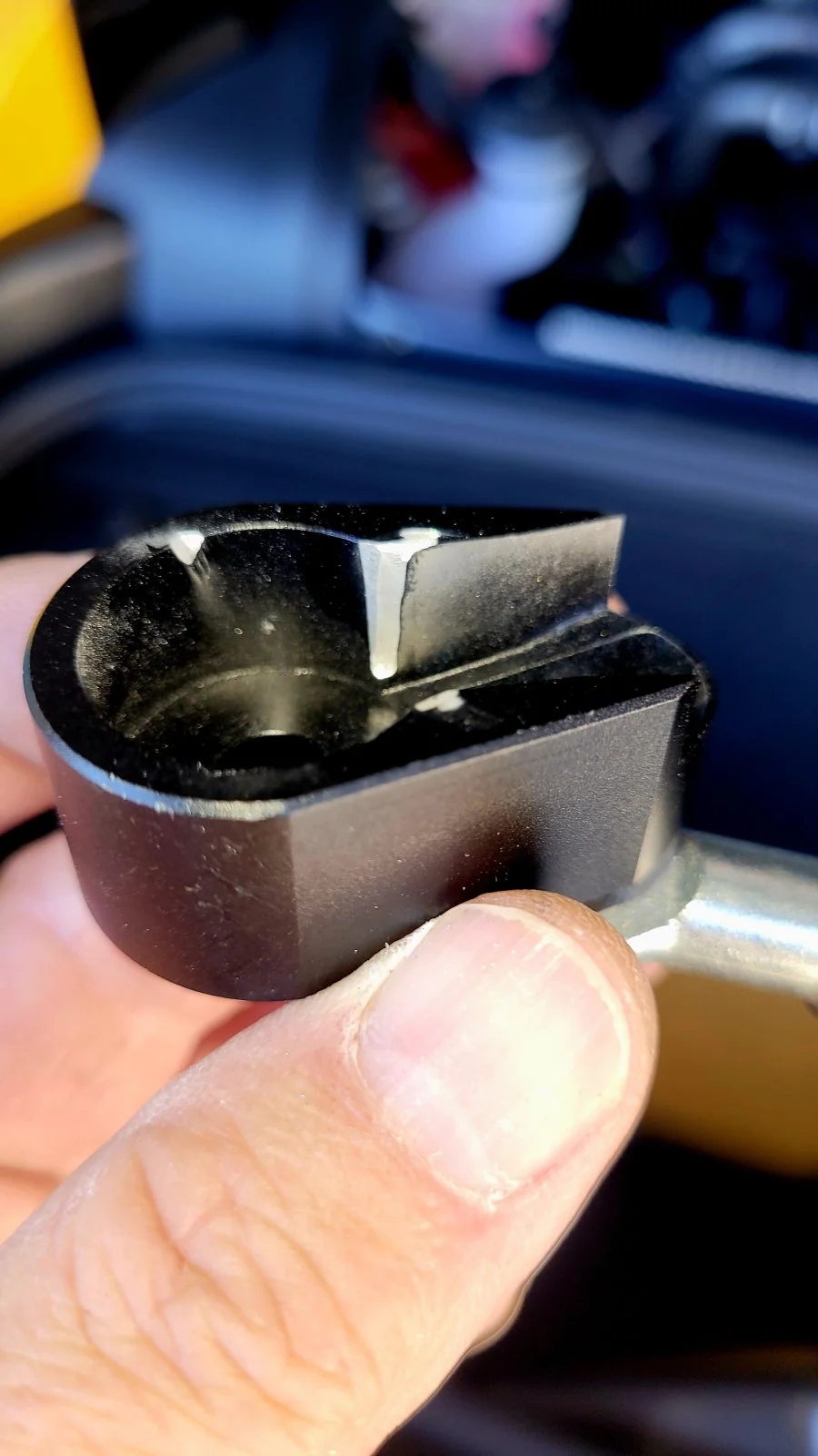

3. My grp unit was kinda tight n I could not shove it down n I saw the point/anodized what ever that was scraping off from my attemp to shove it down so.... had to Dremel it a bit to let it seat itself...
4. I put some painters tape on my arm to keep from getting cut by the plastic stuff in the way.... ( yah,yah.... lol)
5. About to go test drive but.... the throw distance was about 3.5" at 1 n 2 gears & after install at the stock/ 45% setting, it's about 2" throw.... more than enough for me .... btw, there is no change in the lateral travel distance , neutral row, that I can tell.... maybe I'm wrong but ?

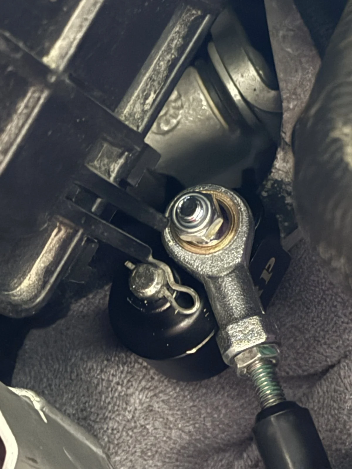

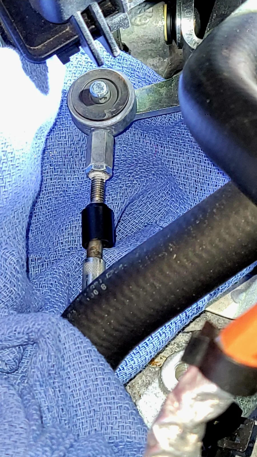

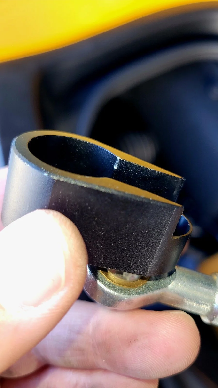

Here's some picturesView attachment 54895View attachment 54896View attachment 54897View attachment 54898

1. Shift into 1st gear to give you more room to reach the unit. All the play in the cable, what gear, etc doesn't affect the install. When it's all tightened up it will be pulled into the right position. I needlessly worried about that.
2. Instead of taking the pin out first and then separating the nut from the end link, loosen the nut from the end link first while it is still attached. This is MUCH easier and actually the hardest part of the install if trying to separate the nut while the unit is flopping about. After you loosen the nut, then you pull the pin and separate the existing unit. Opposite for install.
3. IMHO, the length of the cable/end link unit AND the Reverse Plate adjustment that KitKat posted affect how smooth the shifting action is in 1-2 and R. It should be smooth and open, not blocked and requiring multiple shifts to get in. The first end link I got did not screw into the cable as far as my OEM unit and introduced some shifting resistance I didn't have before. I got a replacement end link that screwed on all the way and it was gone. I think this is why these mechanism exist. Each gearbox will be slightly different in terms of the cable lengths and that Reverse Plate allows you to adjust for any variation to achieve clean and open shifting gates. I believe the overall length of the cable to the shift pivot point impact this.
Last, I would experiment with a shorter setting that you might have planned for. I was surprised how much I liked the GRP shifted at the most extreme short setting. I ended up backing off from the shortest setting just a bit and it's perfect for me. Once installed, it's super easy to adjust the bolt that changes the length.
