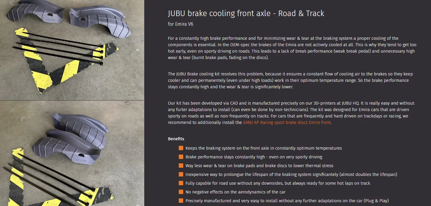

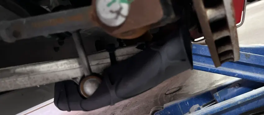

Just from my experience, blanket brake cooling isn't always the answer.
It's best to assess your braking sustained temps and operational window to determine if cooling is needed.
Although these air scoops may be less forceful, I went through a period of cracking rotors when I was ducted (race car, not emira) without noticeable benefits. I didn't experience fade or inconsistent braking prior. I actually got more inconsistent braking when I was ducted (suspect temps cooled too much on the straights). Removed the ducts, no more cracking and my pad wear rate was the same, but I could make the rotors last longer.
Everyone in the paddock told me I needed brake cooling, so I just took the advice without a thought. But after real data collection, it was contranian for my driving style, use, and results. YMMV.
Not challenging you or your use case, but just driving the point that we should all assess our setups and let data drive the approach.
