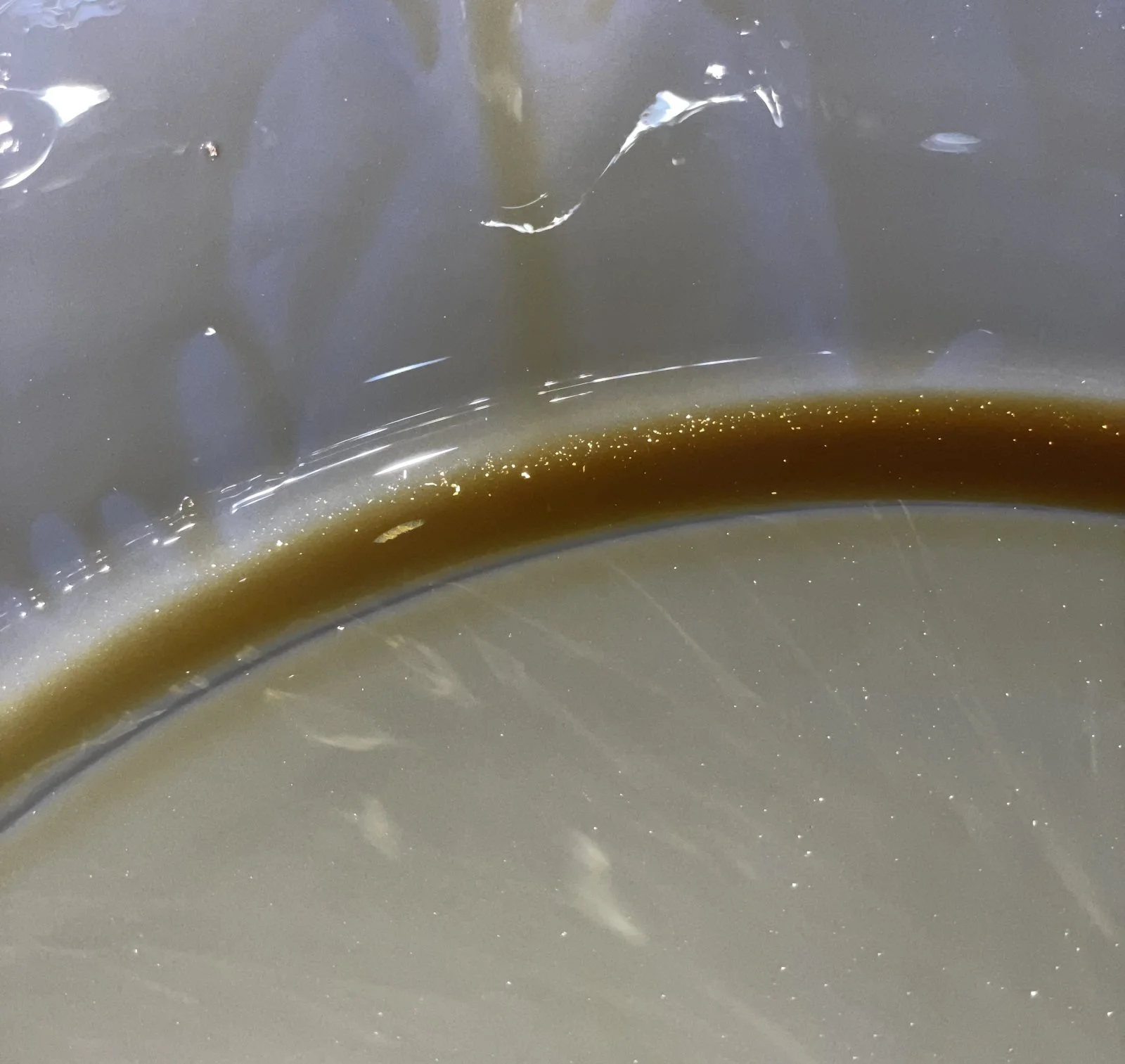

Curious as to why you think there will be metal fragments in the oil, isn't it the job of the filter to remove those, and thus the oil supplied through the pump shouldn't have any metal fragments in it. Or are you saying that the filter doesn't take out all of the metal fragments?
or More directly
That's not from cutting open the oil filter and seeing what is in there. Particles of stuff won't end up in the filter unless they got picked up by the oil pump, that doesn't mean it's not sitting at the bottom of the pan and coaxed out through draining.
img_3378-jpeg.48456
