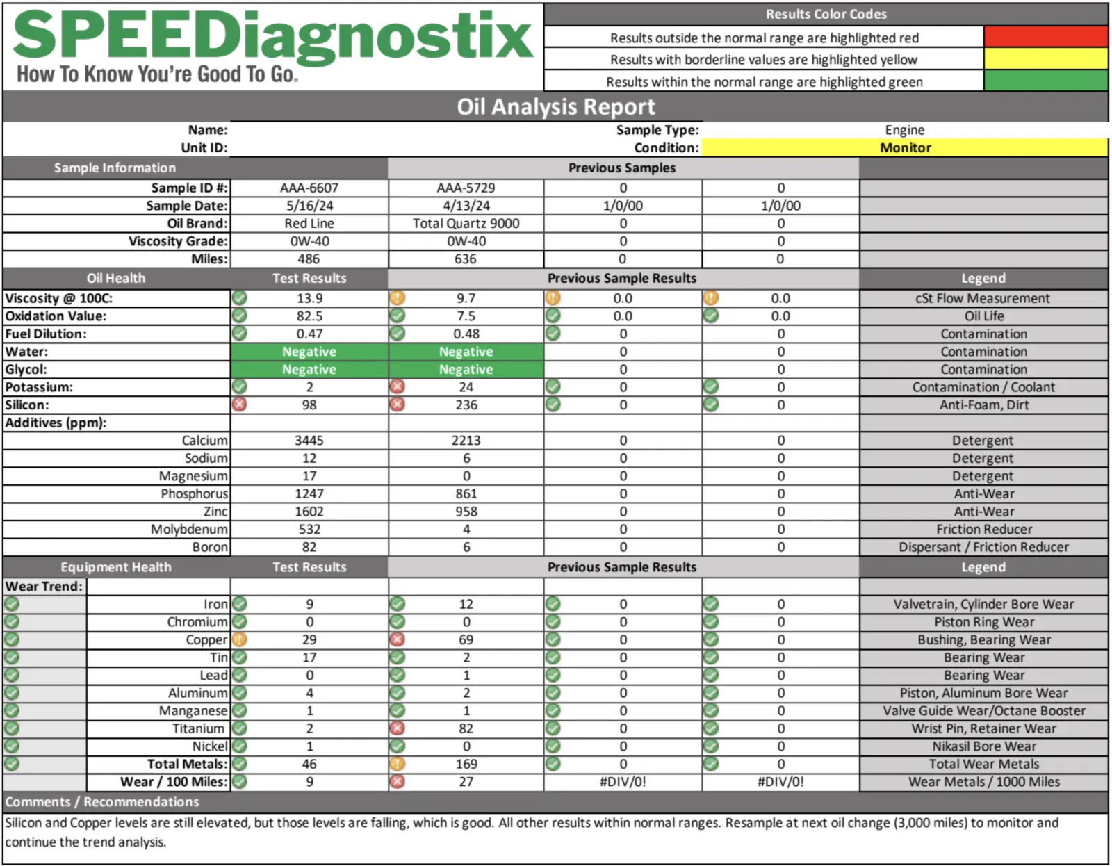

It's not something I "think", it's a fact, and it showed up on the initial lab analysis on the oil I took out at 800 miles.
This happens on all new engines, mostly as a byproduct of the bearings wearing in. Much of the suspended metal is genuinely microscopic at a scale that bypasses the filtration medium.
I'll edit this post and add a copy of my oil analysis report in a short while.
Here's mine. First oil change at 636 miles, second one at 1122 (aiming for 500, 1000,3000 then every 3000) You can see wear metals were higher in the first sample and still present but reduced in the second sample.
