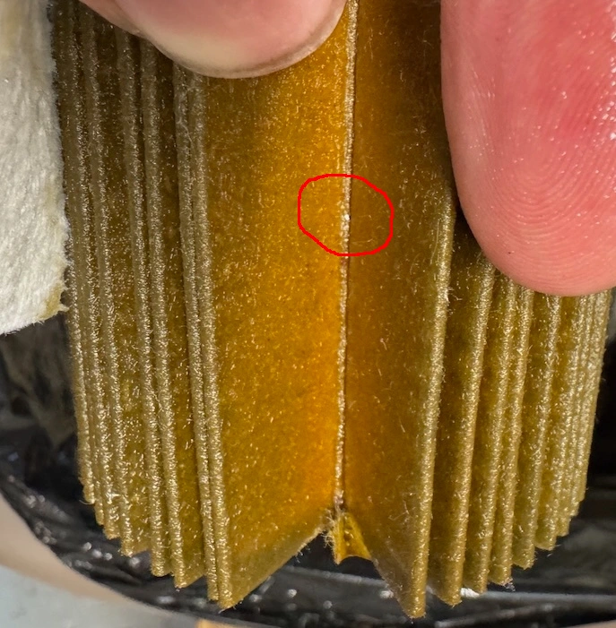

Is this just the manufacturing debris being worked out, or is this a problem? Sending a sample to blackstone, but thought I'd ask here as well.
Found a small number of metal flakes (~6-8) in the pleats - picture below has one circled in red. The lighting is tricky - none of the other shiny things are
metal, just wet oil reflecting. Car has 440 miles...

Yes on a brand new engine that's normal. That's the wear-in particulate, and demonstrates why it's a great idea to change the oil and filter after the first 500-1000 miles. The filter only catches some of it.

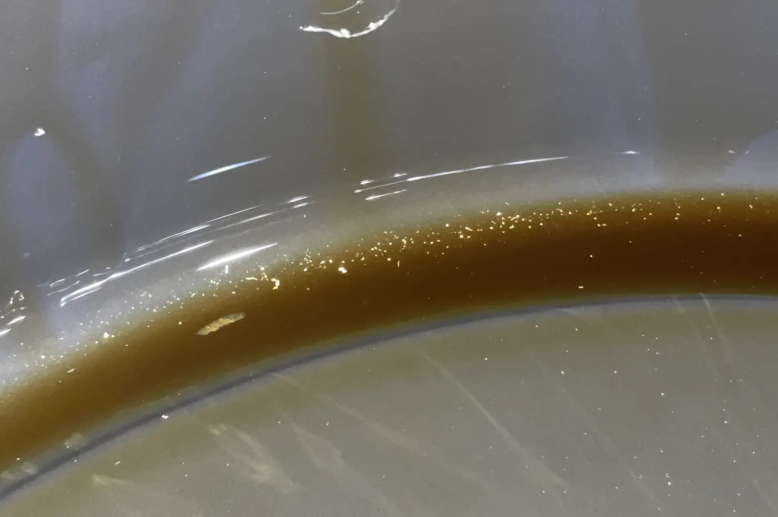

Here's a picture of what was in the oil drain pan when I did mine right after the break-in period. Those flecks aren't gold.
Looks like my first oil change at 1600 miles.
I purchased my car used with 1500 miles and bought it from an exotic car reseller.
Will probably change the oil again at three or 4000 miles and compare.
I would assume there would be a lot less shimmer in my oil this time
Normal. I wouldn’t inspect the filter or submit for oil analysis until you’re pretty well broken in.
