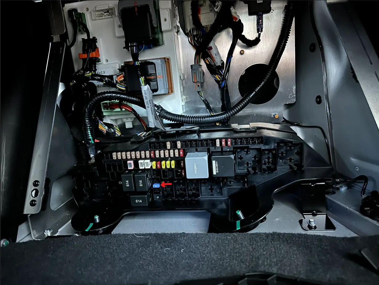

On the power, no, I am looking for an ignition-on hard wire point.
I'll probably find in the fuse block eventually. All my cars have hard wired detectors w/remotes....all w/concealed wiring.

In the passenger-side footwell is a panel that covers the fuse box. 4 plastic 1/4 turn fasteners, and then you have to wrestle a bit with the panel to get it out. Getting it back in properly is even harder - the bottom of it hooks into place in a channel that you can't see in the pic below because the edge of the carpet is blocking the view.
The blue 15A fuse is for the power adapter behind the center arm rest and will probably serve your needs. The fuse directly below it (not pictured - I had removed it) is for the USB outlet in the mirror housing. Both are ignition-on that you could just put an add-a-fuse in.
