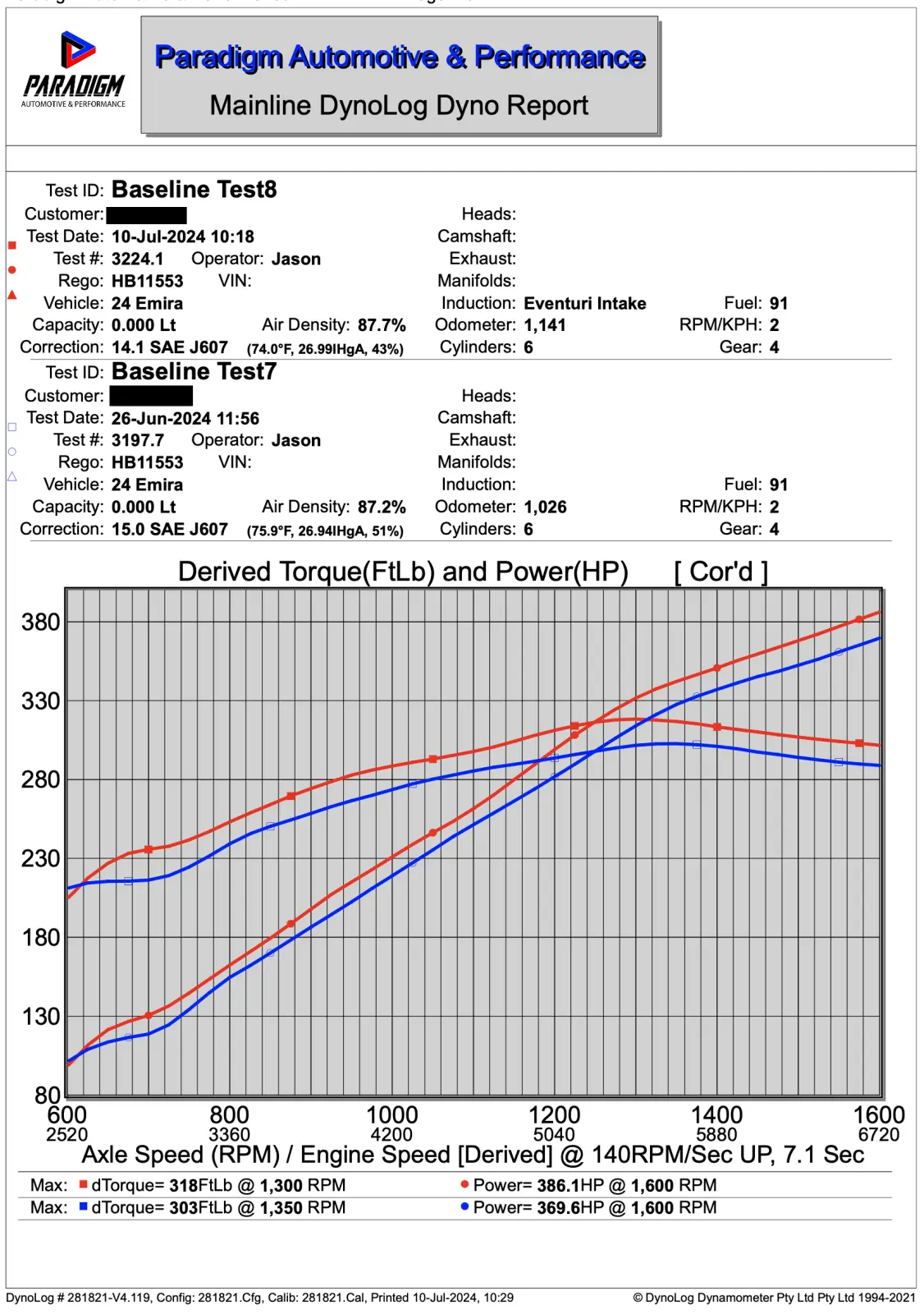

Unless proven on a Dyno I doubt any increases. Sound wise sure.
True, but EVenturi have provided dyno numbers showing small gains. I also eagerly await third party results, but I doubt a company with the history and reputation of Eventuri would fake the results knowing they will be, sooner or later, exposed.

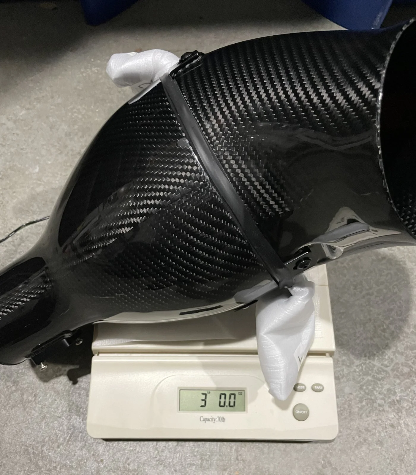

This is a very nice item. Beautiful and well made. Everything about it says "quality".
The main unit with the filter inside weighs 3 lbs.
All the other items including the silicone connector tube (a very solid piece) and the brackets, bolts and nuts, etc. weigh 1 lb 8 oz., so altogether this whole setup weighs 4 lbs, 8 oz; 4 1/2 lbs. I'll weigh the factory setup once I get it off the car.

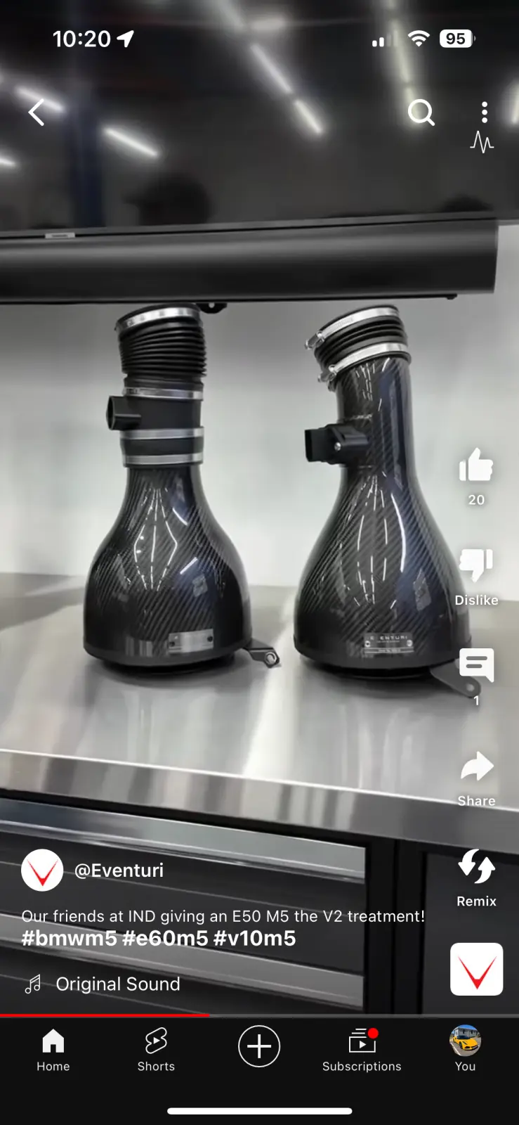

Maybe it’s so they can come up with a “V2” later like their M5 intake 🫤

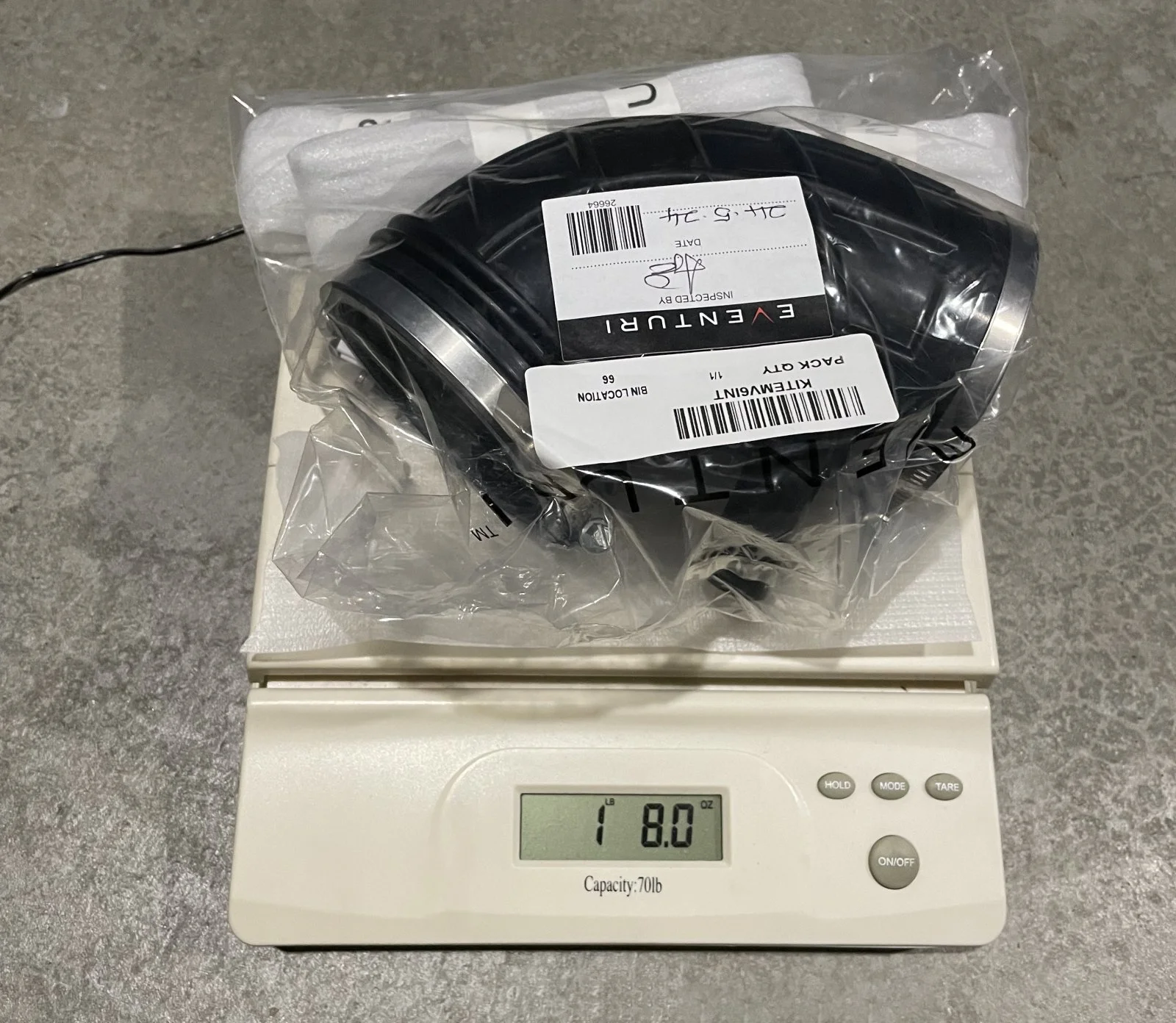

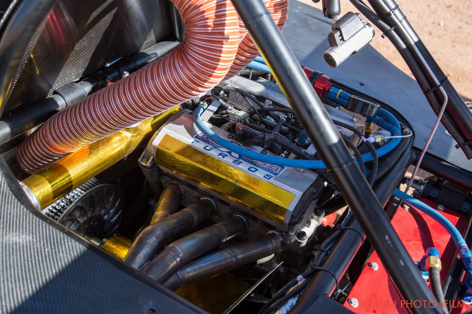

Yeah I know. I'm thinking I might get some gold heat reflect foil, and put that around the connector hose which would look pretty exotic. At least it would be visible from the outside of the car.
That stuff is Pikes Peak International Hill Climb tested and approved! I had it all over my race car since heat soak up there in that thin air is a major issue.
Yeah... we're going to need more info on this Pikes Peak race car...

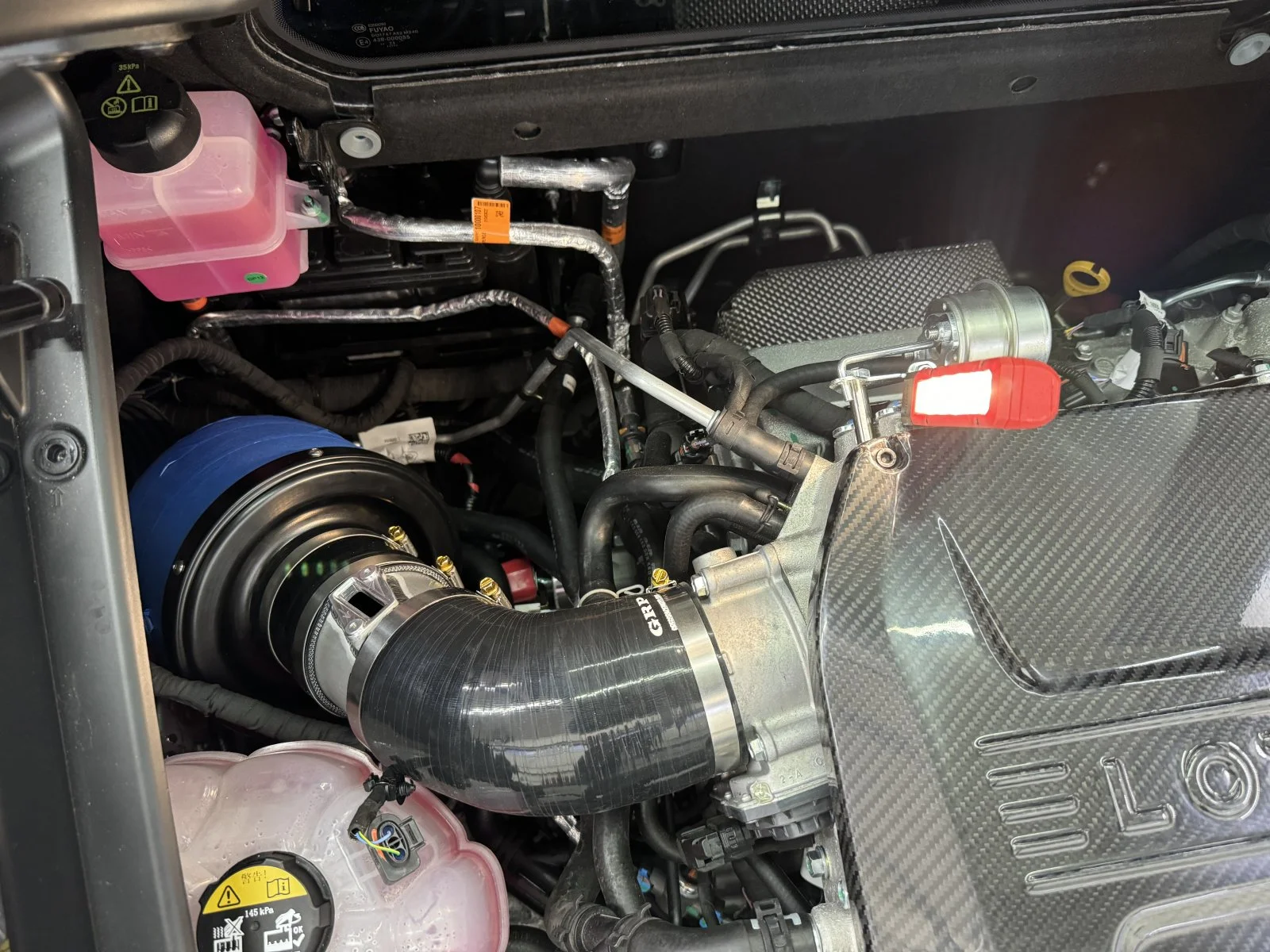

Our intake is coming along and being road tested currently. Initial impressions are all good so far, nice induction sound and better throttle response.
Hoping to do our intake shootout in the next couple of weeks with the stock filter/airbox, drop in K&N, Dryflow drop in, our intake kit and the Eventuri.
We did put 1400+ miles on the Eventuri intake kit last week and had no issues with it. Car ran well in varying conditions and the intake/exhaust sound through the redwoods was pretty killer!
