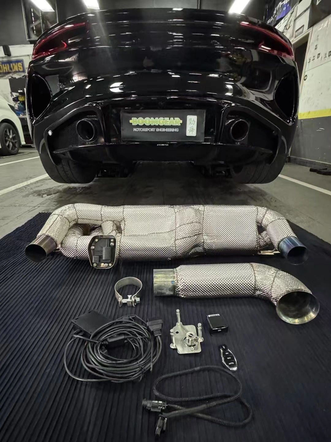

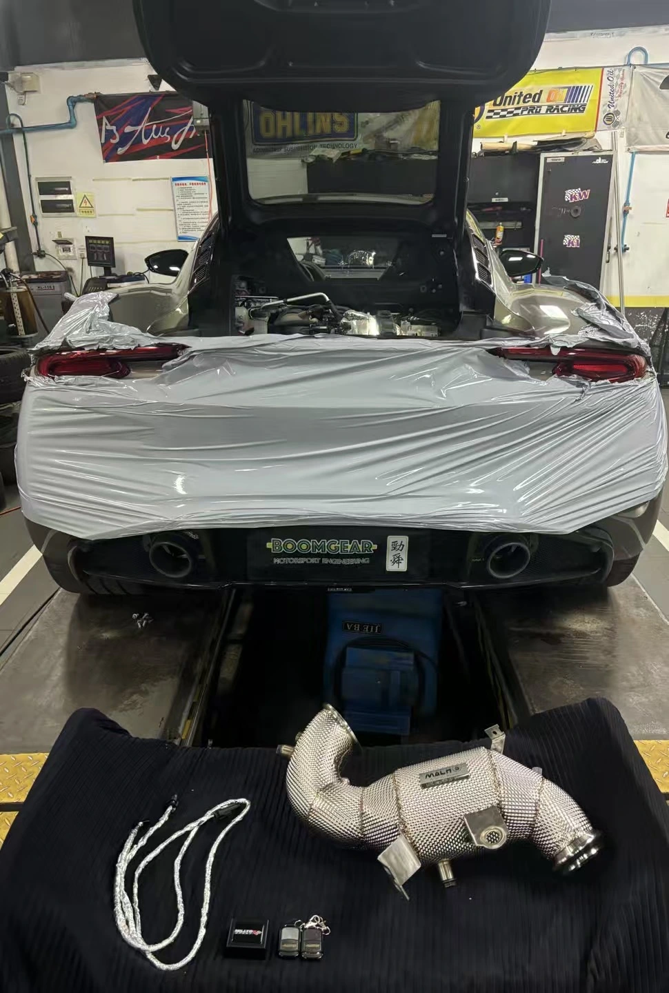

Emira I4
Full exhaust system (Down-pipe without GPF, mid-pipe, and rear exhaust) with OBD active value control. No warning light.
Those shiftings are amazing!
What's the setup of the car to reach those 0-100 numbers?
How did you manage to disable the OPF/GPF on the ECU?
@675430VME very nice exhaust sound. 💪😎
Could you please list all of the parts of your exhaust system. Thank you.
Mach5 200 cat downpipe without GPF, Boomgear titanium full exhaust system with heat protection and upgraded value unit plus OBD active value control.

Beautiful wrap on that car. Too bad there is no before and after Dyno.
